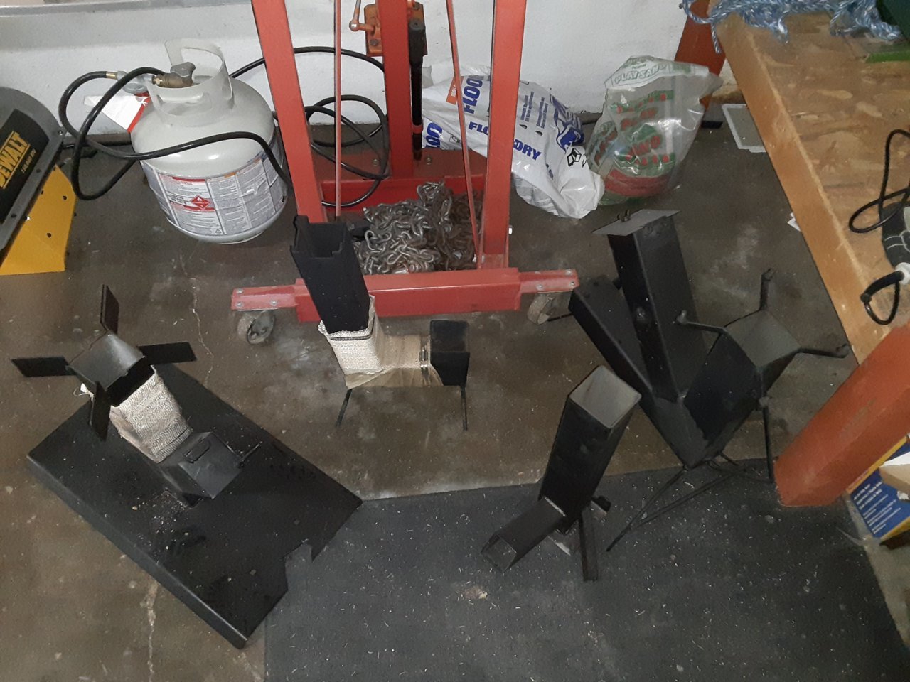

    20210226_191508.jpg Built a few variations of the rocket stove this winter while the shop was slow. I'm looking forward to testing them all out. Anyone else into these?

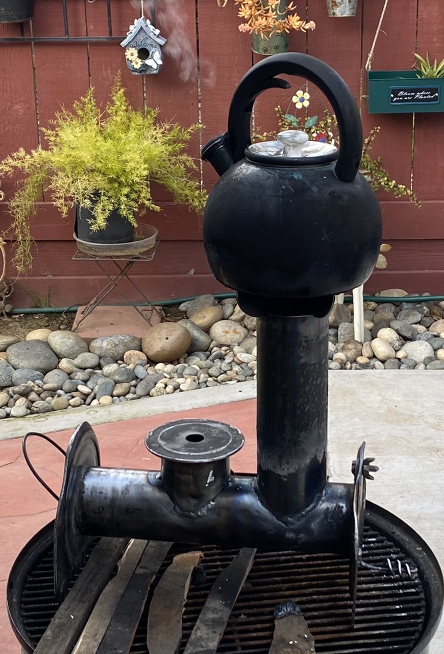

    Old thread, but needs reviving.

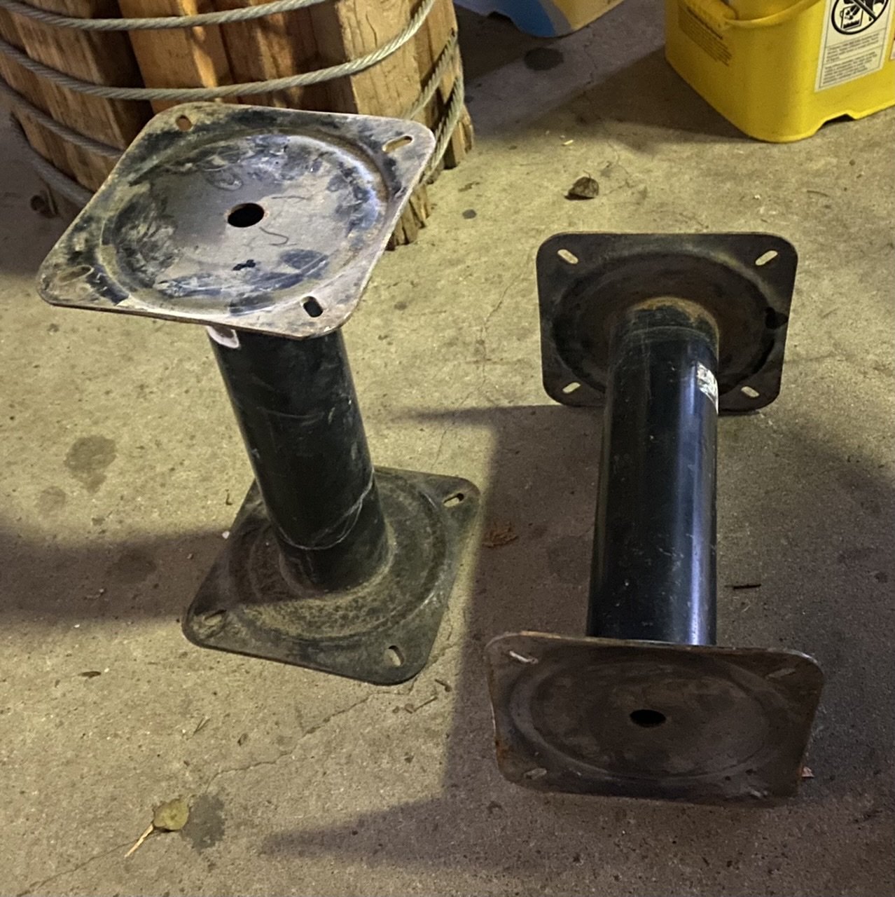

    I built this rock at stove from a pair of old boat seat pedestals.
    The air door also serves as the clean out door and it has a removable shaker grate that runs the full length.
    It has a pot stove on the chimney and a warming plate to keep your coffee cup hot.
    This photo was taken before I welded the handle on to the shaker grate.

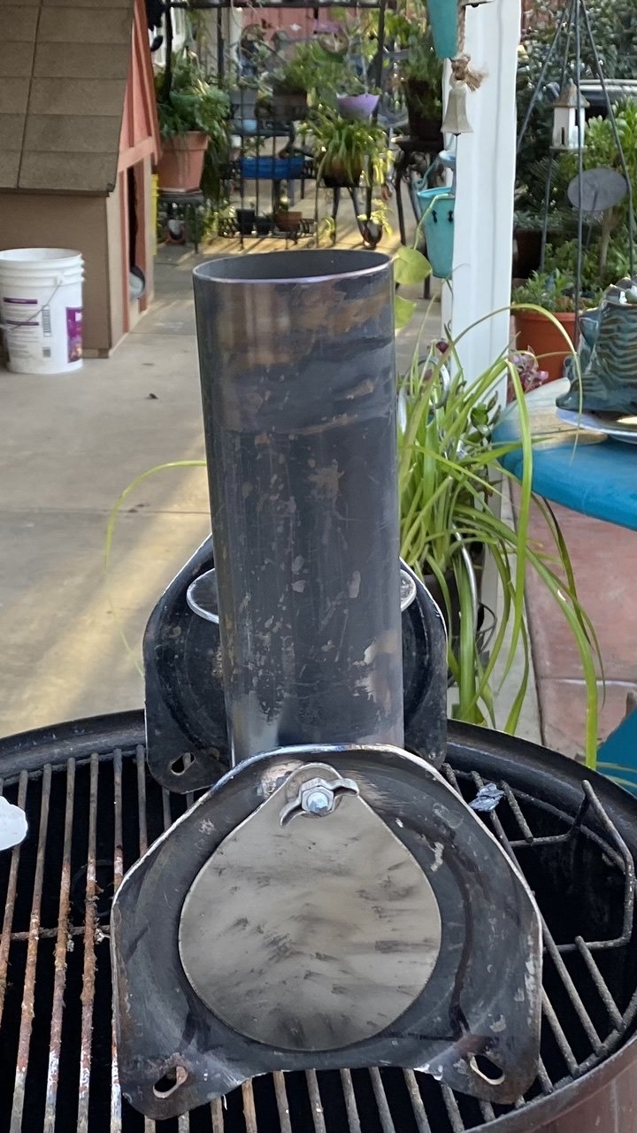

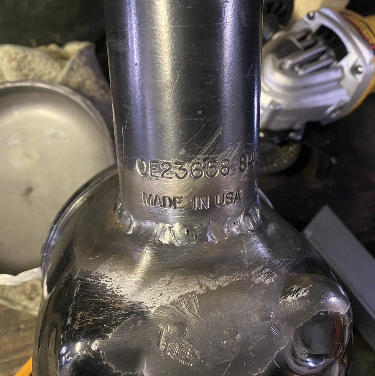

    I built this one from the shock absorber off an old Silverado, and the case of a small chinese refrigeration compressor.

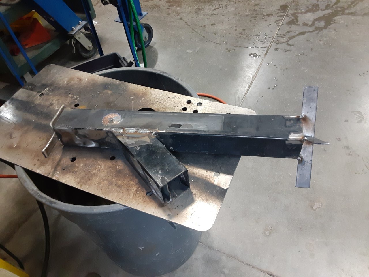

    I built this one as a project to learn how to weld
