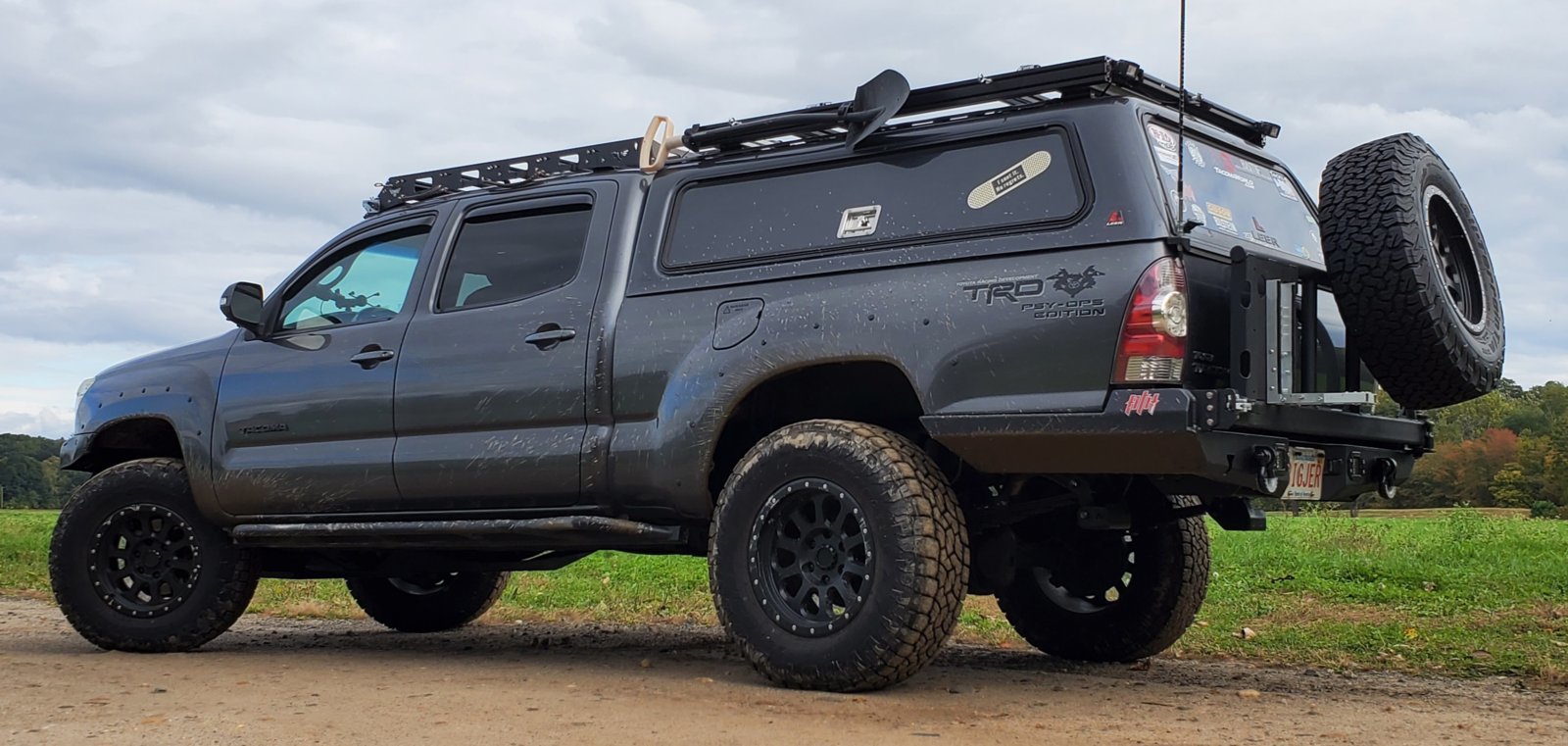

    I have always loved my Rocktrix. When I purchased mine from the company directly, the wheels were so new they told me I was the 4th tacoma to have them on. I paid $119 each with free shipping. 5 of them were $700 shipped to my door. I still love them to this day.

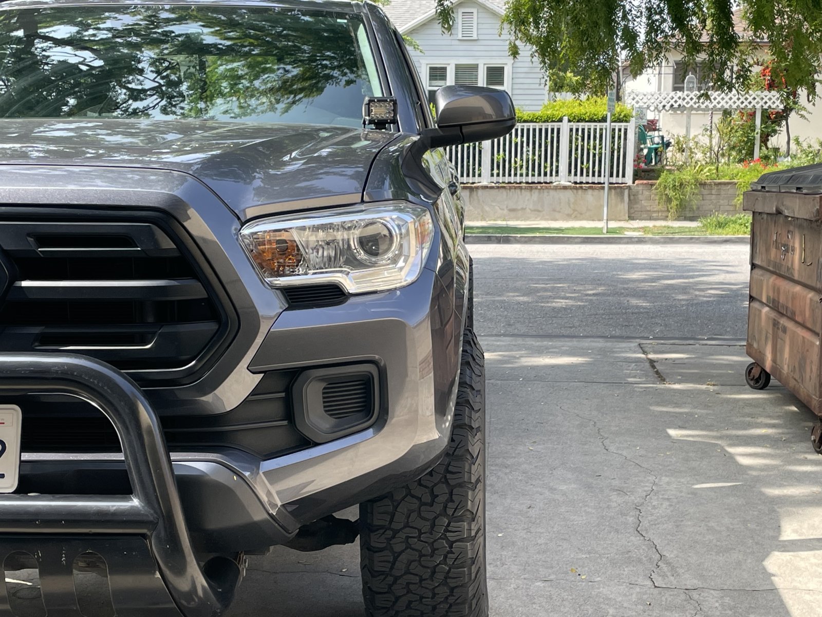

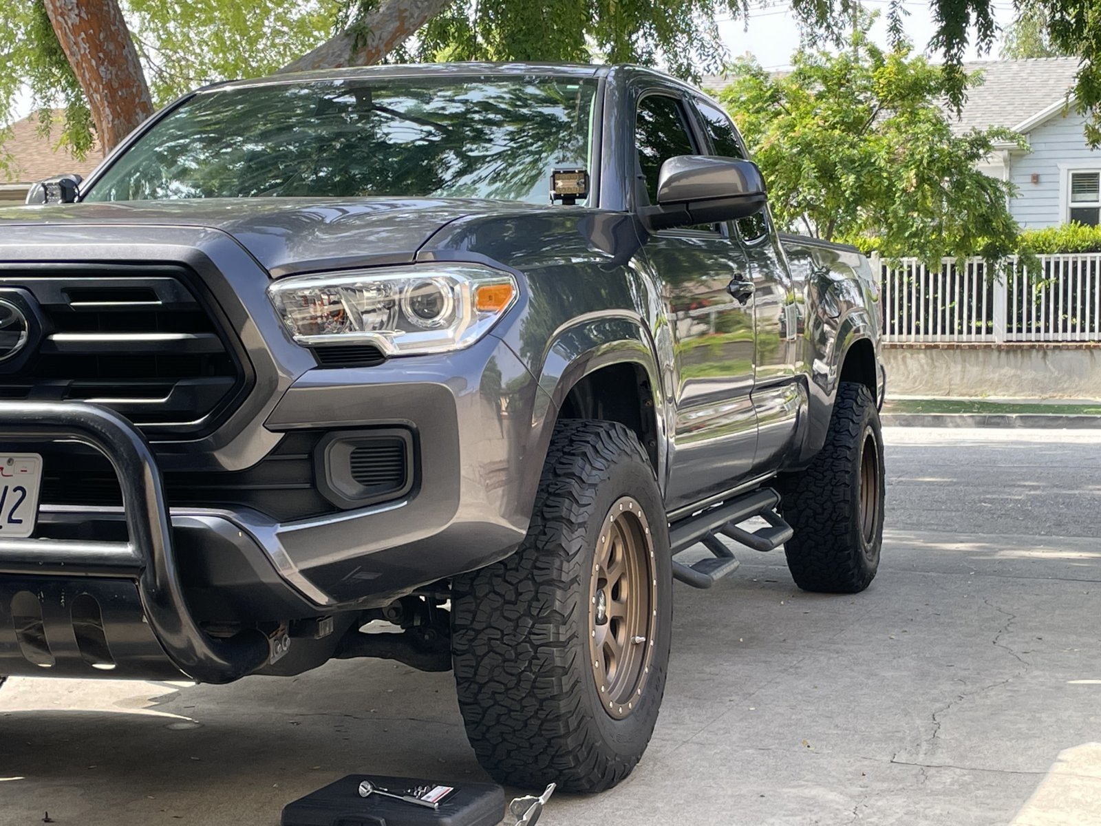

    Glad the Toyota TPMS sensors fit just fine! These look great on your truck and love the poke! Thanks for sharing on here!

    Thank you! Yes, I go off roading a lot with my rig, almost 3 weekends a month. Even though they have rock rash, my Rocktrix wheels have been the model of reliability. I have recommended to everyone I see. I even tried to get my trucks picture put up on your website a number of years ago when I first got them and I was never able to get in contact with the website or social media team. It is great now that there is a presence from someone who works with Rocktrix. Do you guys do an affiliate program?

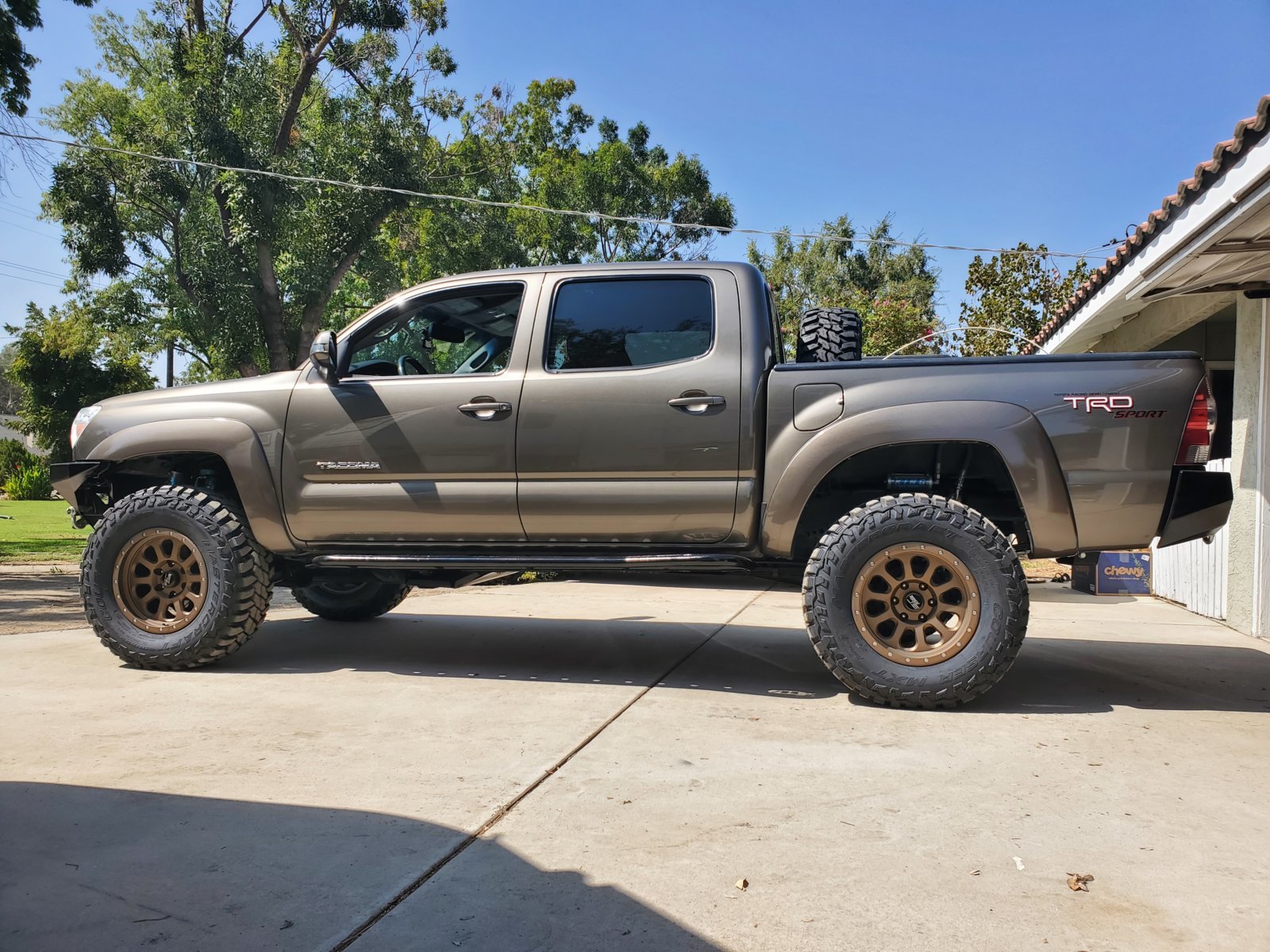

    hey boss sick truck you still got those rims on? i just ordered a set. what size tires and lift you running?
    RockTrixWheels and Mully[QUOTED] like this.
  10. Jul 8, 2024 at 7:28 PM
    #30
    Mully
    Mully Well-Known Member
    Feb 12, 2014
    #122907
    5,269
    CA
    12 DC 4x4 Lifted Sport

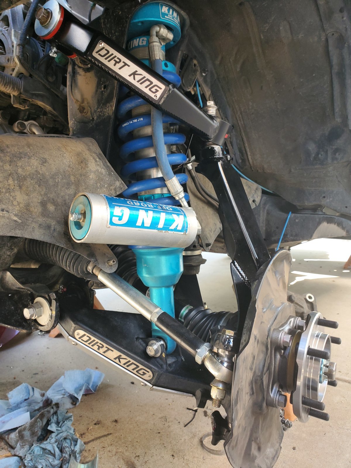

    Lifted, Kings, Locked, 295s and more.
    295x70x17
    Kings set at 2 1/2 front and 3" expedition springs for the rear.
    Got a lot more underneath.
    BAMF hangers, x-brace, Marlin Crawler HD braces, gusseted spindles, ARB lockers, fully equipped with skids and more.

    Yes, it will pull the tire away from the control arms but it will also then hit the can mount at full chock as well as the inner wheel pinch weld. 265/70/17 in a 32" (which the rocktrix will still fit with the 9" rim btw) is the biggest you will be able to go both on road and offroad without any further modifications. As soon as you go up to a 285 and bigger (295 like in @Mully 's case) you will need to do a cab mount chop, fold the pinch weld, and get a caster that is bigger than 3.
