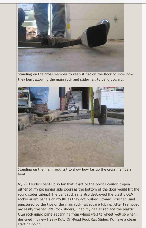

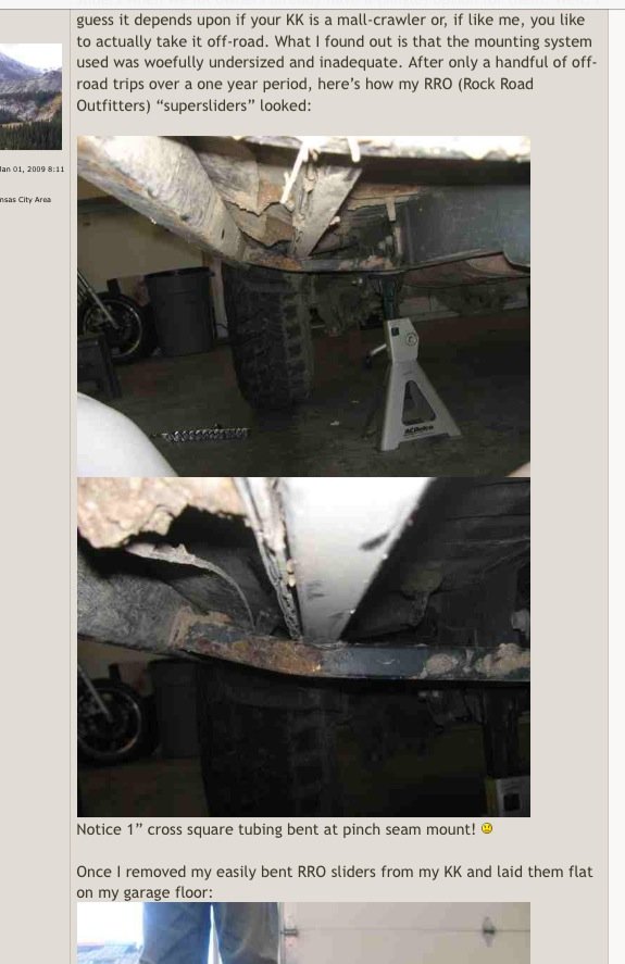

    OP, I would highly recommend going with another company... If you've ever seen video of a tacoma with a go pro mounted to the frame or bed, you can see how much cab movement there is even with pavement driving. Imagine the weight of the cab pulling on the mounting points over a long period of time--something will eventually give. That style of mounting ONLY works with unibody vehicles.
    The 1x1 supports aren't nearly enough anyway, check out what happened to this guys rro sliders:
    FFC9BE68-AD38-4324-B04C-F5A27256219B_zps_7dcc3f88fb6eadcdb65a26993b88aa17fcde17cf.jpg
    02D7027E-E338-4DF3-AC73-38B0632DA63C_zps_50e9321e143f017679d6f6ed7c168b9273f57917.jpg
    If they are made that way, they should have at least double the support strength.. These are Jeep Liberty sliders, which are much shorter and have four 2"x1" supports on each side. Haven't had a single issue with them yet (I built these)
