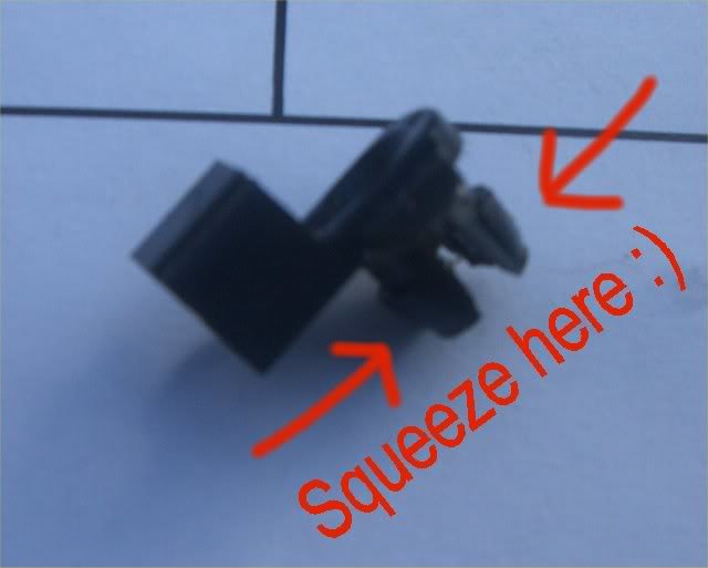

    Hey guys,
    I'm almost ashamed to make this, but I am out of choices so i'm turning to TW! I was in a huge rush to install my pop n lock before I went to work, so I was quickly doing it, without reading the instruction threads on here, and I accidently snapped one of the rod holders. It still fits in the handle, but it's broken, so I am worried it will come out and then I won't be able to open my tailgate... Or get into my bed since I have a tonneau.
    I called the dealership, and those can't be bought without buying the whole handle, which is 200 bucks.
    Help! Please? Any suggestions?

    Thats what it looks like - stole that pic from the installation instruction thread

    I haven't looked at it but it sounds like a keeper for a rod/pivot connection.
    If so, for eons carburetor linkage used this type of keeper.
    Might be able to fit a generic (auto parts store) rod keeper.

    This is going to be hard to do online.
    You might try calling (or email) Pop&Lock and see if they know of a generic part number for that keeper.
    Or take the stuff into your local auto parts house and see if they can match something up.

    Yeah, I did do that. I wen't to Napa and another parts place, neither of which could help me.
    They directed me to a generic door rod clip, but I think it's a long shot.
    I was thinking someone else may have had this issue when installing their pop n lock, and might be able to help? they seem pretty easy to break

    Okay, so oddly enough, after calling 11 dealerships. I found 1 service guy who looked a little deeper for me. He found that the clips could be ordered for a 2008 tacoma. So he said he could order me one. Is there any possible reason that the clips for the 08 wouldn't fit an 11? I thought they were the same door handle... Minus the camera that mine doesn't have anyways?

    Should be the exact same.

    id be willing to bet avweco sells a metal one also. worst case drill out one that has a hole thats too small. wire it if ya hafta

    Yeah, I guess so. I am really hoping the one toyota is gonna get in will fit.

    The part number is "69759 - 20100" SNAP
    Basically just ask for the tailgate rod holder snap off the 2008 tacoma. They'll so you a picture of it. It should be $4.80 ish.

    This clips are very popular the rod is the same size as many many door locks on all makes of cars you could definitely find one walking around a junk yard.
