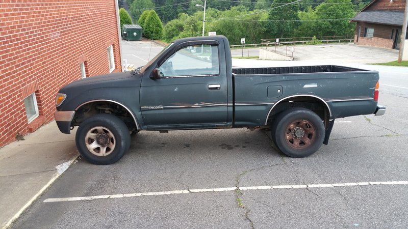

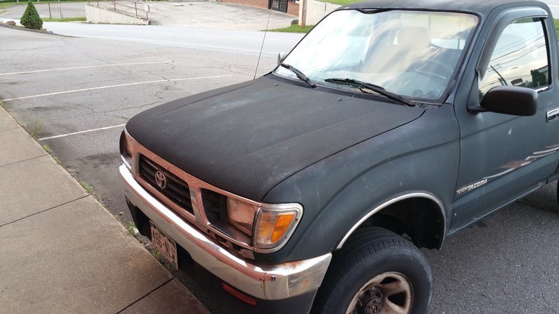

    I'm thinking I'll try to sell it as is at this point. Do you think I can get $1500 out of it. 20170518_070502.jpg 20170518_070512.jpg

    How much to do a rebuild of your existing engine? Good rebuild, and she's good for 200,000 more miles...throw on a paint job, and you're good to go...

    Sure. The thing is I'm long over due to replace it anyway. It's a two seater and I have three young kids that need to be carted places. My fil is upgrading his tundra double cab from an 04 to a new one this summer so I was planning on buying his old one anyway.
    Now I'm just looking for the easiest way to let this tacoma go. I'm assuming a rebuild is going to be in the $1500 range anyway, so rebuild sell for ~$3,000 or just sell as is for $1,500 I net the same. Or are my guesstimates way off?

    That's some high school boys dream right there. That or someone that will replace the engine and make an off-roading beast! I say sell her.

    Someone will want it for a hunting truck if nothing else...

    Shit I got 1000$ if the frame isn't rusted!!!
    That's a cool truck I could see myself rebuild it just to have a extra dirt bike hauler that's always loaded up ready to go, tell you what I'll trade you a Honda Accord :rofl::rofl:
