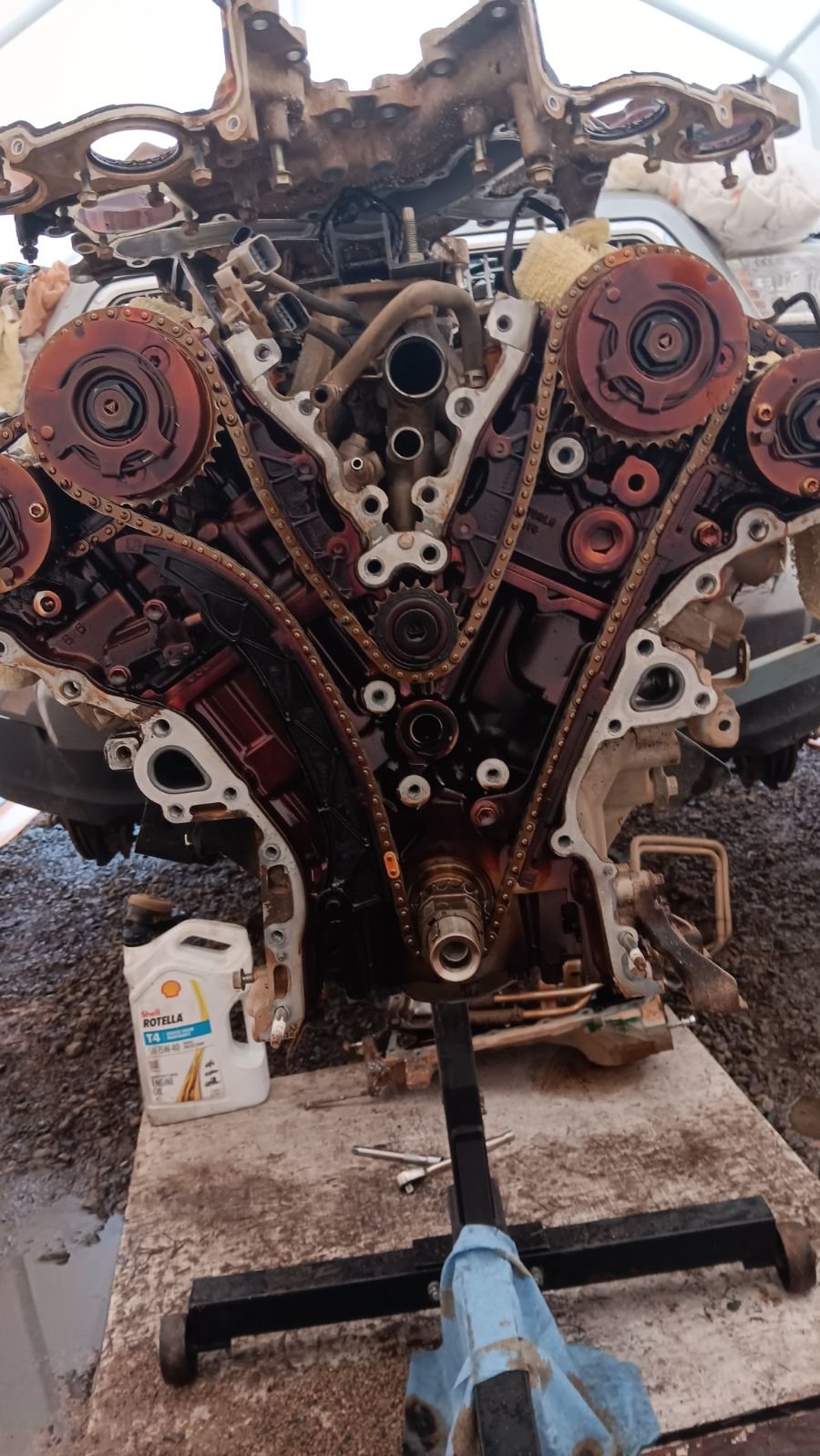

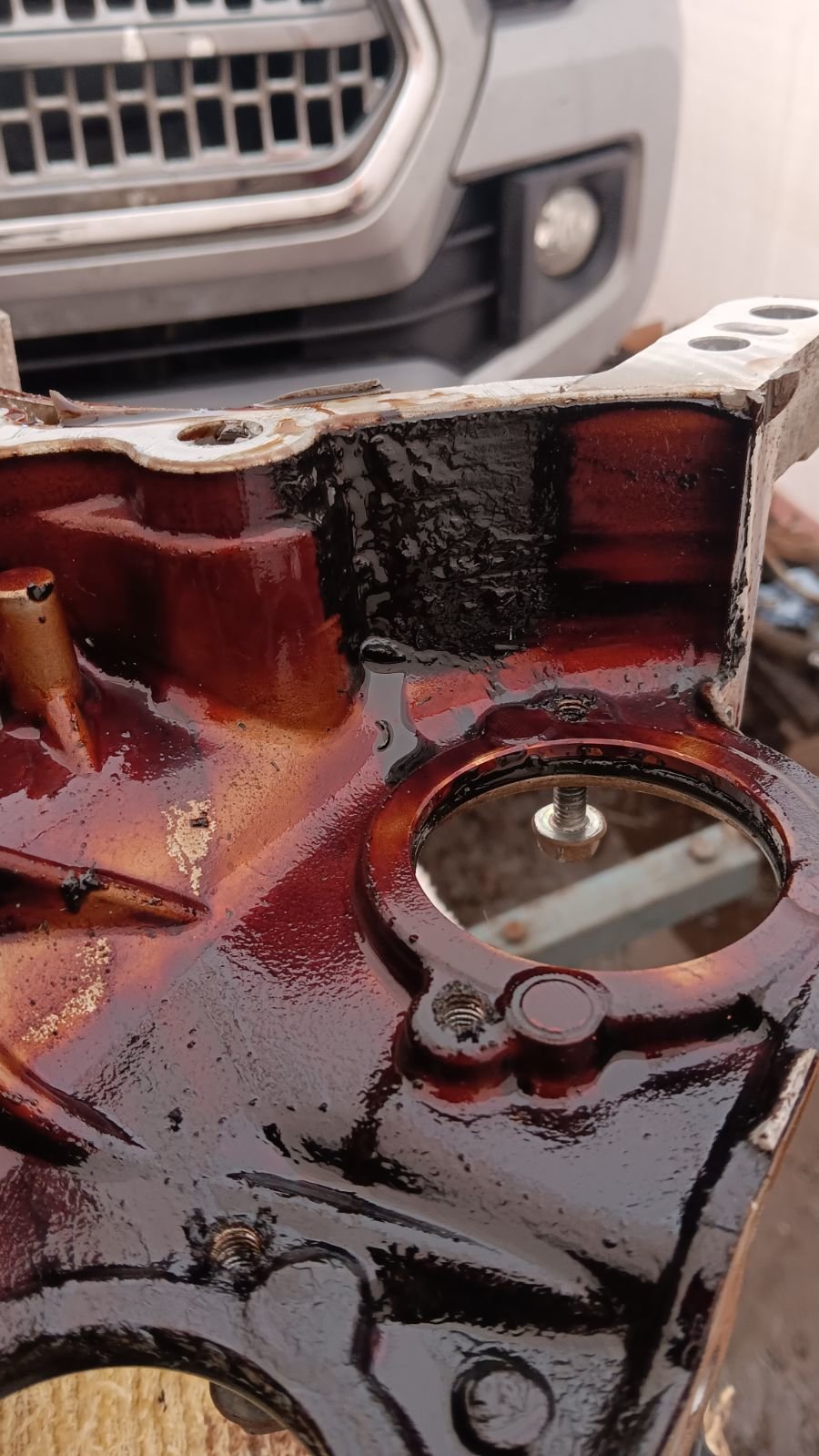

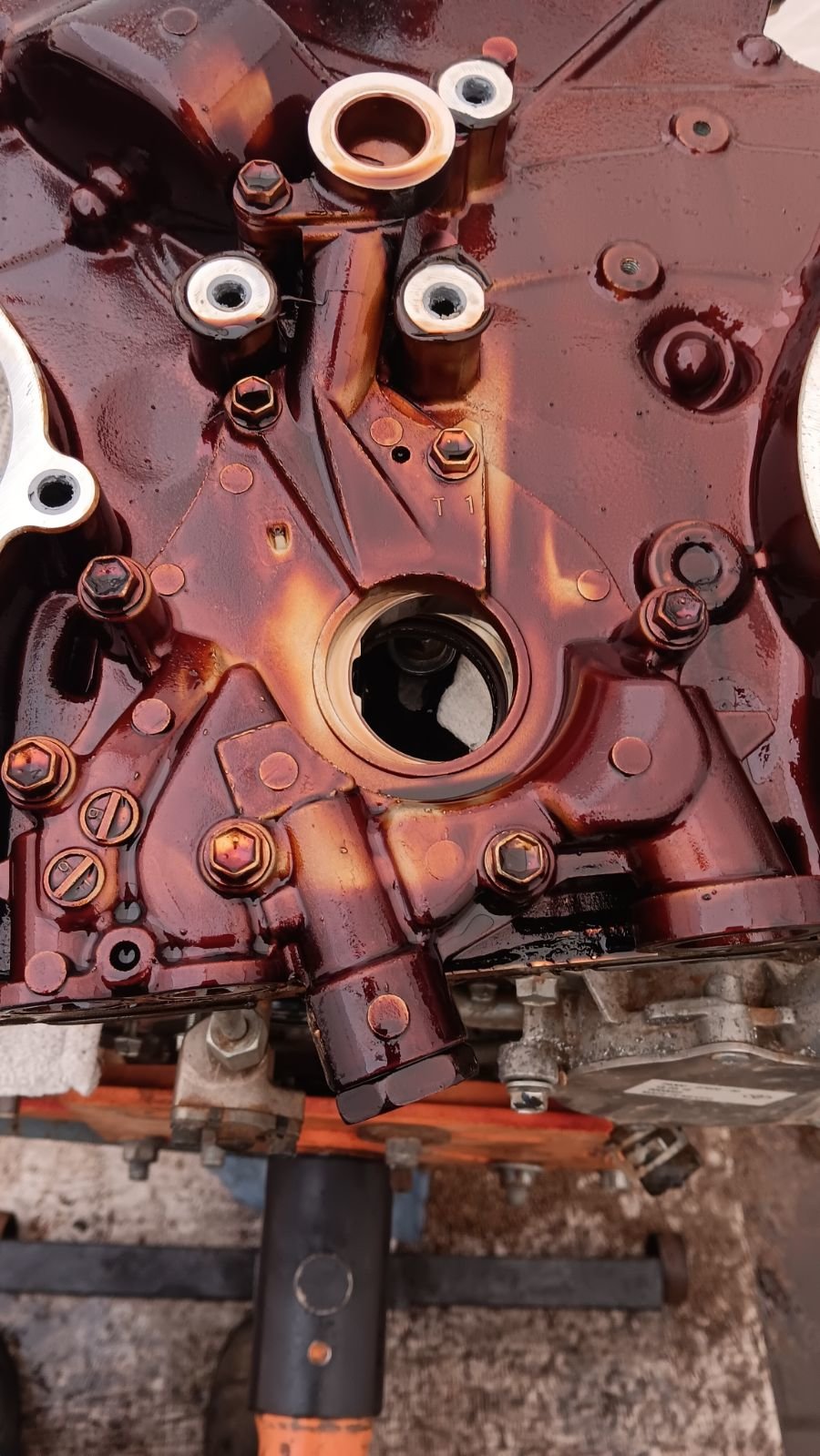

    Okay, here's the timing chain.
    and the cover.
    And the oil pump
    Next we'll get to the crank/bearings. After that I'll loop in the local dealer that did all the oil changes and get their feedback. I want to be able to point to the part that we can prove failed to warrant the tear down before I let them know the story.
    So far I haven't seen any bearing surfaces that are smoked, just sludge everywhere.
    If we pull and clean the heads and check everything, I don't see why it couldn't just be put back together and run, then we'd know what we have.

    Are you sure they actually did the oil changes ?

    Wow, that thing looks baked!

    Well you sit in the truck the whole time. I could hear them draining and refilling, but you can't really get out of the truck and watch to know specifics. I'm not sure what they did every time, but they check air filters, cabin filters and a bunch of other little stuff, rotate the tires, etc. Hard to be specific about each time, it's been 177K miles.

    Are those rubber o-rings on the oil pump? They look cooked.
    LV-TAC and Mully like this.

    That motor got hot .

    Looks like RTV to seal the timing chain cover, not a part of the pump.

    The water temp has never been hot on this rig, even after the rod started making noise <shrugs>, even in the times it's been offroad.
