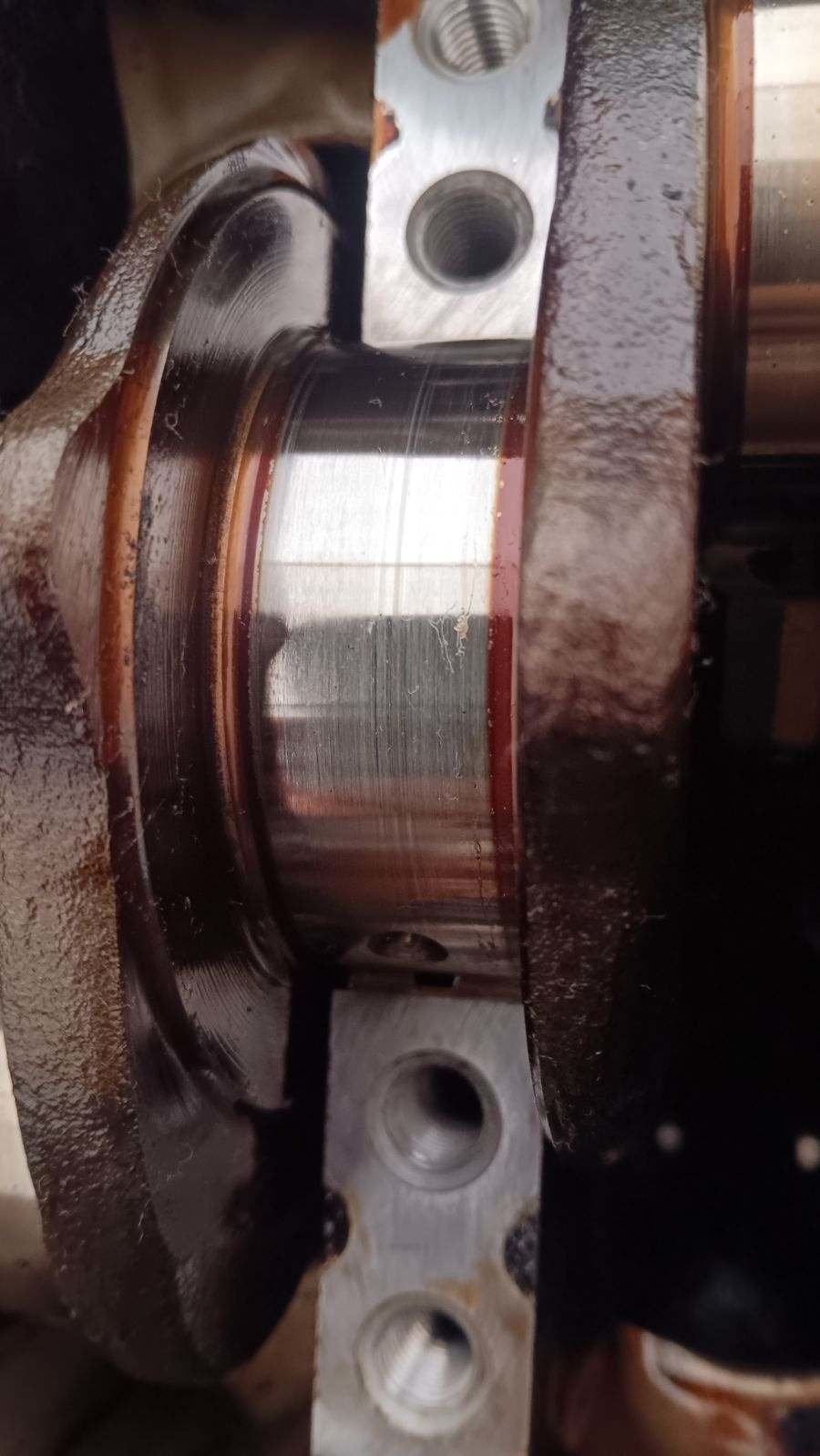

    Wow that's some nasty scoring :eek:. I'm no pro mechanic but I bet that oil jet that is supposed to be spraying on the underside of that piston is completely clogged with sludge. Probably wasn't doing anything.

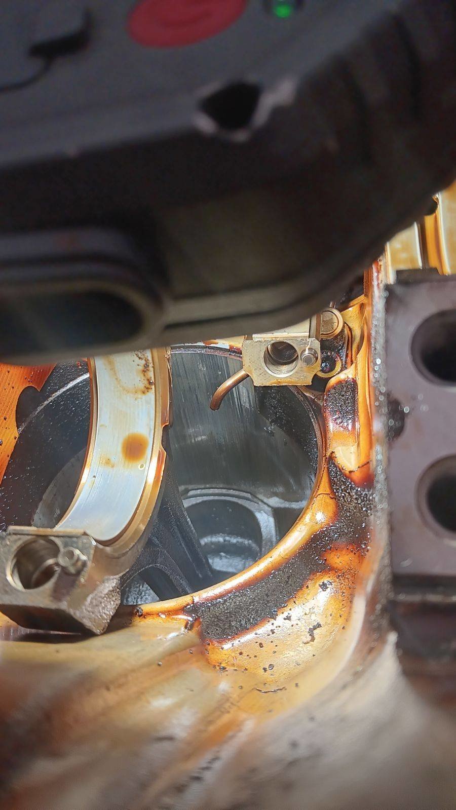

    Okay, here's the filter, it looks old enough to vote.
    Here's the sludge depth.
    I have no idea how old that filter is, or really any way to tell.
    Also, the o-ring seems old and hard, not sure if/when it every got changed.

    a dealer is doing the "sit in the truck and we'll change the oil"? thats not something toyota really encourages LOL
    they may have been changing it. but if you were doing 10k OCI and they were using dirt cheap dino oil instead of full synthetic 0w-20 (which alot of places do to con people out of money..) then this will happen
    that being said, the last time i saw sludge that bad inside a modern toyota it had almost 300k miles and had been doing 20k oci for the past 100k of its life (the owner quit caring)

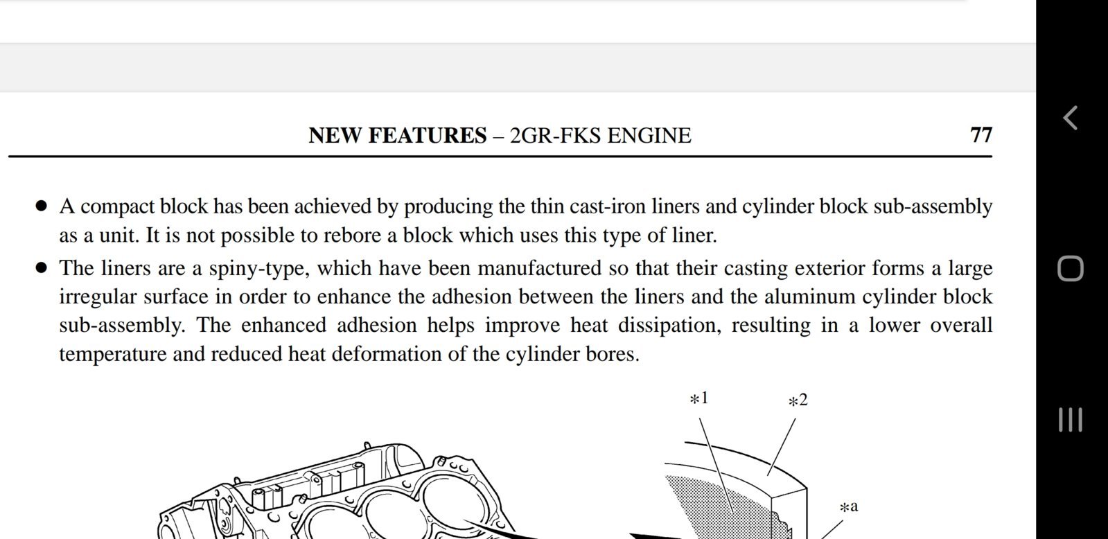

    I think if a bore was possible I might just rebuild the thing so I knew what I had, I'm trying to call the local machine shops and see if anyone would do it, just in case I can't round up a donor motor.

    Bore is not possible, but does not hurt to ask

    I wonder if someone has sleeves for these blocks, in case you want to run larger pistons? Then again, they'd also have to sell oversize pistons and figure out how to "re-sleeve" them, and maybe there's just not enough material to do it between cylinders.
