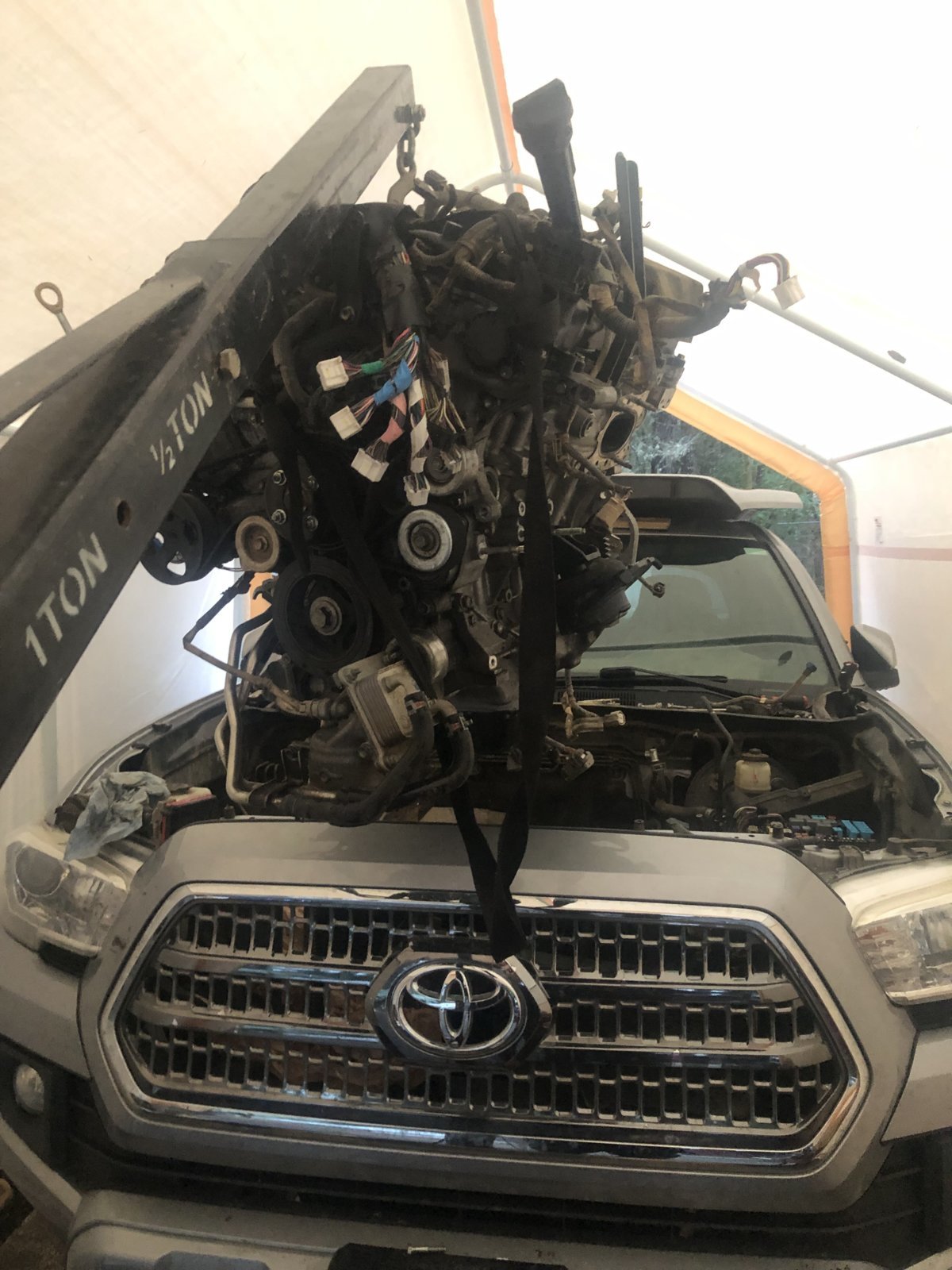

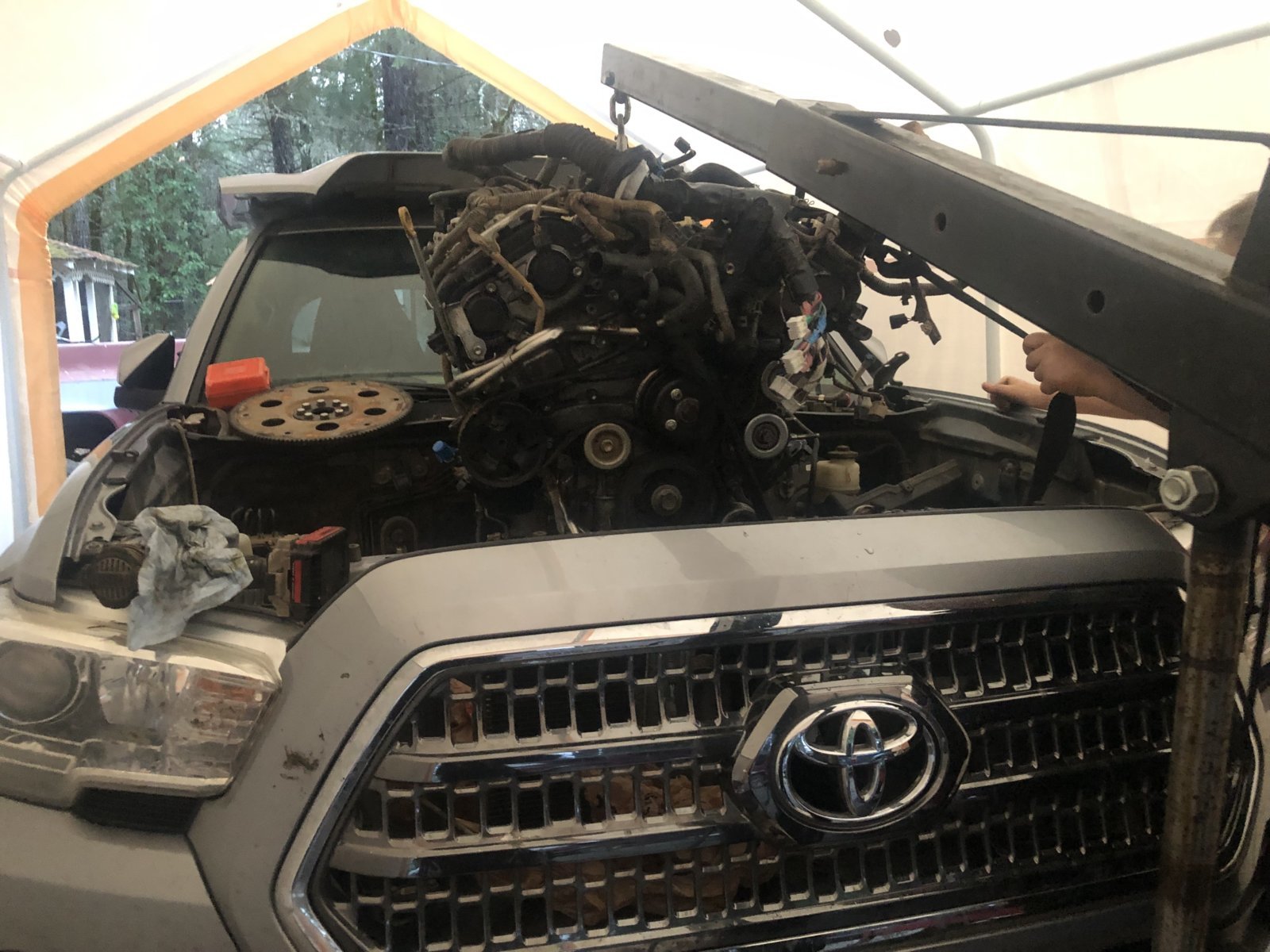

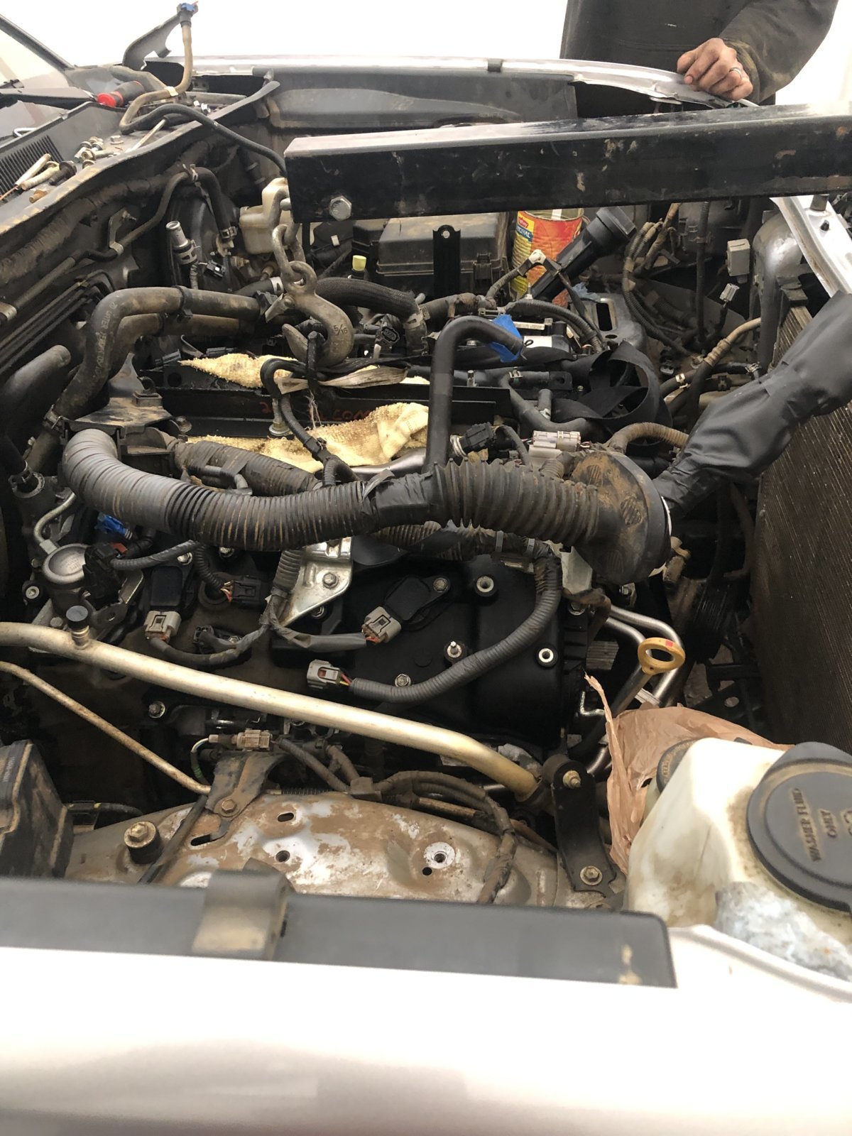

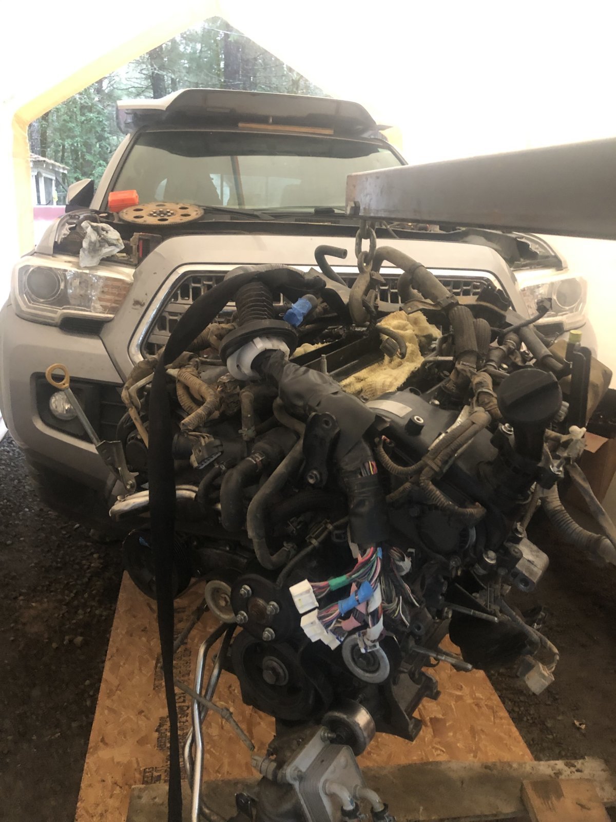

    The patient getting ready to go in:
    The part where you hope your chain holds!
    Note the strap you can hold on to guide the motor as it's lowered.
    Got it sort of sitting on the motor mounts now, note the re-use of the removal bracket thing we made out of scrap steel and rebar.
    You have to snake the big fat end of the wiring harness back through the big hole in the firewall to inside your glove box, or where the glovebox WAS, since you have to pull it apart to get to the computer and all the little connectors.
    You can kind of get the motor to sit on the motor mounts, but really you still need to wiggle it around to get the accessories like a/c pump hooked up, and the torque converter in the transmission to mate up to the bolts in a way that you can tighten them. We'll probably use a couple jacks to move the back of the transmission up and down until things align.
