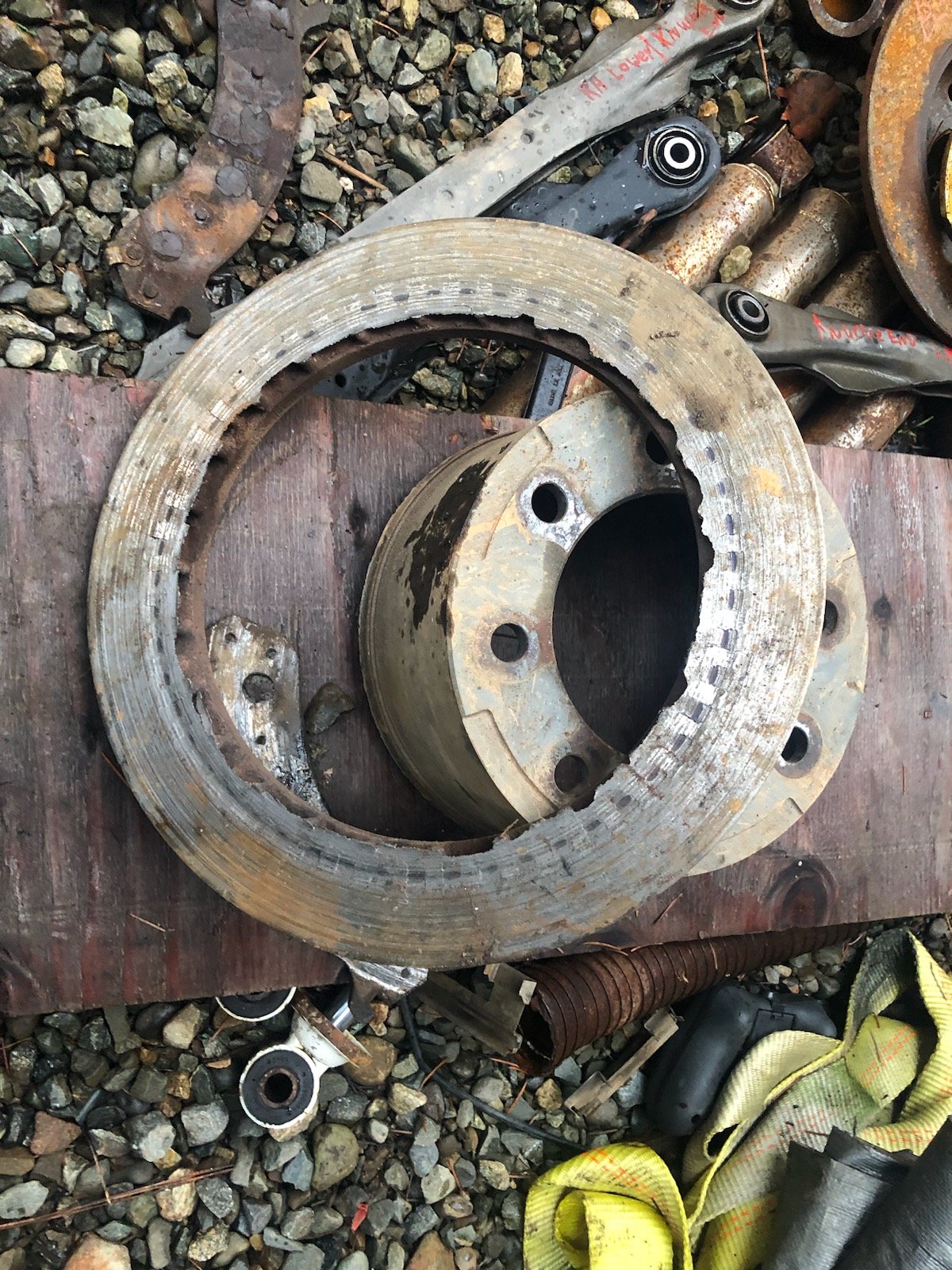

    But why? We have perfectly good humans for that. Unless just for profit... :rolleyes:
  5. Feb 3, 2024 at 7:40 AM
    #465
    stuttgart1
    stuttgart1 Well-Known Member
    Nov 23, 2021
    #382867
    136
    2019 TRDOR
    This is from a work rig that employees drive? I wonder when the last brake inspection was? Maybe it needs to be put on a regular maintenance schedule. Hopefully one that is better than the Tacoma was on.
