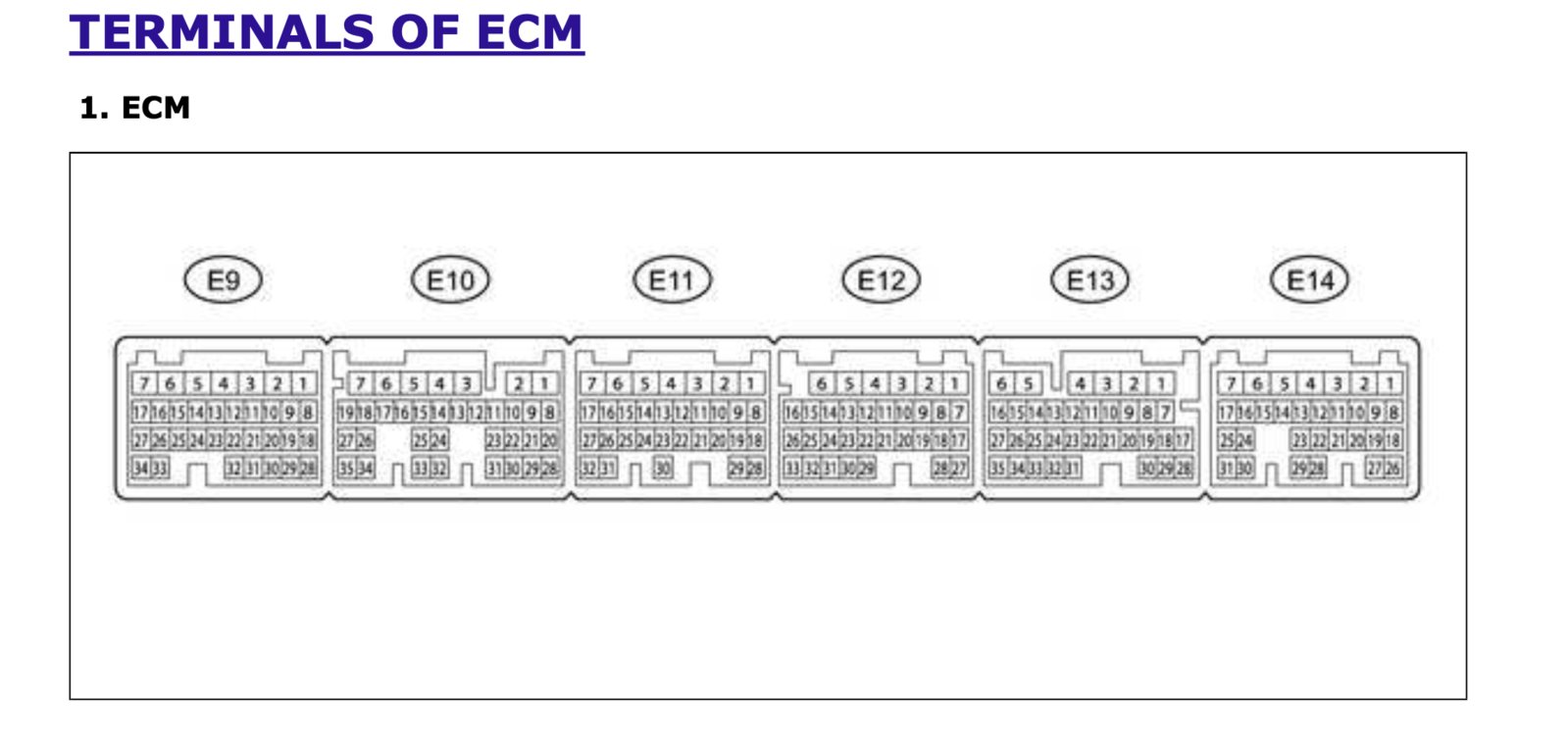

    It seems like it has to be something about the E9 connector, trying to find a picture of which one that is to send to our mechanic.
    I still don't know what caused the ECU to complain in the first place, the engine runs fine, except idles high and is in limp mode. I plan to replace the crank sensor at the same time as the ECU and verify the connectors on the ECU again. Maybe the wrong cam sensors causes a short in the ECU output circuitry around E9 connector? Otherwise I don't know what else to do.

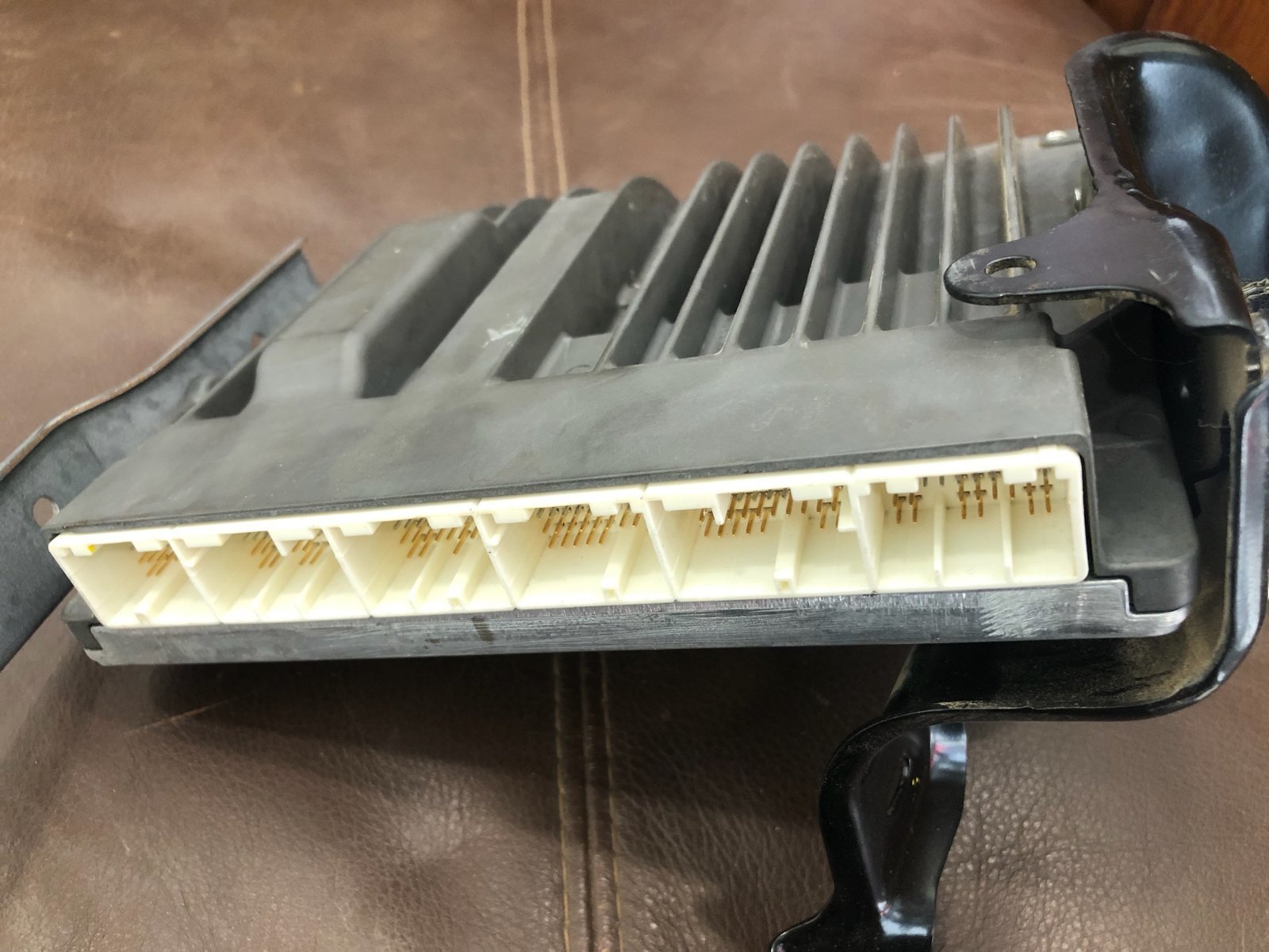

    New ECM showed up, don't see any bent pins, trying to figure out which one is E9.

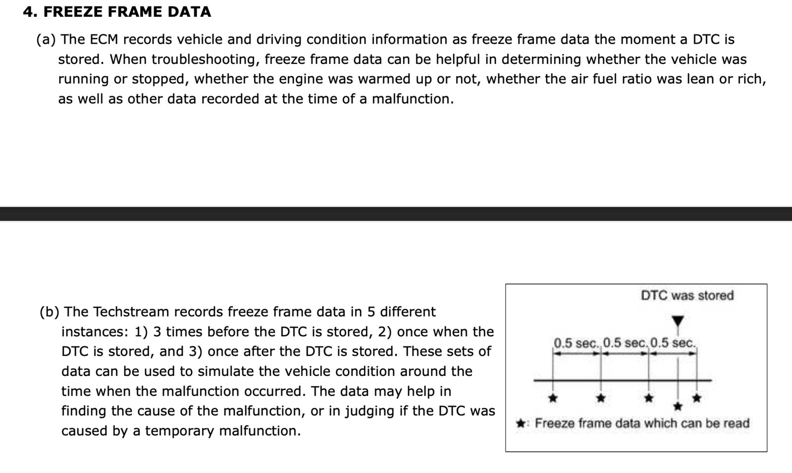

    Book says the exact trigger event is stored in memory, at least I think. I wonder if that will give me a clue what it thinks is wrong. If so, I should probably plug my scanner into the original ECM and try to get all the information I can before swapping.

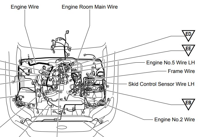

    double check ground point. E9 is being grounded on the engine. SM specifies 2 points: ED and EE via ECU pin 3

    re-checked all the grounds, E9 looks like it's plugged in fine to the ECU, and seems to be correctly seated on the transmission, I kind of don't know where else to look, or what caused the limp mode.
