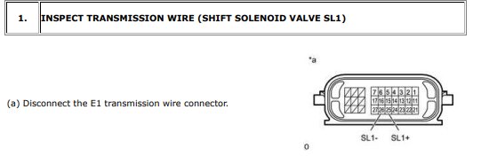

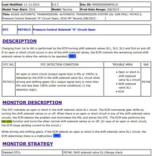

    in the service manual, look for this document. There are tons of codes that could cause the limp mode.
    Also your tranny codes from previous posts are causing limp mode P0748 and P0778.
    Same for 2wd and 4x4 tranny types
    These 2 codes are on separate ECU connectors E11 and E12.
    I would really look at the tranny cable again and run some testing. If testing from the tranny connector to ECU connectors (pin to pin) is good, then ECU is bad. Most likely on E9 connector side. E9 pin 23 feeds tranny pin 4 and 6

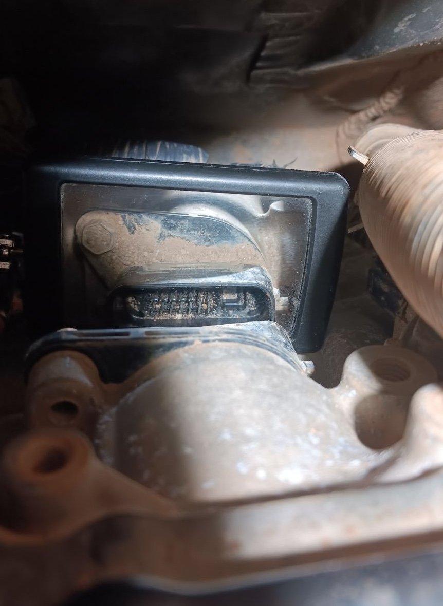

    Here's the first tranny plug we could get to, there is some crud in there. We're going to clean it out.

    you need to get to this connector

    Seems that connector is facing straight up coming out the side of the tranny, difficult to get to without a sawzall through the floor or dropping the tranny.

    Did you disconnect that connector when you pulled the engine out?

    we cleaned both ends of the connectors as best we could, re-inserted them and it seems like with the new scanner the transmission codes are cleared! We still have a crank position sensor, but we were planning to replace that anyway, so maybe we're getting closer. Or the new scanner is lying. Will find out soon.
