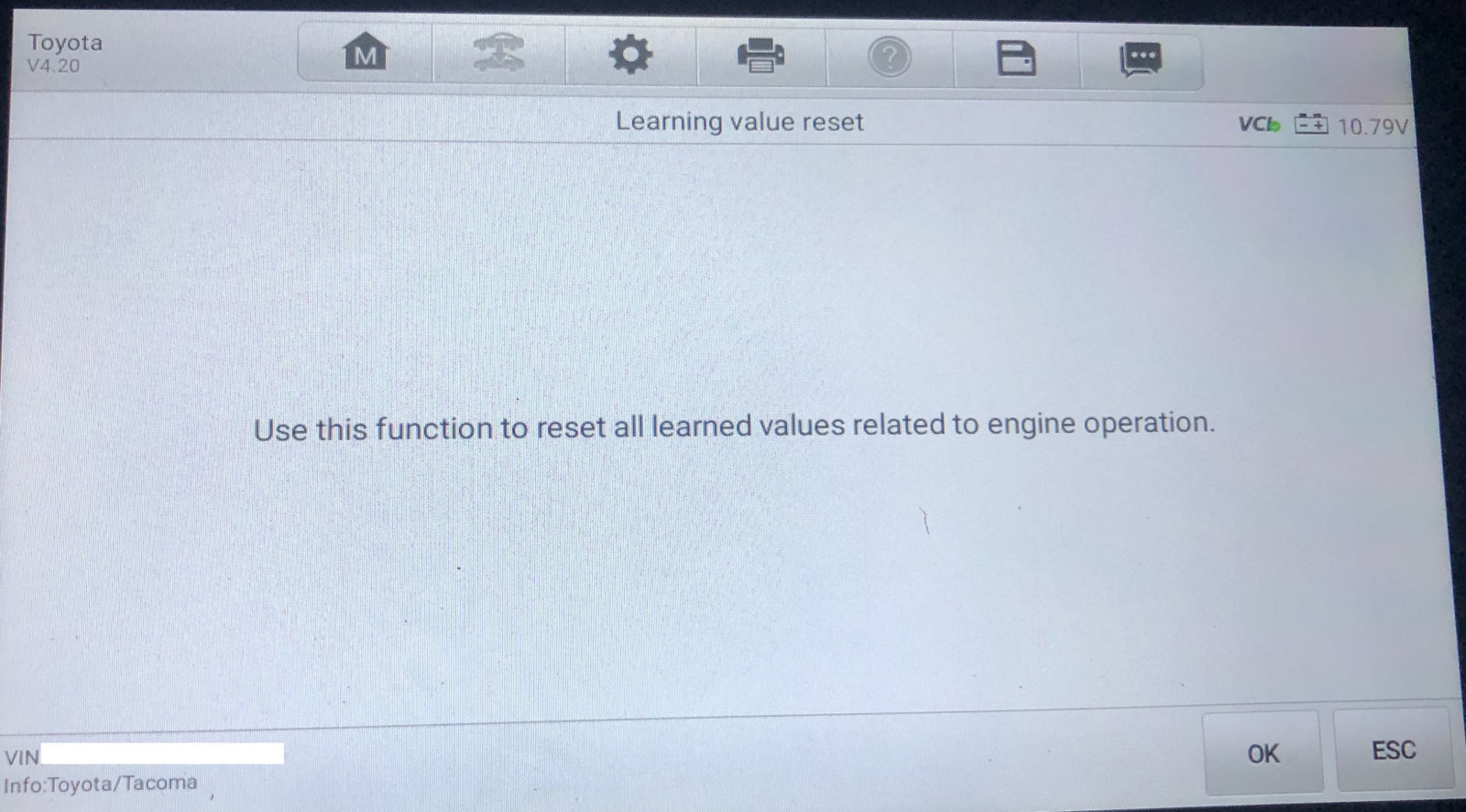

    Go ahead and reset value. This is normal stuff.

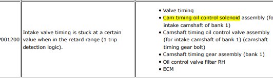

    I told you before, you need to look at intake cam solenoids.

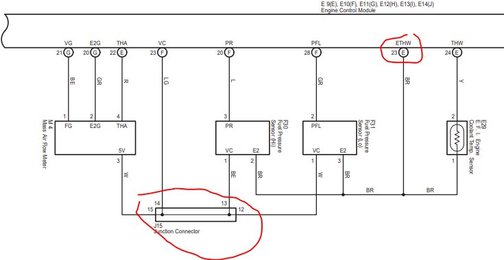

    Troubleshoot the fuel pressure sensor code 1st. That should take care all codes, except intake cams. Look for fuel related events (high pressure) in Freeze Frame. BTW, the connector is E9 on ECU side for the cams and fuel pressure . Also look what the junction connector between MAF and Pressure sensor

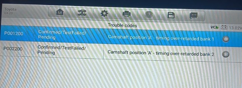

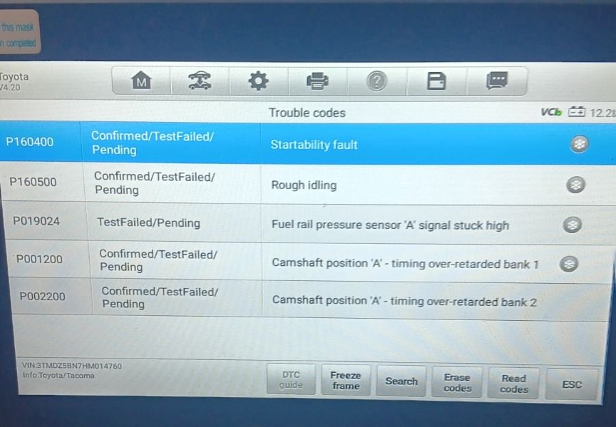

    did throttle relearn and then got only these two codes left.
    Toyota said the cam sensors rarely fail. I wonder if there a cam position sensor relearn.
    If the VVT function didn't work, I guess it would stay retarded and only idle because it wouldn't advance. I'll try to find out about the timing solenoids. It seems impossible for the timing chain to be off by one, the truck ran quite smoothly when it was in limp mode.

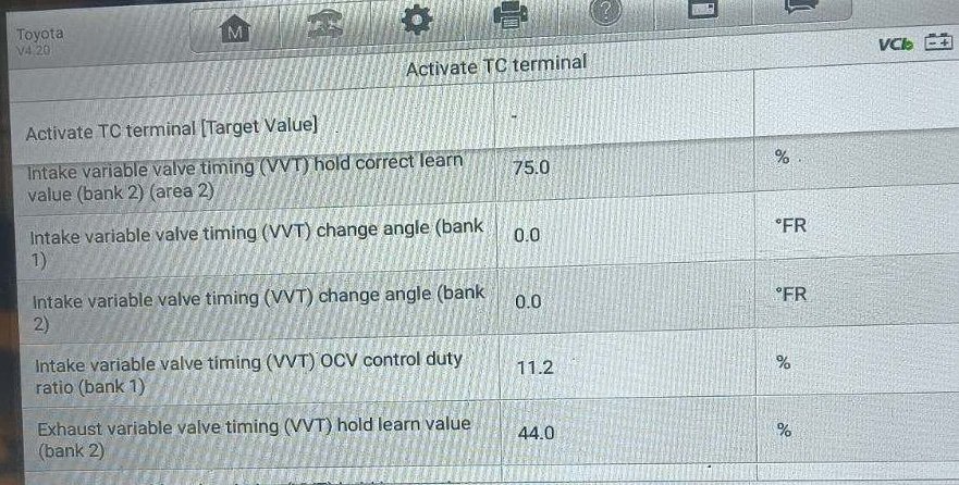

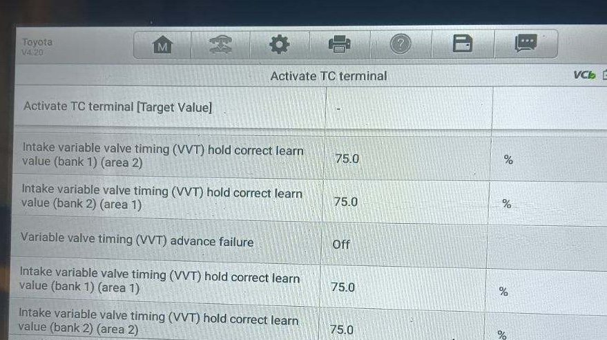

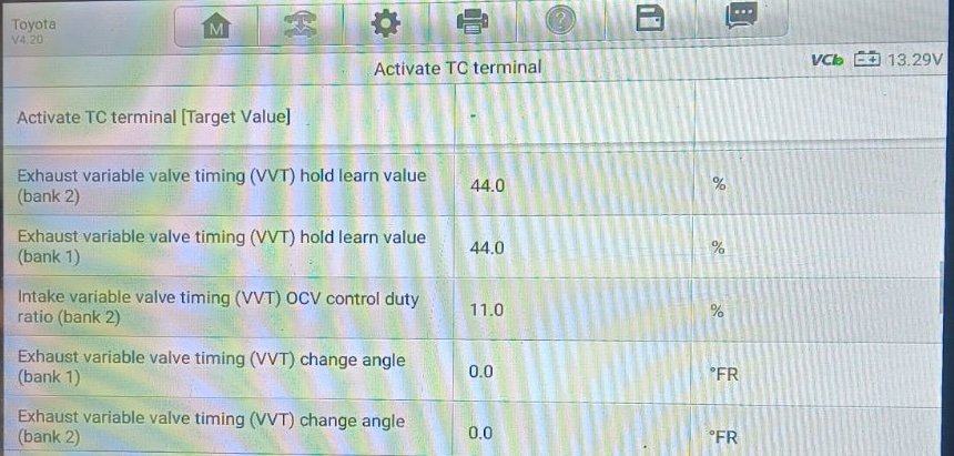

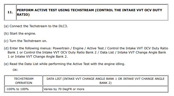

    look at this active test in the scanner's Active tests menu. Clear codes before
    If still getting codes after this test, look at solenoids

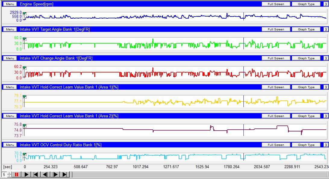

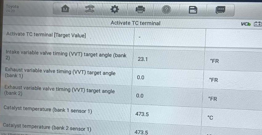

    Is engine starting and idling now? Could you check the freeze frame on the new instances of codes - Intake VVT target angle should be 30 at idle. I see you had 23.1.

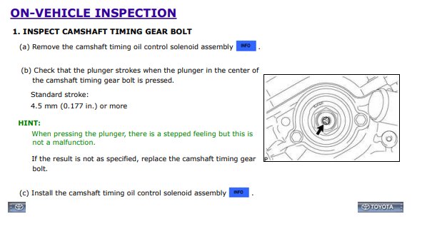

    What if you move solenoids from your old one to this? If you going to do this , check the plunger.
    But the concerning part is that both banks got stuck. Meaning it is caused by a common component. it is either ECU or the engine valve timing is off.

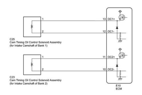

    2017 White SR5 DCSB V6 4x4

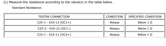

    Intake VVT Change angle is stuck at 0. Should be equal or very close to Target value. You should see similar to this at normal.

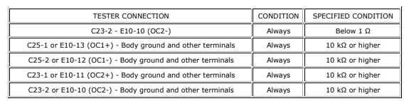

    Sorry, I was wrong on the connector. On ECU side it is E10. Check connector/pins and resistance.
