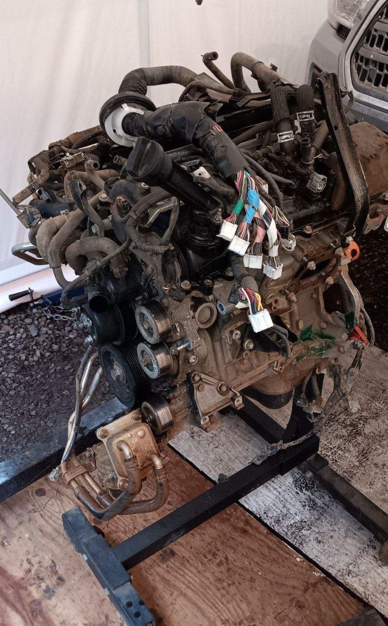

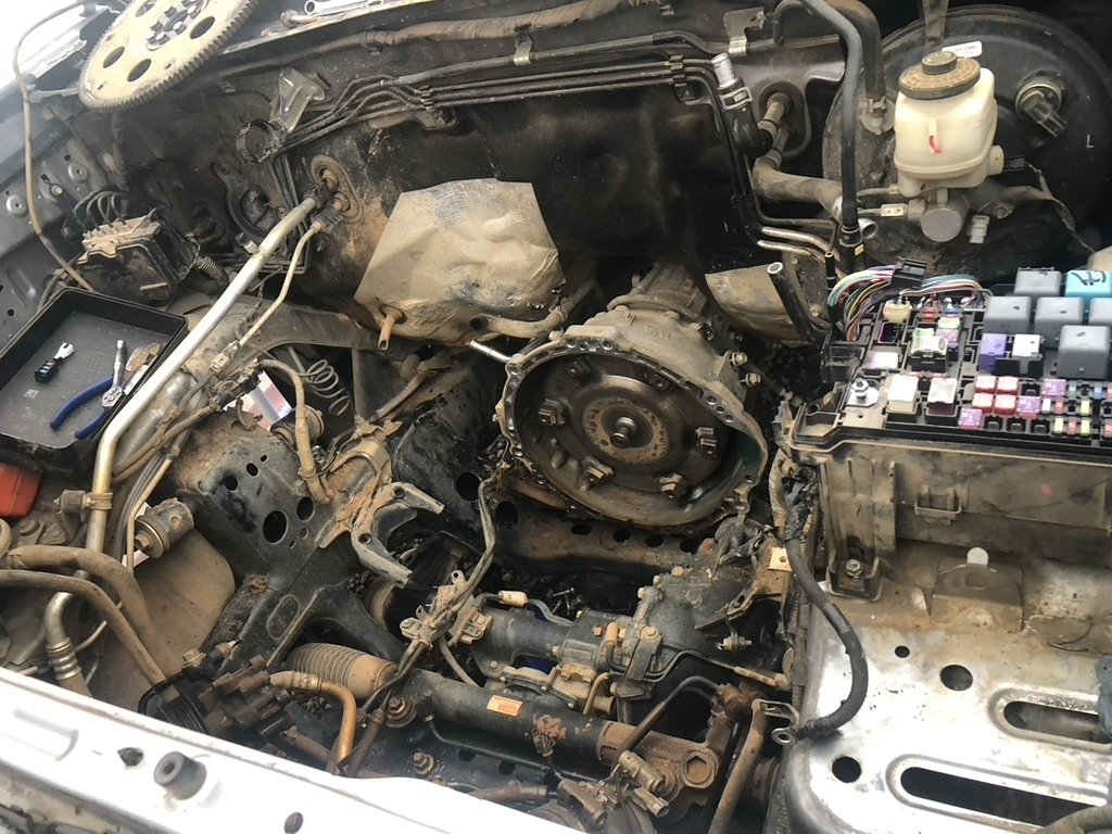

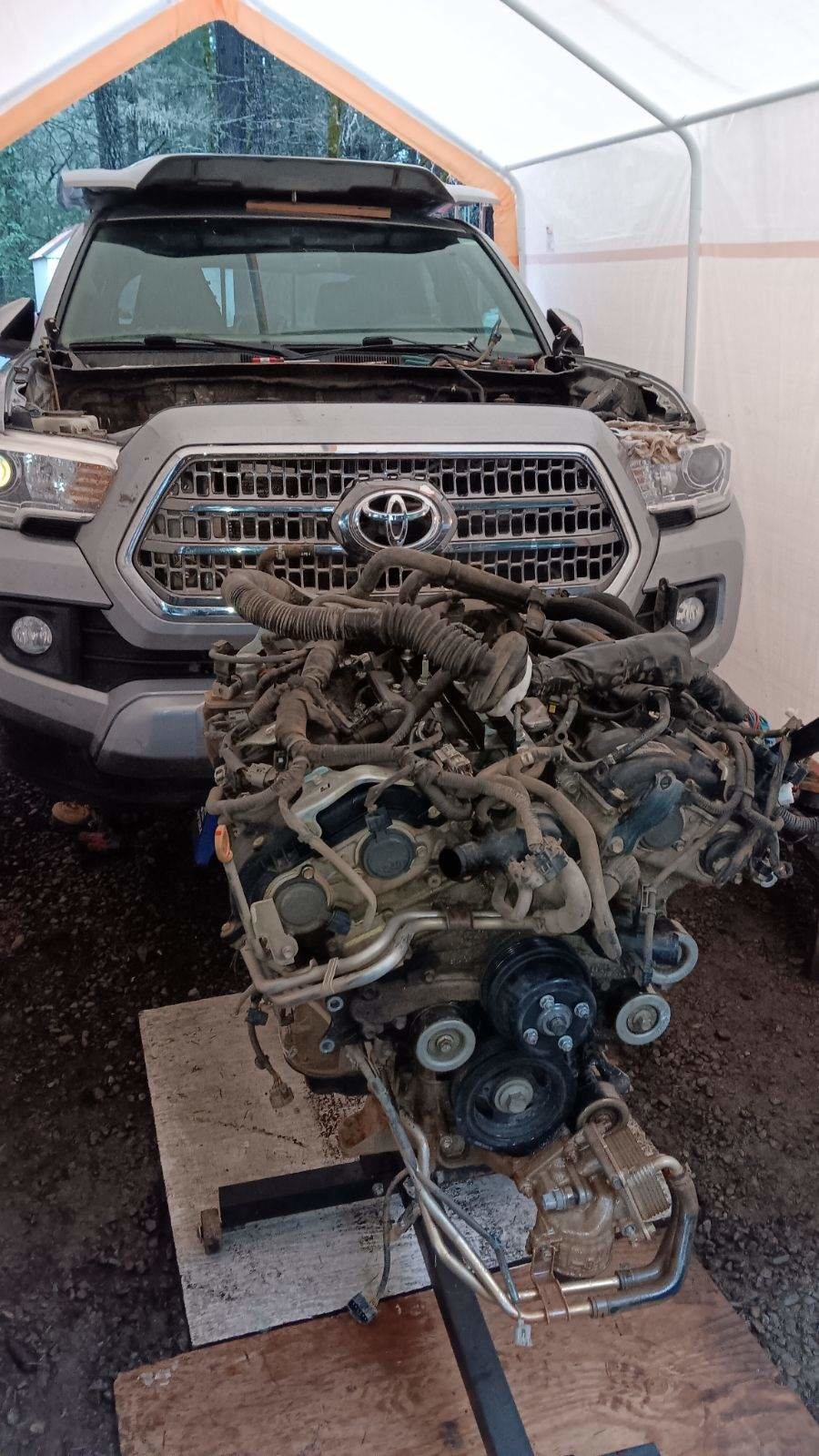

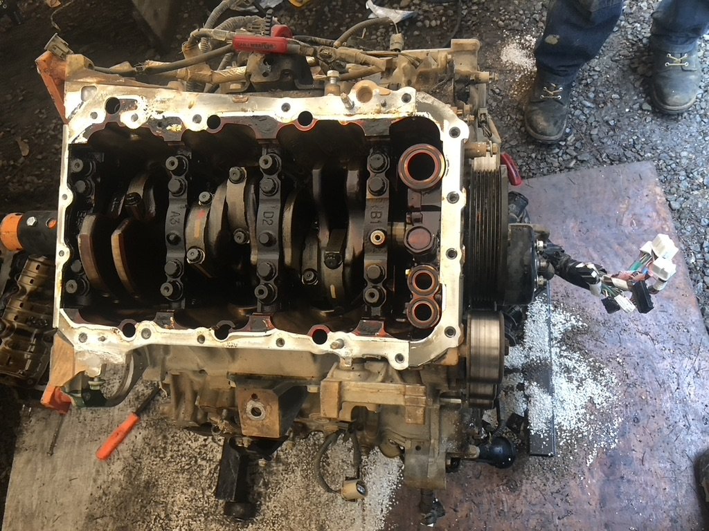

    Here's the engine compartment with the motor pulled. The book says to pull the transmission first, but got it out.

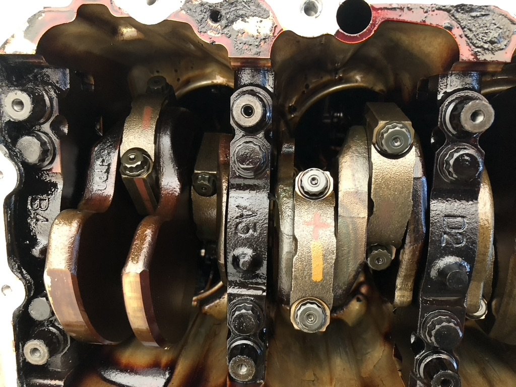

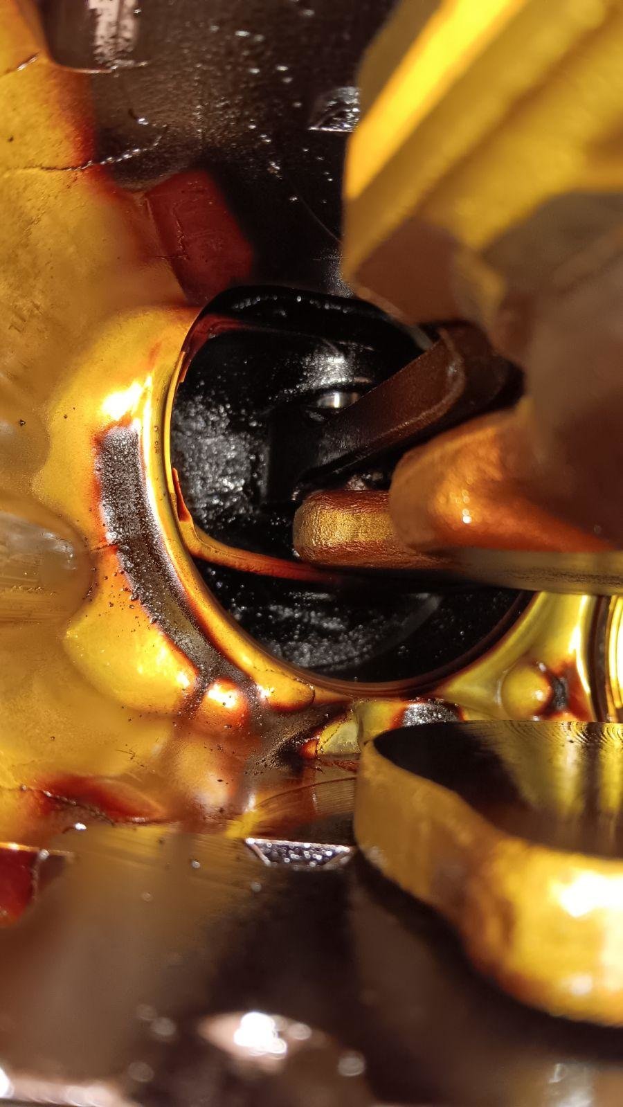

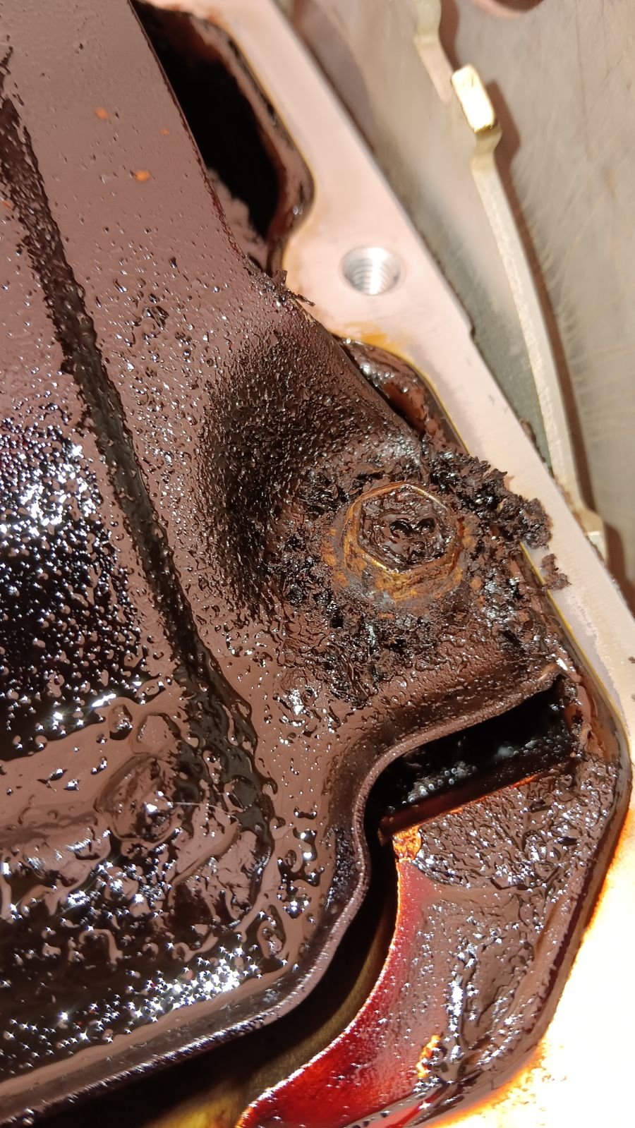

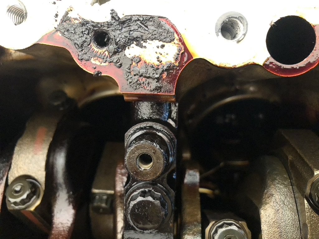

    Now you can see the beginnings of the black crusty oil residue:
    Look at the black crusty stuff I scraped off with my fingernail above the main bearing cap:
    zoomed in.
    up by piston:
    gummed up by the oil level sensor:

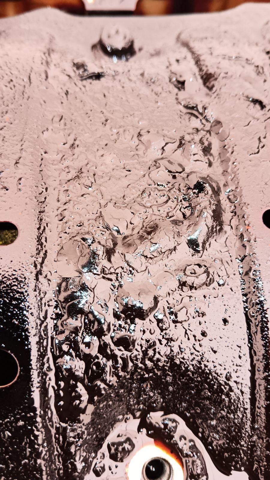

    Under the splash thing under the crank you can see how crusty the oil has become:
    This stuff is pretty gross. No idea why it looks burnt though, this engine has never been hot or run wide open since it was new:
    Next stop is to pull the bearing caps and look for galling, scarring, discoloration, etc.
    So why does regularly changed, not hammered Mobil 1 0-30W do this? Not super cold or hot operating temperatures. pulled trailers with it from time to time, but not super heavy ones.

    I’m going to let more knowledgable people than me comment on the internals of that engine, but I am curious what makes you think (or how you know) it’s getting mobile one 0W 30 from the dealer yet you aren’t sure what the maintenance intervals were. Because it should be 0W 20, and the dealer is probably using the recommended weight and doesn’t necessarily use mobile one.

    Should have used Valvoline 0w-20, JK. High heat and moisture = sludge.

    That didn't happen all at once.
    Something has been wrong for a while.
    What does the oil pick up look like? Is it plugged up with back particulate?
    My following question is not at all to place blame.
    How often was the oil changed?
