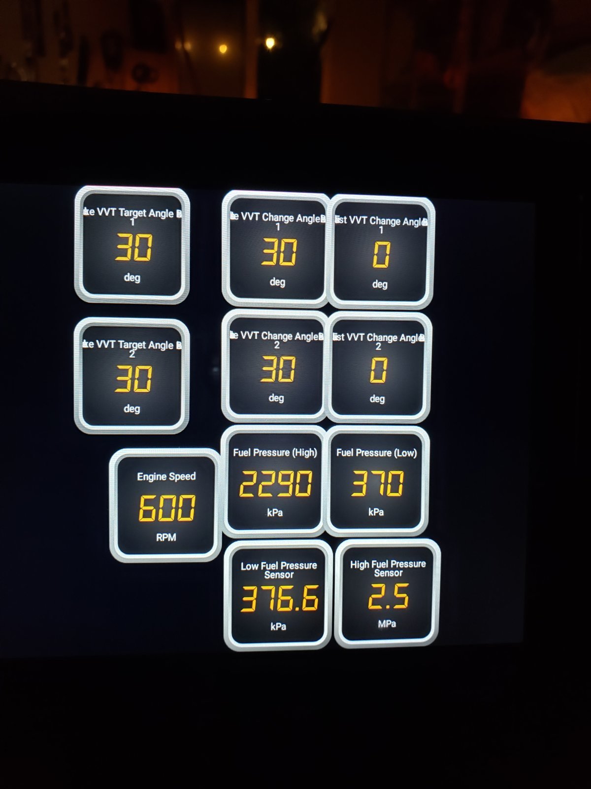

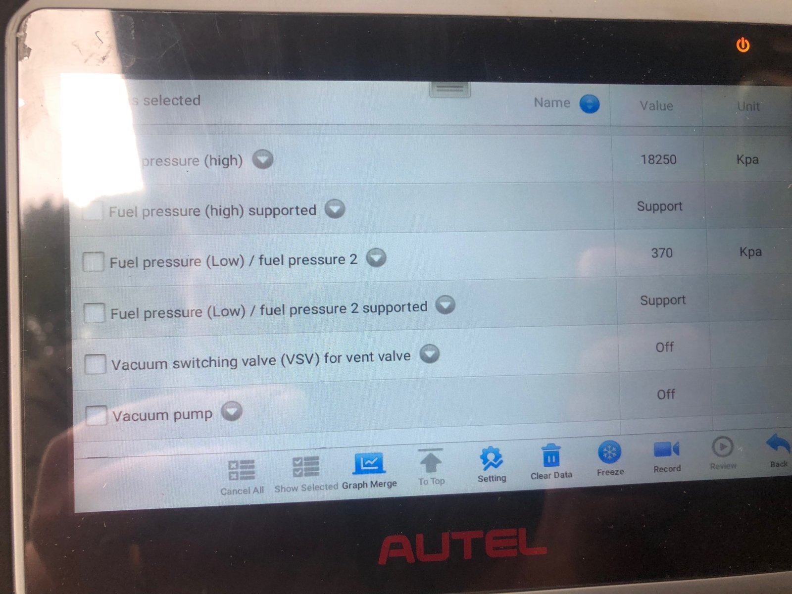

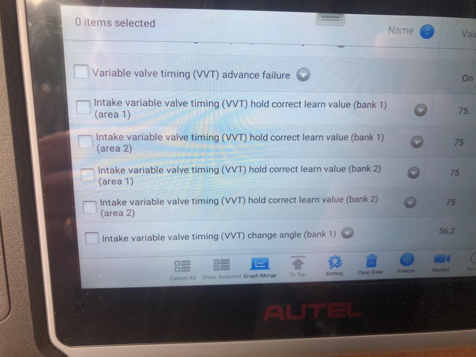

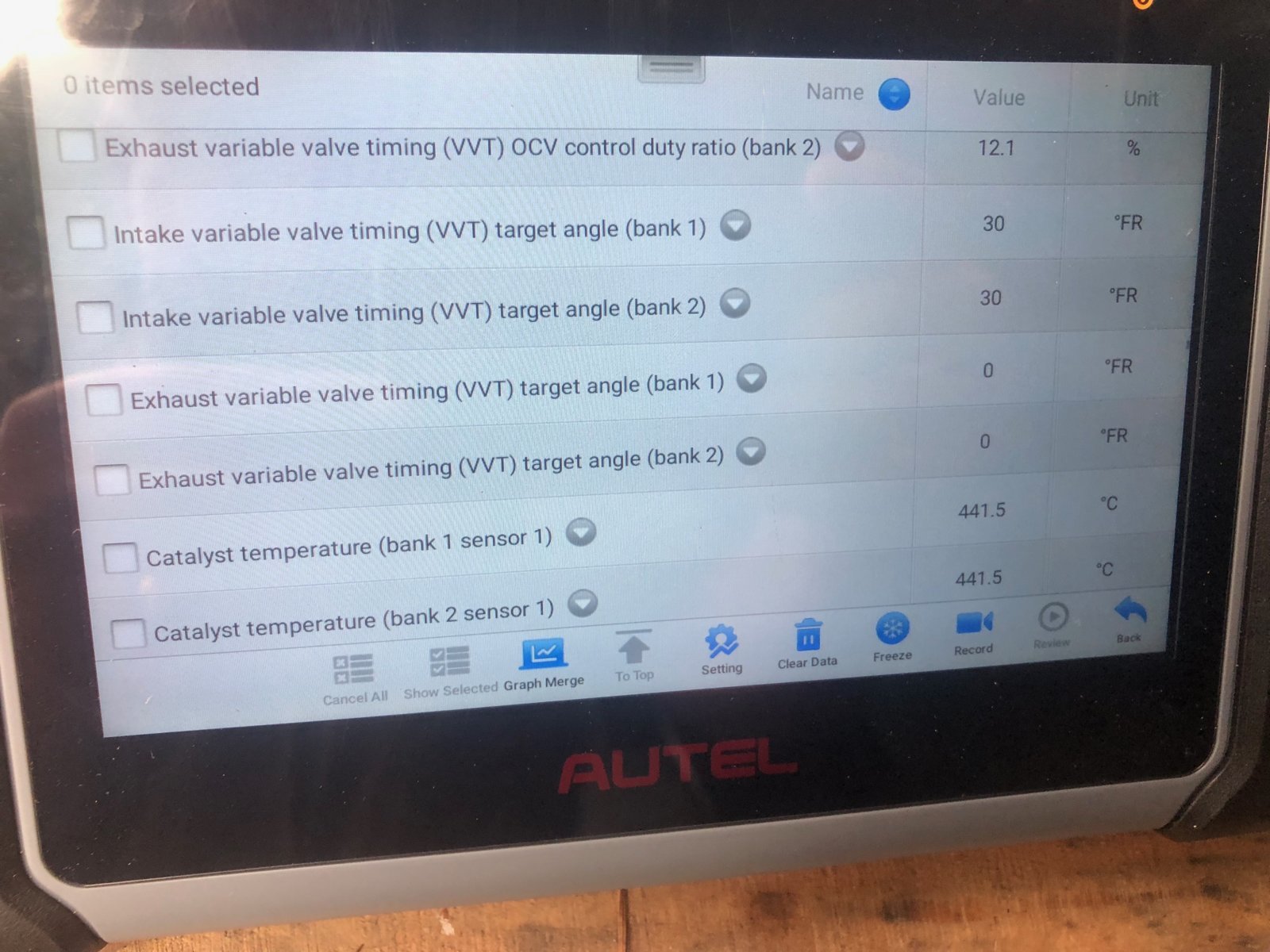

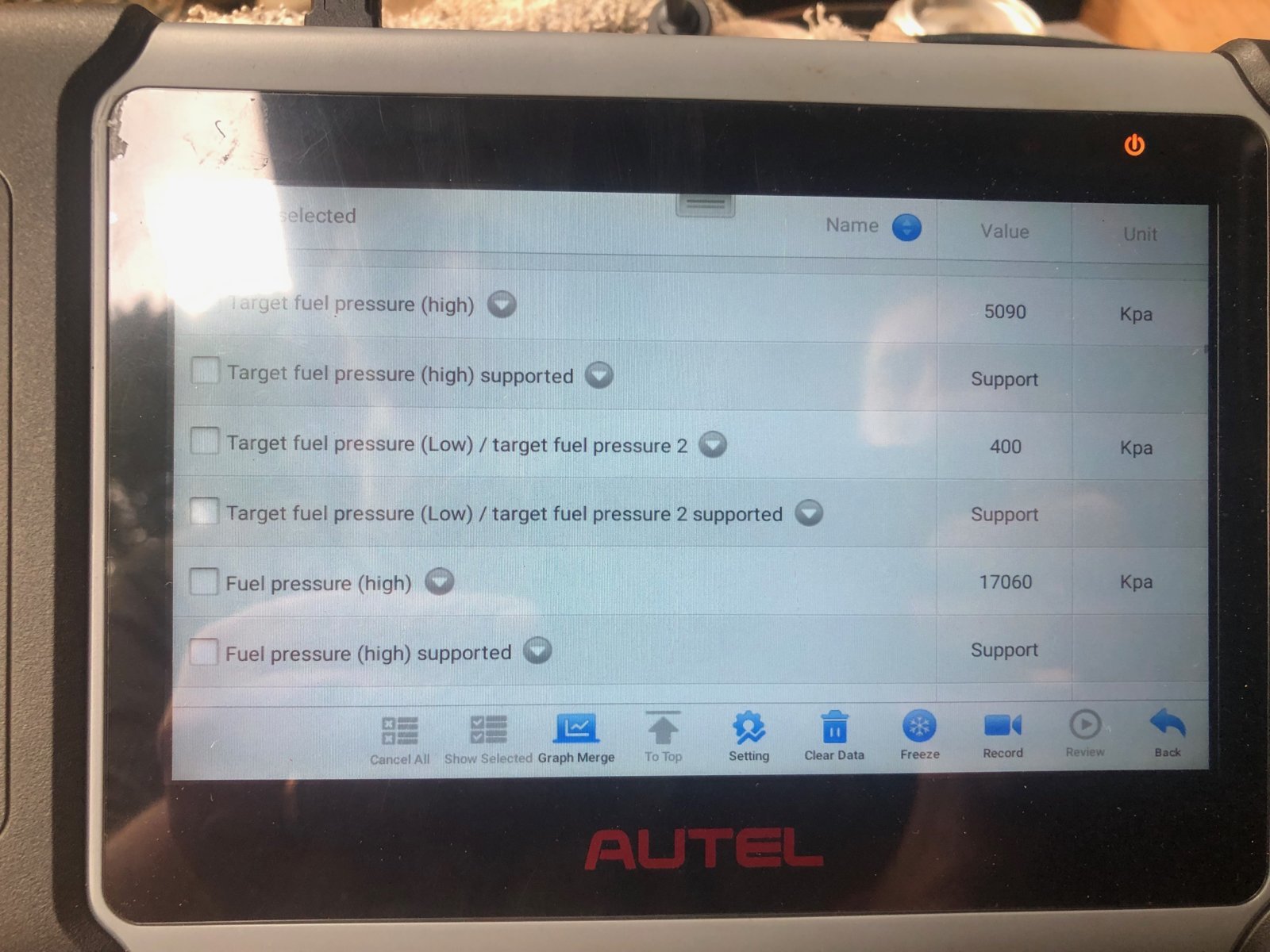

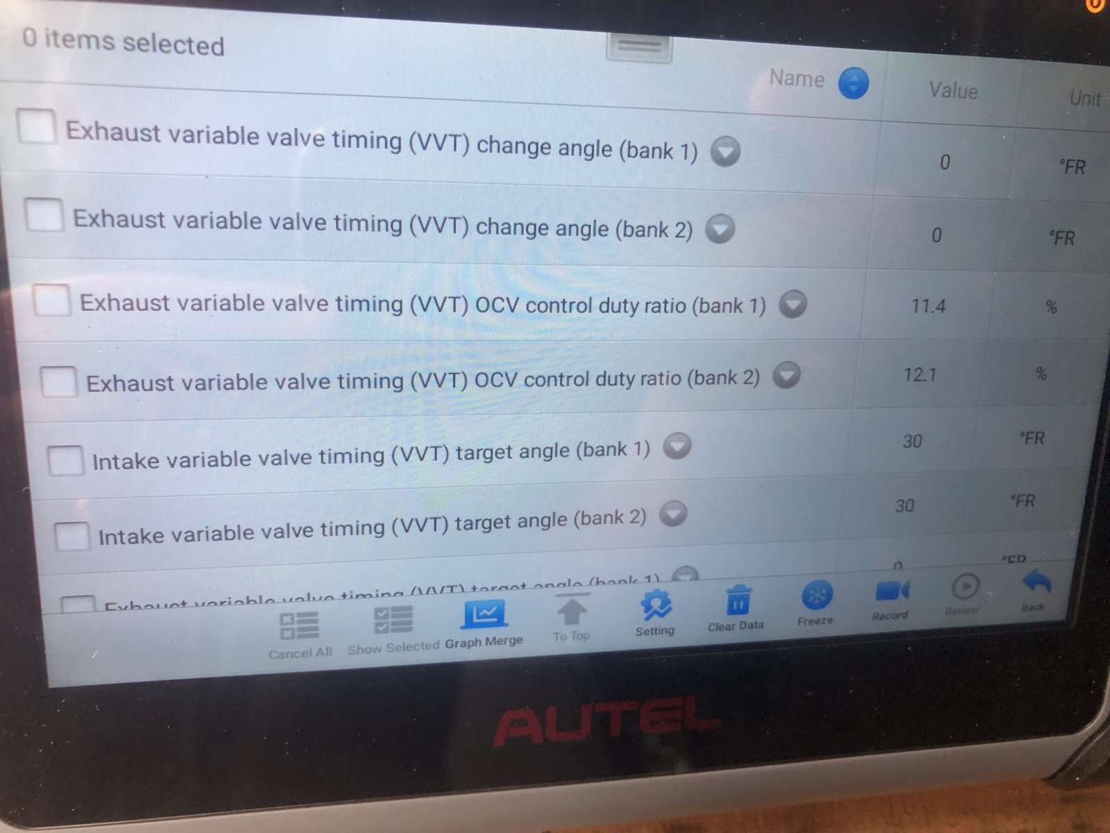

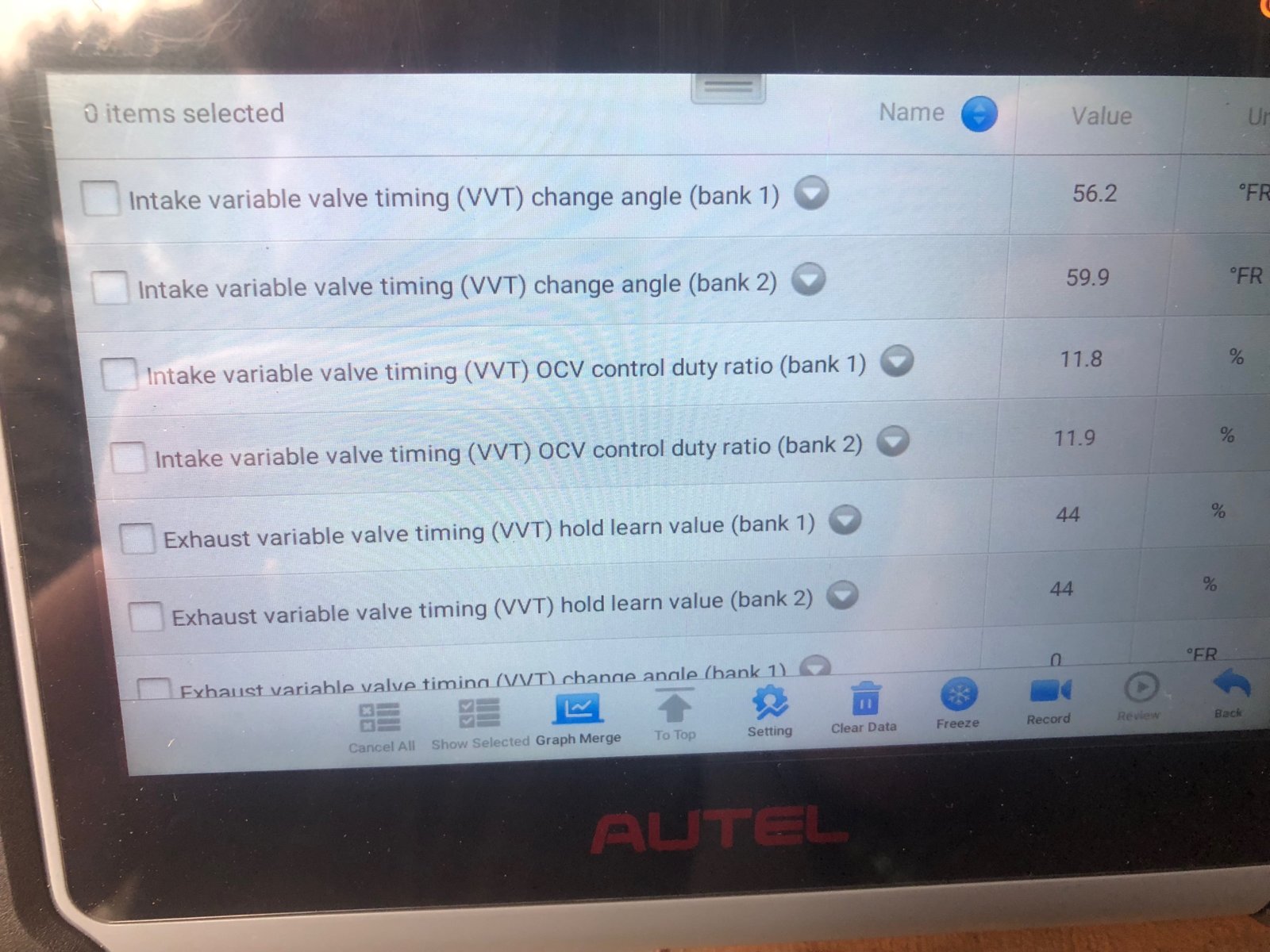

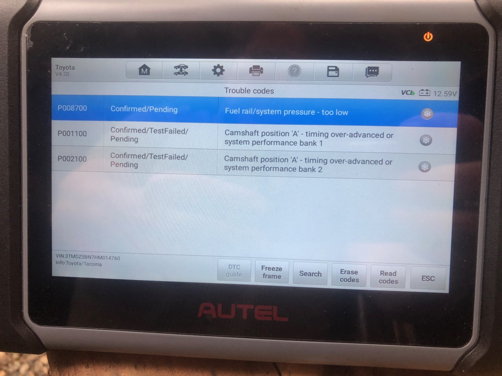

    Okay, so it runs, barrrrrely, stays at about 500 RPM. Sets a couple codes. Here's how it runs:
    https://youtu.be/HAfGpMIMCTA
    Here's the codes it sets:
    Here's some live data.
    and some VVT timing shots.
    It seems like I saw somewhere you can manually operate the timing solenoids and see if they freely move and don't stick advanced or some such. I wonder if there's a screen about those solenoids that I didn't get to.

    Your low and high fuel pressure seems within normal range. If you turn the key and don't start the engine, can you see Low pressure getting to 450 -480 kpa?
    You are misfiring. See which cylinders do.
    You have something going on with you intakes cams. You can see that the target is 30, you have 56 and 59 (over advanced), therefore the code is set.
    You may need to pull the valve covers to check timing marks and possibly swap cam gears
