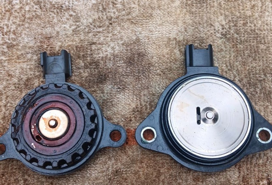

    Holy crow, we're up to page 31! We are super hopeful that pulling the valve covers will uncover the wrong sensor plate thing and solve this before I get too old to find my teeth. At this point I'm not above checking little stuff like oil, but the current most likely smoking guy probably relates to the cam sensors, and possible the fuel pressure, though with low idle maybe it would be a little low.

  20. Feb 23, 2024 at 2:14 PM
    #620
    silverstr8p
    silverstr8p [OP] Well-Known Member
    Oct 7, 2016
    #199188
    257
    So this is the difference in the cam sensors between the old motor and the donor, I don't know why they're so different, but the current theory is that whatever these do to the cams, whatever they interact with probably is different inside the valve covers, so we're pulling those and looking on the ends of the cams to compare between old and new.
    I also see a cam solenoid mentioned, I don't really know where those are and what to look for, but hopefully it'll be obvious when we get these off.
    I filled the motor with molasses, super cool trick I found online, must be true :) Oh wait, Mobil 1 0-20W, more than one.
