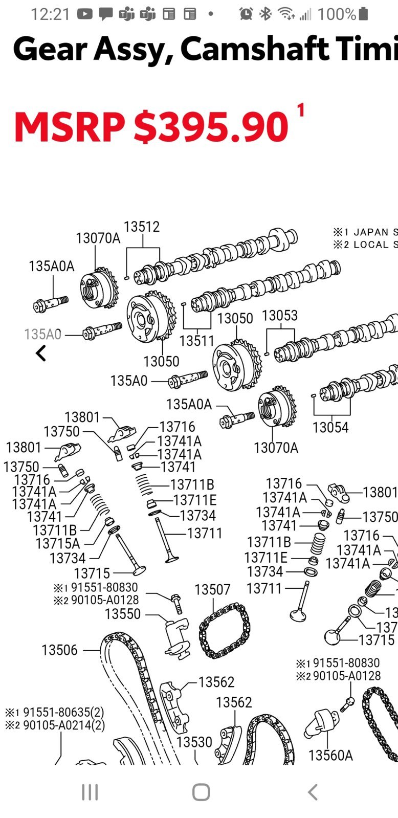

    Understand, but in your illustration of the timing marks in post #632, the single line timing marks are on the left cylinder head and the double line timing marks are on the right side cylinder head (looking at the illustration).
    In silverstr8p's picture in post #631, it has both the single line VVTI AND the double line VVTI ON THE SAME HEAD. I believe they need to be swapped over. Trying to paint an clear and understandable word picture.

    According to Parts.toyota.com, it is a same part # for the phasers.
    He needs to rotate the crank to get yellow marks on small chain to line up with notches on the bearing cap when cylinder #1 is in TDC. After that he can tell if he is out of timing. Probably need to remove all covers

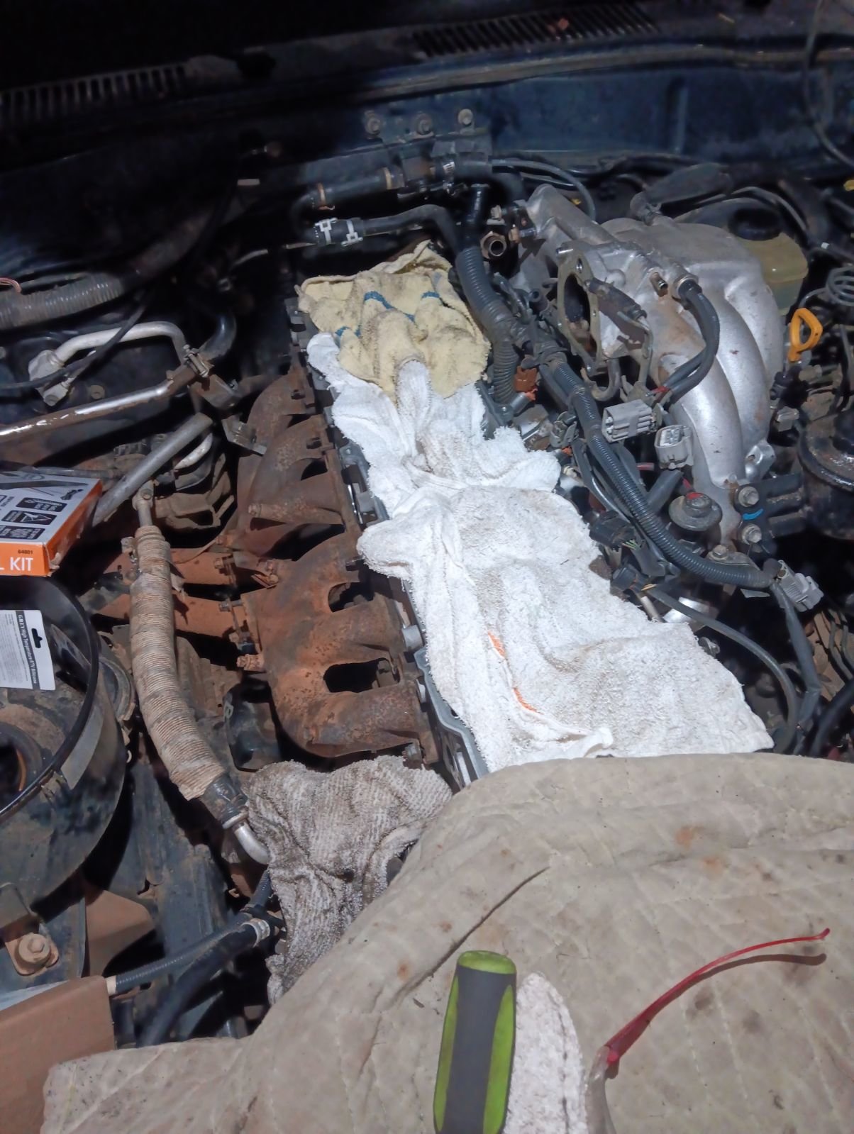

    The head's going back on the Land Cruiser today, back from being milled 5 thousandths to make it flat again. If we can get that together today, I can drive to my house, the duramax just ain't happening.

    We're working on the lifter re-assembly on the Land Cruiser, guess they got mixed up at the machine shop, so now we're mic'ing a bunch of them (grrr). It would be nice to have the Land Cruiser though, since we got more than a foot of snow. After he gets that together and we can dig out of the snow, we'll pull the front timing cover on the taco and make sure timing is right. If that's okay, I really have no idea what to check. What are the odds it skipped a tooth? Possible I guess, just seems unlikely.

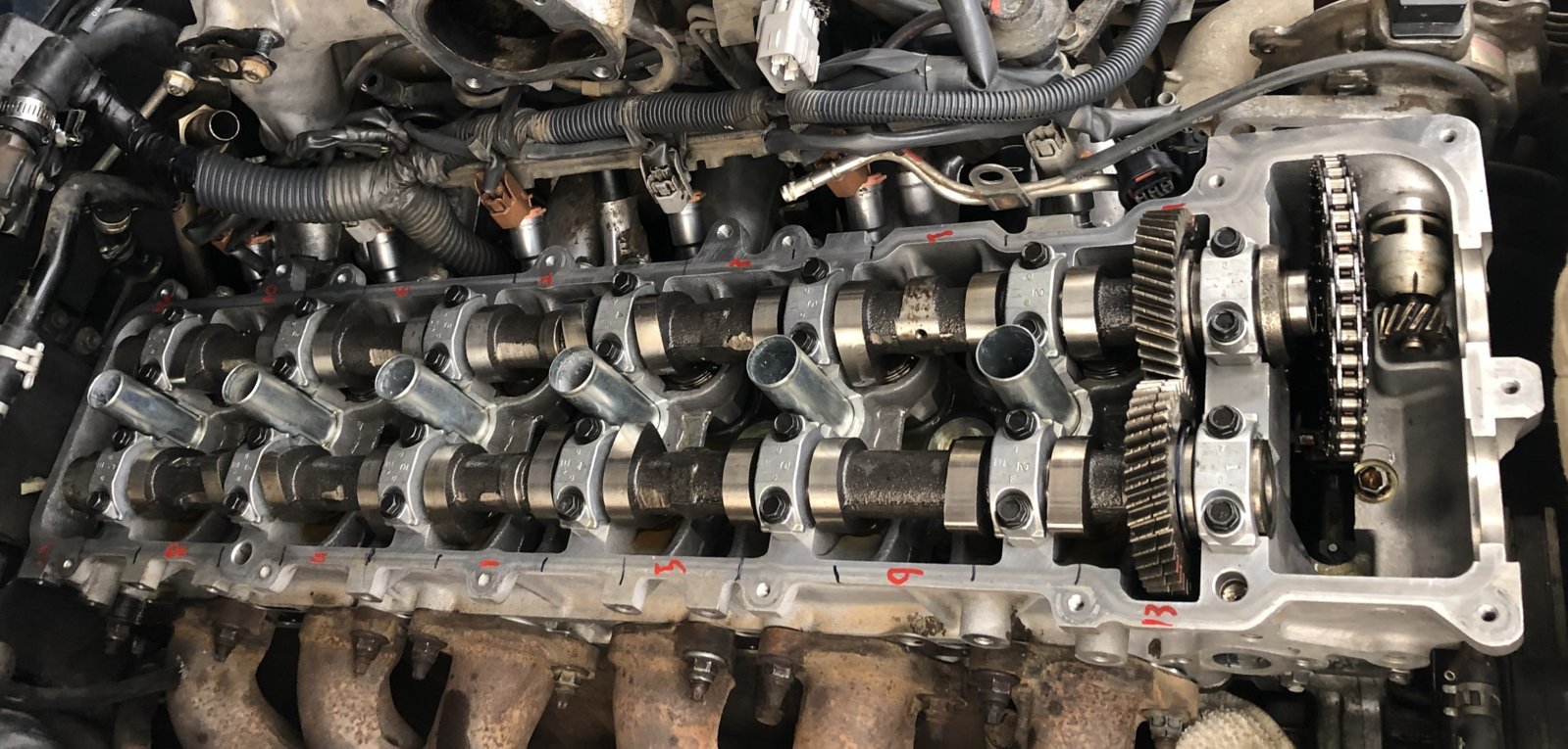

    Patient on the land cruiser table:

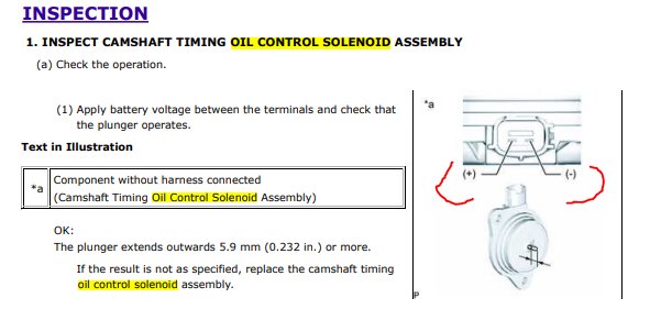

    Did you test solenoids by applying 12V to them?.

    Meanwhile, here's a better picture of the land cruiser head, we bolted it together, tried to crank it and it seems to have no compression, must've gotten the timing chain 180 out or something. Will tear into it and check when it's daylight.lchead1.jpg

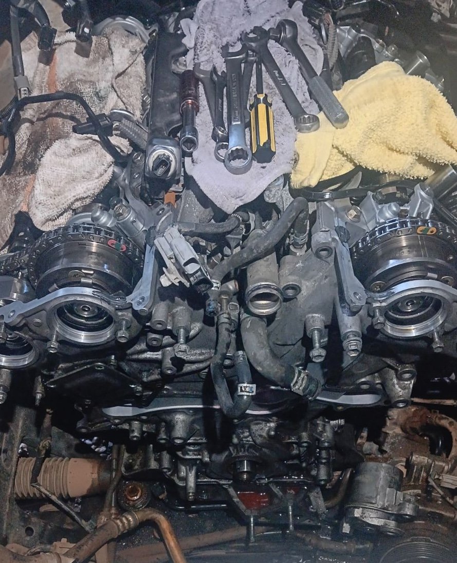

    Aannd we're pulling the front cover back off. The problem, I think, is that you can do it with the pan on, and you can't get the pan off without pulling the motor back out. Correct me if I'm wrong, in this case I'd really like to be wrong, it would save time.
