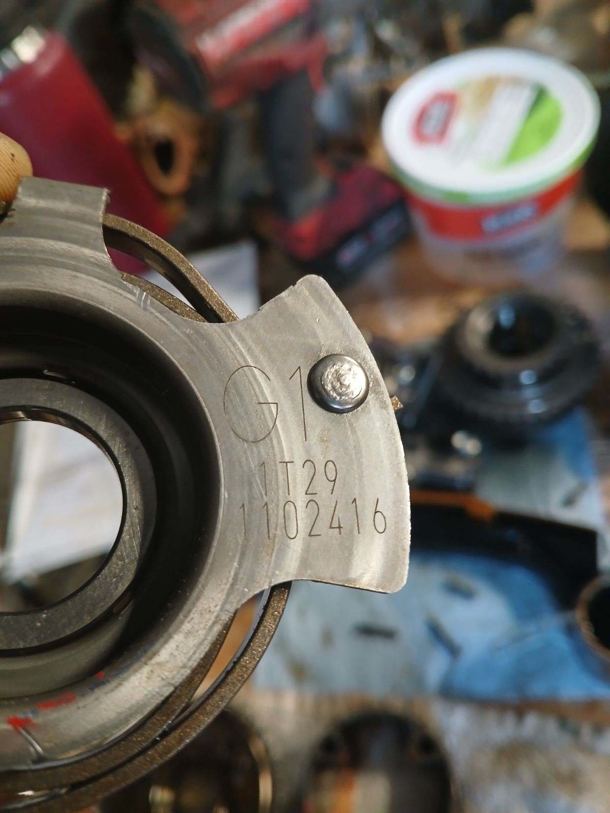

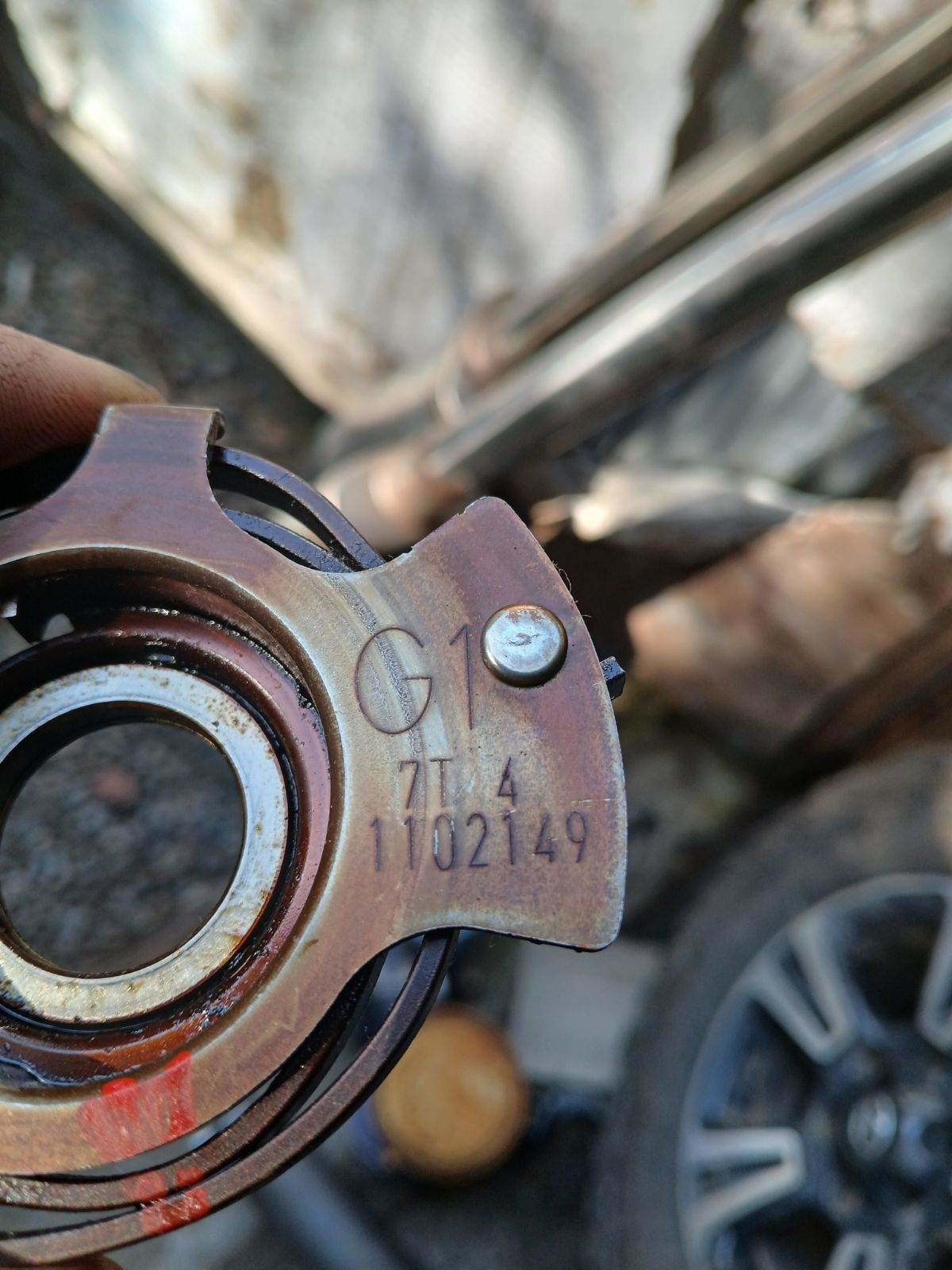

    Here's the old and new phaser parts, are these just different enough to cause problems, or are they basically the same?

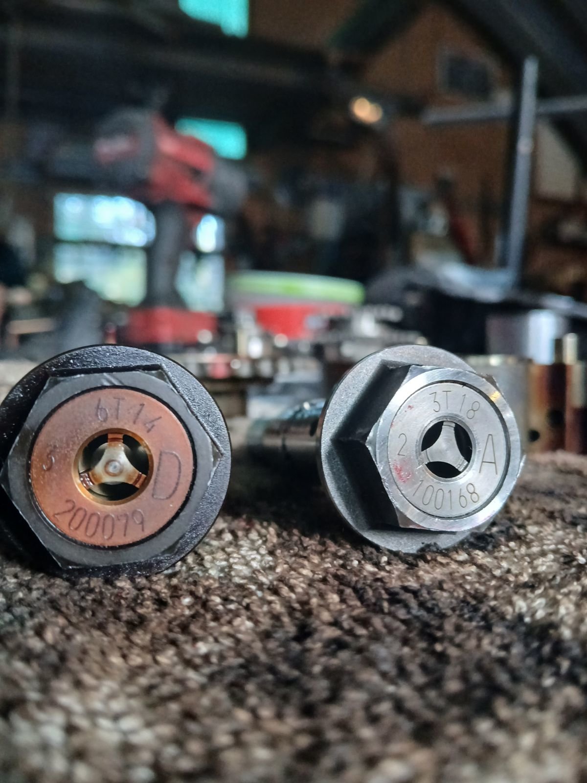

    Here are the old and new bolts that fit in the center of the end of the cam, same question for these bolts, I'm planning on putting all the old stuff on the donor motor and hoping for the best. Anything else I should be looking for to swap/replace?

    I don't think they are different, but this is based on looking at RockAuto parts through the years. They list the same parts from 2016 through 2021.

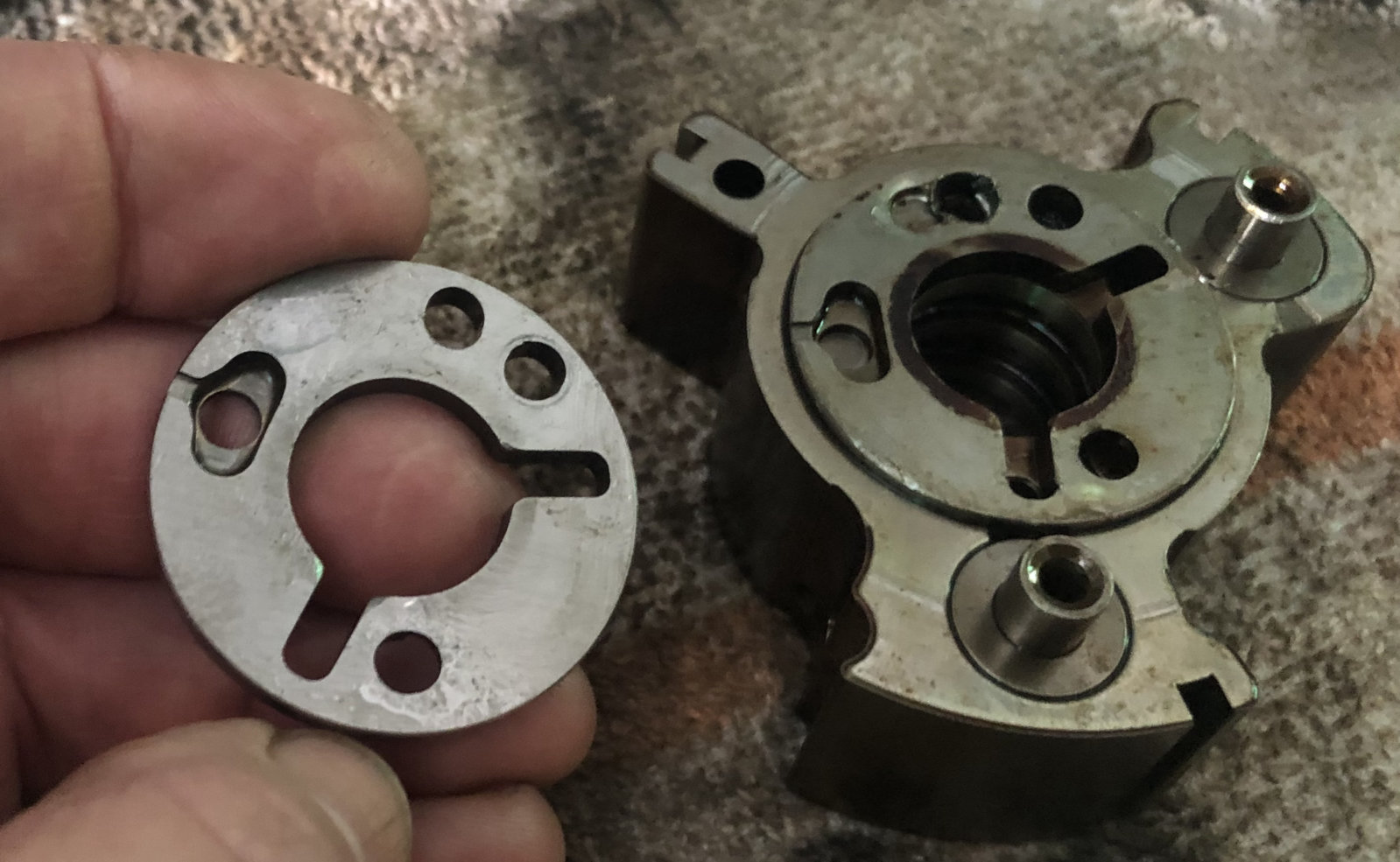

    What are these little disks, and are they supposed to spin or just sit in place? Both the old and new look the same, are they? The older one is kind of jammed in place, but the new one moves freely, wondering about using the new disk on the old phasers.

    Looks like those are oil channels. It uses hydraulic pressure from the oil to rotate the cams.

    We've measured most of the parts with a caliper and can't find hardly anything different. The hollow "bolts" that screw into the center of the phasers seem to be different, what other differences are there?

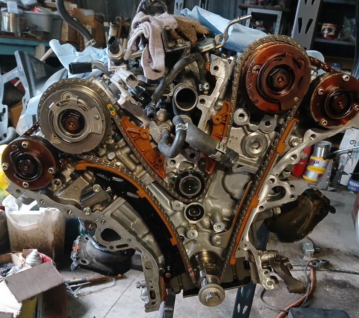

    Did you confirm if timing was correct? Your data was showing about 30° difference. If you look at some cases of jumped tooth out there, the difference is about ~30°.

    We noticed when we pulled the motor that someone, for some reason, at some point, had the front cover off and it wasn't us. That might lend more credibility to the timing being a bit off, vs just thinking it skipped a tooth for some reason. I have to dig back through the giant manual and figure out how to do/check the timing.
    We're putting the cam phasers and crank sensor back together, using the new little disc vs. the old one since they mic out the same. Hope the heck this all works. We'll definitely use the old center bolt thing, since that's visibly different from the newer one.

    Hope the timing isn't off...being an interference engine I would think the valves incurred some damage if that was the case.

    If the timing is off, it really couldn't have been off by much, since the thing ran in limp mode. If it was off by one tooth I wouldn't think that would hit the pistons?

    In post 631, 2nd pic of cams. It seems you showed bank 1 and I see 11 chain rollers (small timing chain) between marks on intake (intake mark looks lined up with a notch on the bearing cap) and exhaust cams.
    There should be 12 rollers.
    The exhaust mark seems behind and if you line it up, the intake will be past its mark. So you would need to move intake counterclockwise to line up.
    It could be distorted image,but this would be a classic example of the jumped tooth.
    Make sure cams are linedup and small chain marks line up as well.

    Okay, so here's what we have, look okay? The passenger side intake phaser off the old motor looked a bit rough so we used the new motor one, but the center bolts are indeed different, so we're using the rest of the parts off the original motor.

    Impossible to tell from that photo. Skip to the final check on marks on this video. If you did this, it is probably good.
