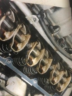

    Did you do a lot and i mean a lot of really short distance driving. Another cause of sludge is if the engine doesn't get hot enough to boil off the moisture that naturally condenses when the engine cools down.
    This is a picture i took of the valve train on my 3.0 Chrysler v6 valve train when I changed the valve covers gaskets at 75,000 miles. And i was using mobil 1 a the time. 5000 mile changes. No sludge at all and you could read the specs on all the bolt heads.
    My current 4.0 V6 has also had 5000 mile oil changes with pennzoil platinum synthetic 5W30 and i have peaked inside with a cheap boroscope and its just as clean.
