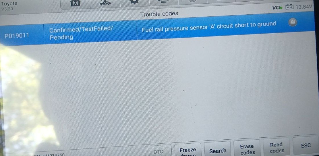

    We swapped out the crank sensor for the original one, and now that code is gone! Also, it idles nice. The remaining code is:
    Not sure what exactly to change or check. Could this be related to the gas now being super old, like 4 months or more and just clogging things up?

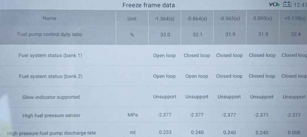

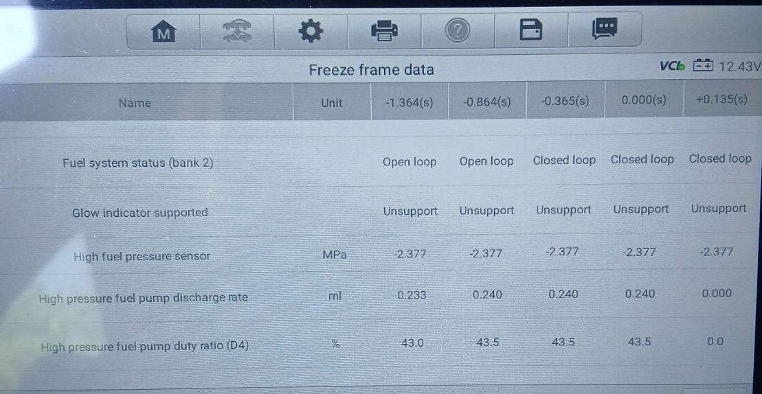

    This is high pressure sensor. Does the error come back after erasing the code? Check wiring at the sensor and ecm. Note that high pressure is displaying -2.377

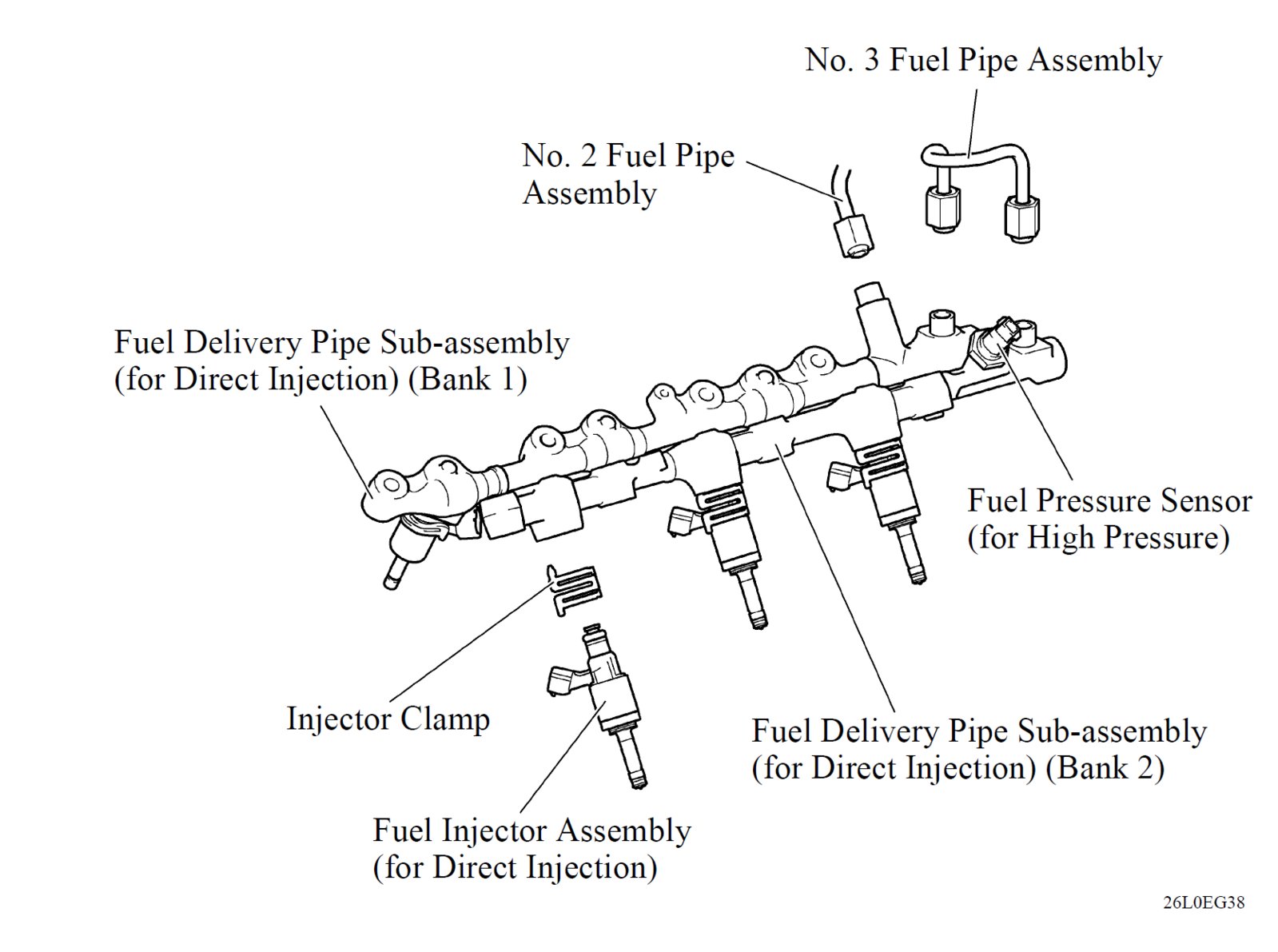

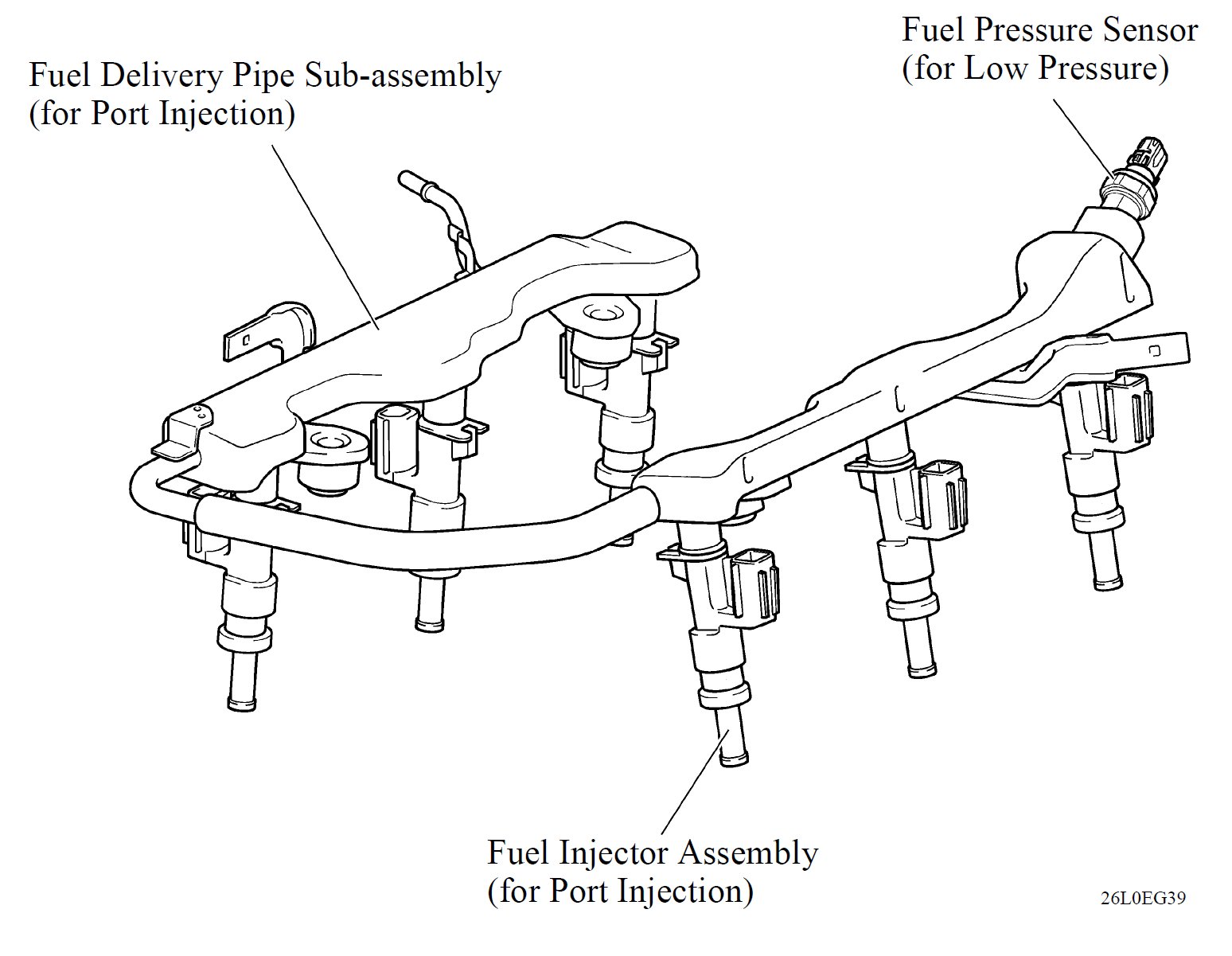

    Looking through giant book trying to figure out which sensor is, we thought it might be this one so swapped it, but no change.
    I found this diagram in the book, so I guess this is the high pressure one or is there more than one?

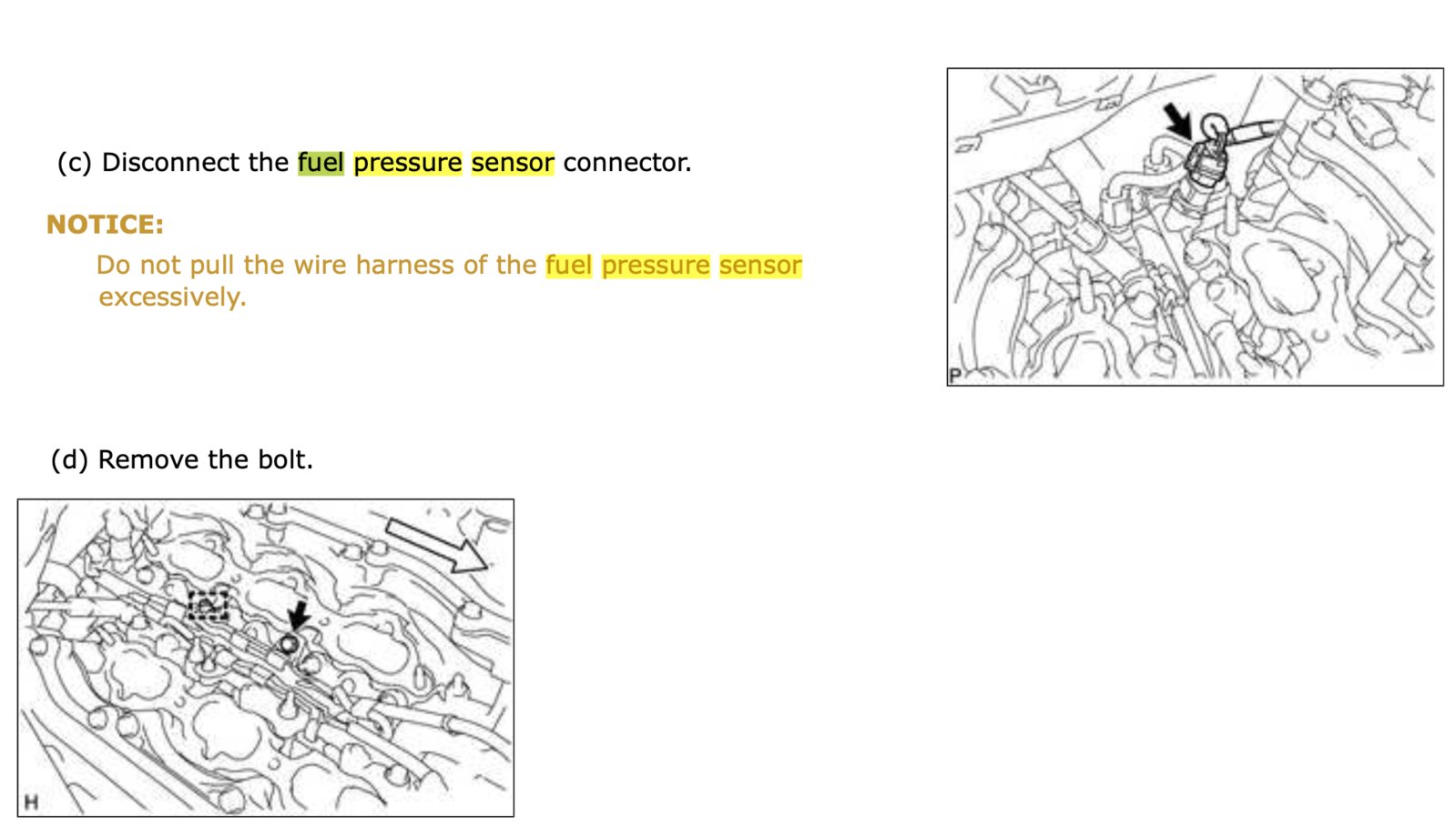

    There is one sensor on the low side and one on the high side on the rails and that is all that I see sensor wise on the fuel system.

    i think you are looking at low pressure sensor (judging by wire colors). High should have Blue. Also note, there is a junction connector for Beige wire (BE).

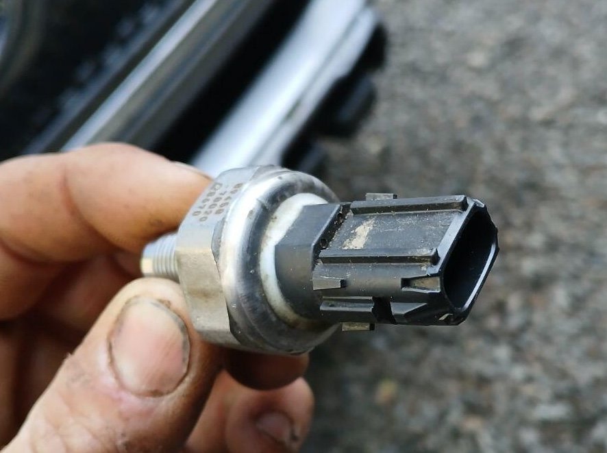

    We swapped the one on top of the end of the fuel rail I think this one:
    Or are we looking at the wrong one? Checking other stuff meanwhile. The truck runs smooth but won't accelerate really above 2000 rpm, otherwise maybe we just drive it around the put a new tank of gas in it, this tank is months old.

    Yeah.
    It may not be the sensor itself, it may be the wiring.

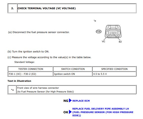

    the wires/pins to this sensor look ok and we get 5 volts there.
    Is there another sensor deep down in the intake somewhere?

    One code left.

    Yeah.
    Check the diagrams above. You are looking for the high-pressure sensor. As Vlady said, the connector you want should have a blue wire.

    that code is on fail-safety list, that's why you cannot accelerate.
    The high-pressure sensor is under intake. So you need to take the intake to inspect connector
