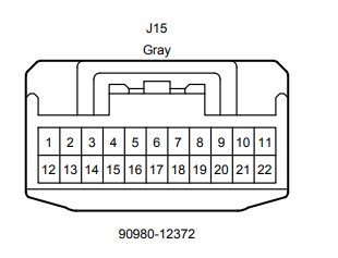

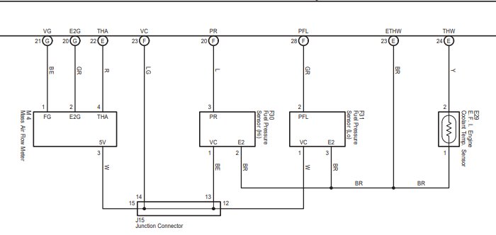

    @silverstr8p.
    this is the junction connector on your picture. The harness with Beige wire(arrow) will lead to High pressure sensor. It is under the intake, in the valley.
    silverstr8p[OP] and jmneill like this.

    @silverstr8p, don't attempt to change high pressure sensor, need to change the entire pipe.

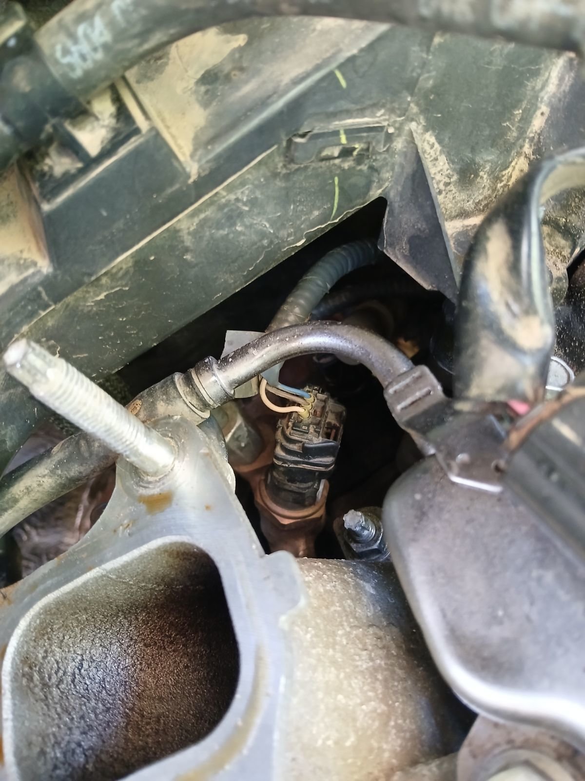

    Torn apart more, is this it? Do I need to replace with new, or just the original motor which was working fine?
  5. May 23, 2024 at 2:04 PM
    #805
    TenBeers
    TenBeers Well-Known Member
    Jun 5, 2009
    #18067
    7,701
    Rich
    Bentonville, AR
    2018 TRD Pro Cavalry Blue
    Yeah.
    Wire colors match the info provided above, so that looks like it. I would test the wire and connectors first, seems like it is shorted somewhere based on the code.

    That's the one. Check voltage between beige and brown wire with key ON per instructions on post 783
    If voltage is good, need to replace the whole assembly

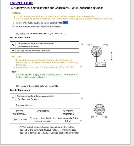

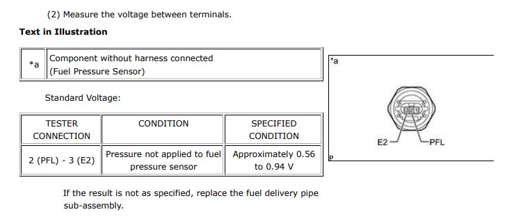

    @silverstr8p,
    Sorry, I have attached lower pressure sensor.
    Here is inspection of High Pressure sensor

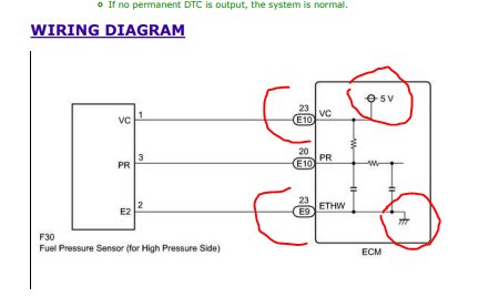

    Issy, WA
    2017 White SR5 DCSB V6 4x4
    @silverstr8p, in case the testing the voltage between pin 1 and pin 2 of the connector does not give ~5V. You need to check the voltage at ECU. Pin 1 and pin 2 are on different ECU connectors. You would need to stick a prob from the back. E10 connector pin 23 provides 5 V, E9 pin 23 provides the ground. If you don't get 5V at ECU, ECU circuit is bad for High pressure sensor. Did you say you could not run on used ECU?
    But, the brown wire is supplying the ground to other sensors, so I would look at that junction connector very closely

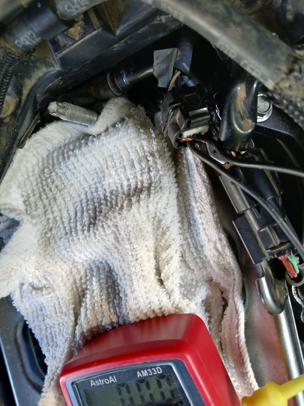

    Pulled connector off and there's no voltage there seemingly:

    I have another ECM, but it didn't seem to work last time we tried it. I'll try to figure out how to test this.

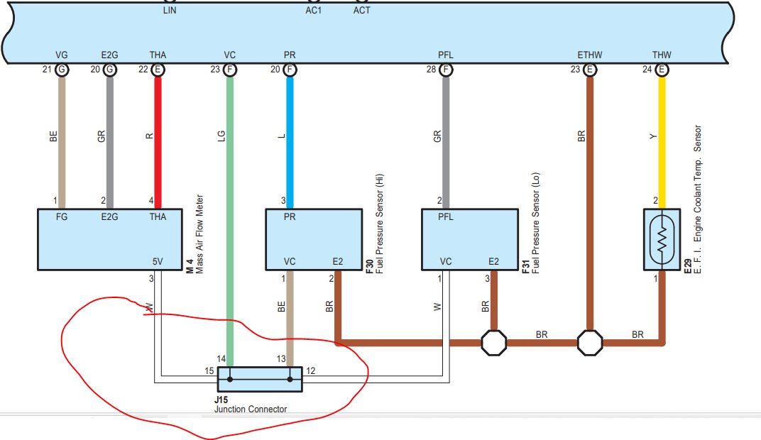

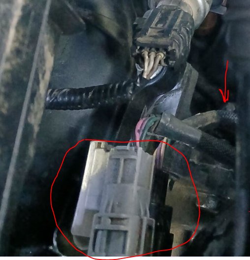

    Find the junction connector with ligh green wire and see if you can test it to the good know ground. I think it is next to lower pressure sensor. Then move to ecu side

    4,602
    Issy, WA

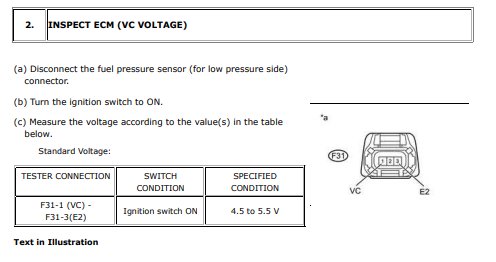

    Is MAF sensor reports numbers in your scanner? Assume yes, cause no errors.
    It yes, the green wire is good from the ecu to that junction connector.
    Or test lower pressure connector. Pin 1 white and pin 3 brown should show 5v with ignition on.
    if you have 5v on lower pressure sensor, you need to trace beige and brown wires from the junction to the HP sensor
    Junction connector picture. Do you see it?

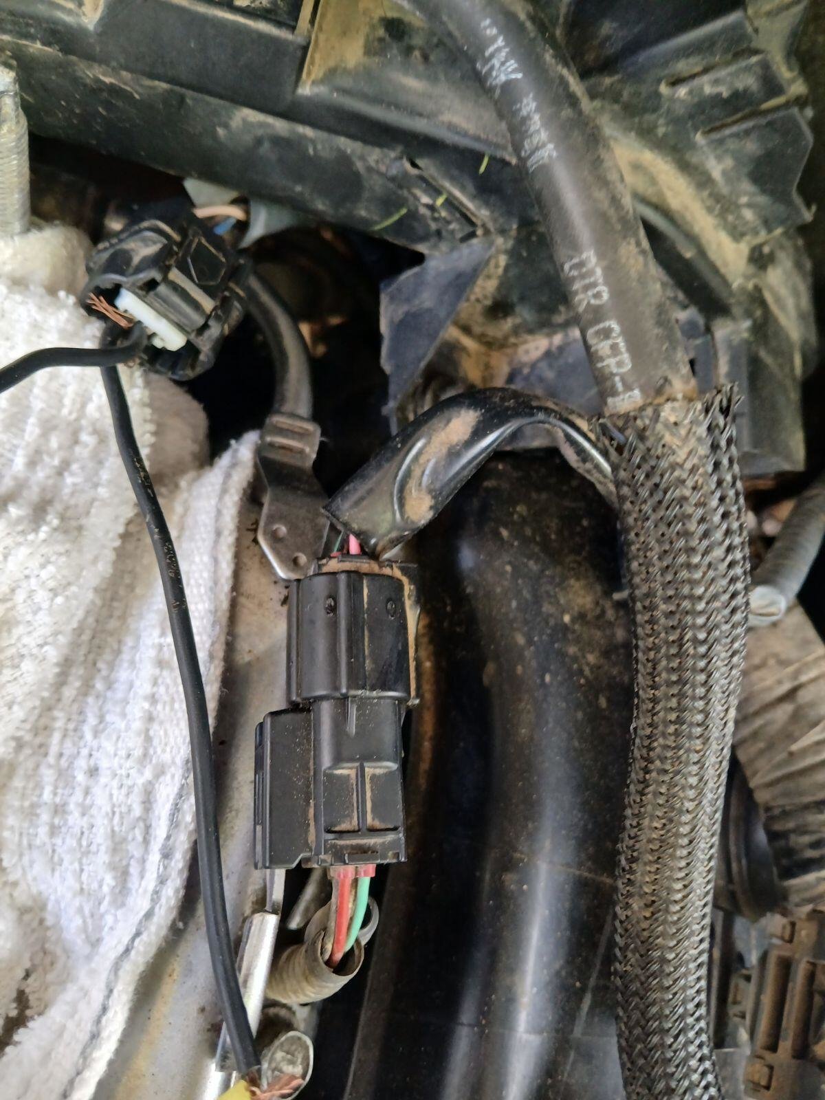

    Each side has these connectors, I wonder if there's a way to get in here and verify voltage?

    Trace beige wire from HP sensor pin 1. See where it goes. I suspect it goes to the firewall plastic jacket.
    Also, test lower pressure sensor connector. If you have 5V-ECU circuit is good.
