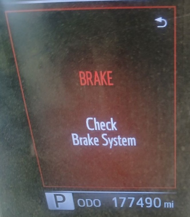

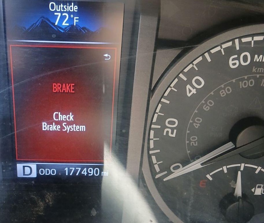

    Still have brake failure error on dash, just says check brake system, but no codes :)
    Is that a function of driving around and hoping it learns? Brakes don't seem to have power brake boost, but they do work.
    Note months of dust settled on dash cluster...

    ABS fuse or something? Likely something simple at this point.

    You have the vacuum booster; with it feeling like there is no brake boost, I would suspect you have a problem with the vacuum pump. You are using the vacuum pump that came on the used engine, and not your old vacuum pump, correct? The vacuum pump is the only thing that should affect brake boost on your model, so that's where I would focus. If you had the electronically operated hydraulic booster, that one builds all it's power from the wiring going to it. But that is only on TRD Off-Road and TRD Pro.
    As for the brake warning, that could be a fuse or something simple, though I don't know why that would have happened while the truck was down. If I recall, the ABS module is hooked to the body/underhood harness, not the engine harness, so I would think the module and the harness it is connected to wasn't ever touched during this whole process.

    Check the brake fluid level switch/connector

    Cleaned the crud off the cluster to see brake warning better. Note the half tank of old crusty gas, will be looking to fill up with new here after we do radiator swap.
    will check this next :)

    Fluid level above sensor on reservoir. All fuses good. Hard like no vacuum booster sometimes. First pump feels more normal. Seems like a vacuum leak really, but then why would that trigger a brake warning?
    Fluid level switch/connector looks fine.

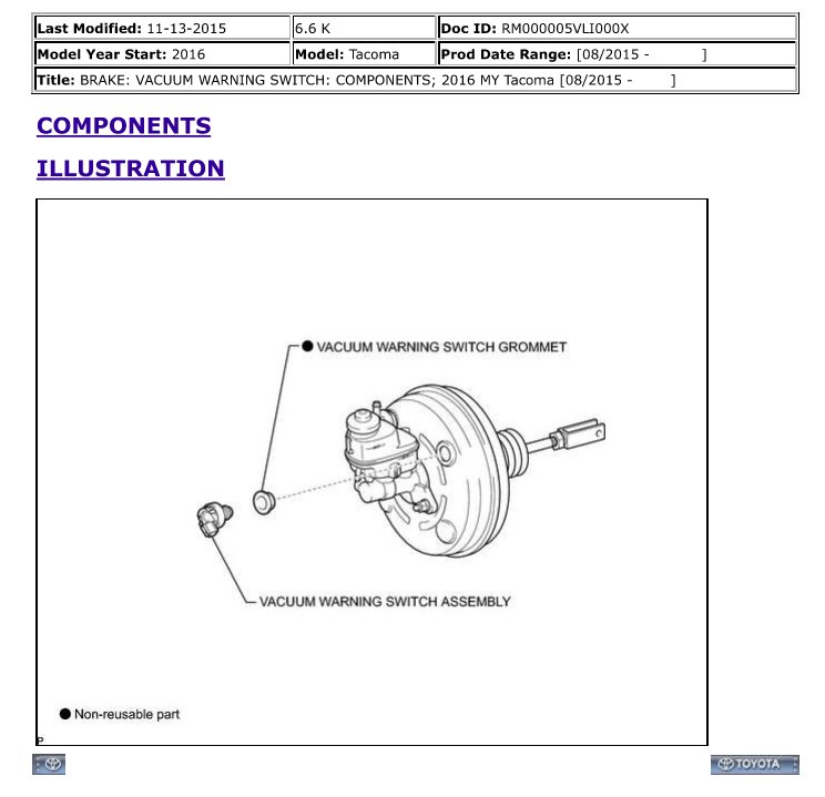

    As far as the "check brake system" warning goes, the FSM only gives advice to check the fluid level switch in the reservoir. However, there is a vacuum warning switch on the vacuum booster. My guess is that is sensing the low vacuum boost and telling the driver info system to give you the warning. The FSM doesn't mention the vacuum warning switch being capable of setting off that warning, but since vacuum is the problem you're having, that would make the most sense.

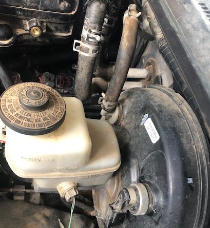

    There is some boost when you first apply brakes, but not so much after that. Here's the brake reservoir setup.
    Wouldn't it seem to be a vacuum leak somewhere? Then again, if the only thing vacuum is doing is going between the vacuum pump (which is still the original pump) and the brake booster diaphragm shown in the picture, where else could it be leaking?

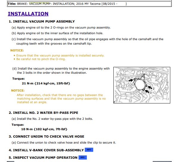

    If it came to you with a pump on it and you swapped that pump for your pump, then the plate isn’t there. I’m not exactly sure how the vacuum pump operates, I know according to the FSM there should be an o-ring or two on the tip of it.

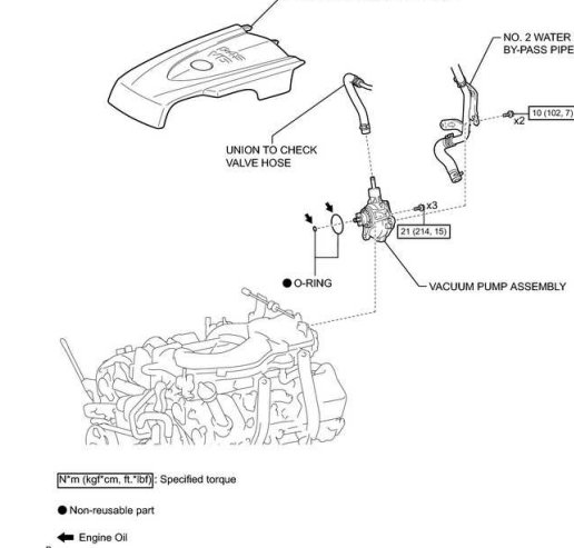

    The pump should generate more than 90 kpa negative pressure @idle. Test it if you have a gauge.
    I bet the o-ring is messed up. Probably order new ones before taking the pump off

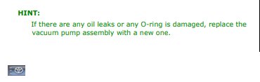

    @silverstr8p ,
    Note that SM states o-rings are not reusable. Check hose as well.
    Also this warning
