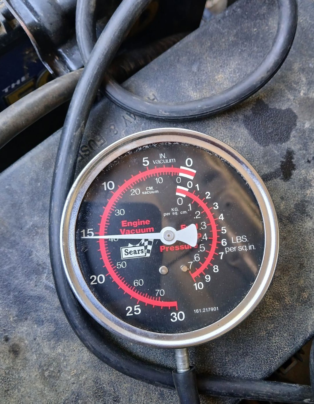

    Here's the vacuum at idle. This truck was manufactured after the recall, so no dice there.
    Is the o-ring some special Toyota o-ring or do we just grab one out of the box of o-rings I have sitting around?

    You should have at least 26.6 in. Hg. Definitely the pump does not produce enough.
    Not sure about o rings. Try to see if it fixes the issue.
    But if the oil made inside the pump, need to replace

    Motor runs. Brakes work after replacing o-ring. And then the transmission started leaking around the torque converter. You can't make this up.
