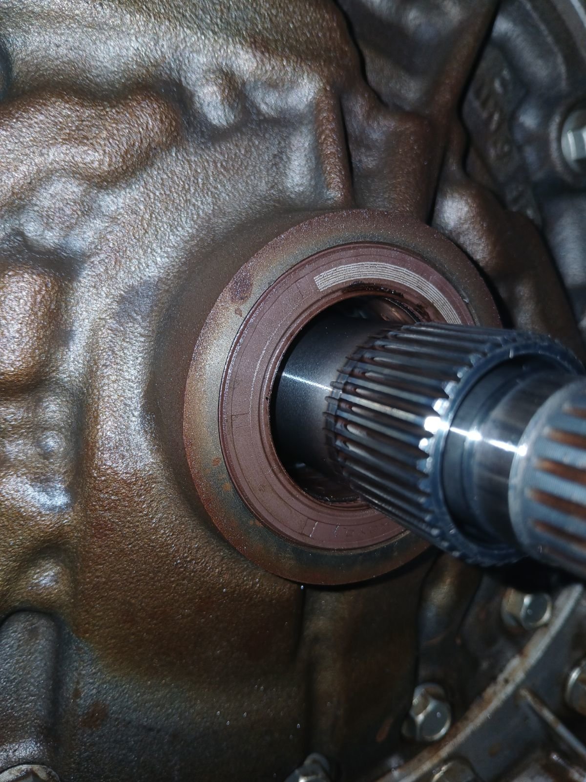

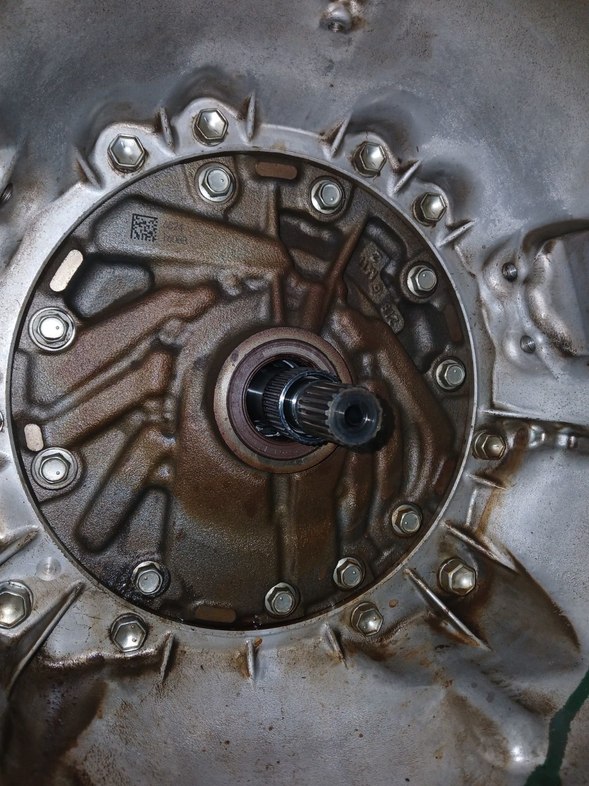

    And so it continues. We replaced the center seal at the oil pump input, which was definitely the leaking thing. Put the thing back together, drove a couple miles and it started leaking again, looks like it took out the seal again.
    Weird thing is the torque converter didn't slide in through the seal very well, which is strange. The surface that slides in looked sort of smooth, but there are tiny ridges on the end, maybe that's what did it, or maybe the torque converter is bent and is now wobbling which took it out? The oil pump it mates to didn't seem to have any play, so suspecting the torque converter is damaged somehow.
    Anyway, we're pulling the tranny to diagnose. Here's the pictures of the end of the tranny once we got it out.

    Yikes..at least the engine is running right though.

    Yeah, I can't tell you how relieved I am that the thing that turns the transmission is indeed turning the transmission :)
    Looks like torque converters are only a couple hundred bucks if that's all it is. I don't quite see why it would be bad though, the tranny shifts just great through all the gears, no sign of failures at all, just leaks again.

    You may also want to make sure your flex plate is true.

    The flex plate and torque converter didn't have any wobble in them when truck was running, looking through the hole and just watching them. I heard that we'd need to replace the oil pump, some kind of carrier bearing, seals and torque converter, which sounds like I'll have another parts bill (don't know how much) to put into an old transmission, and maybe we're doing something wrong and it wouldn't work still for some reason.
