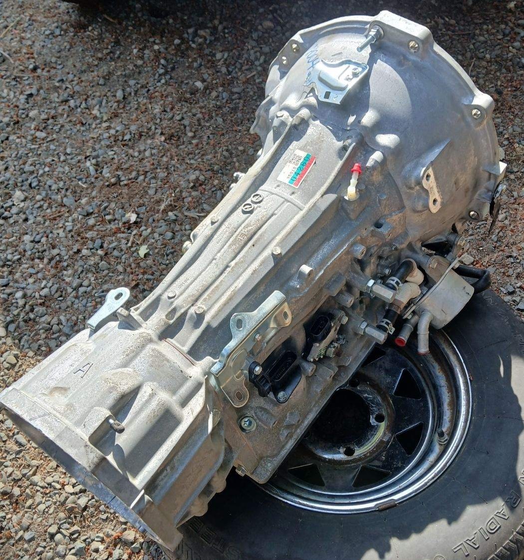

    Ok, here's the new (to me) 2020 tranny with 15K miles on it. It's shiny, must not have have ever been off the pavement. We should change that :)
    Hope to have it swapped in the next couple days.

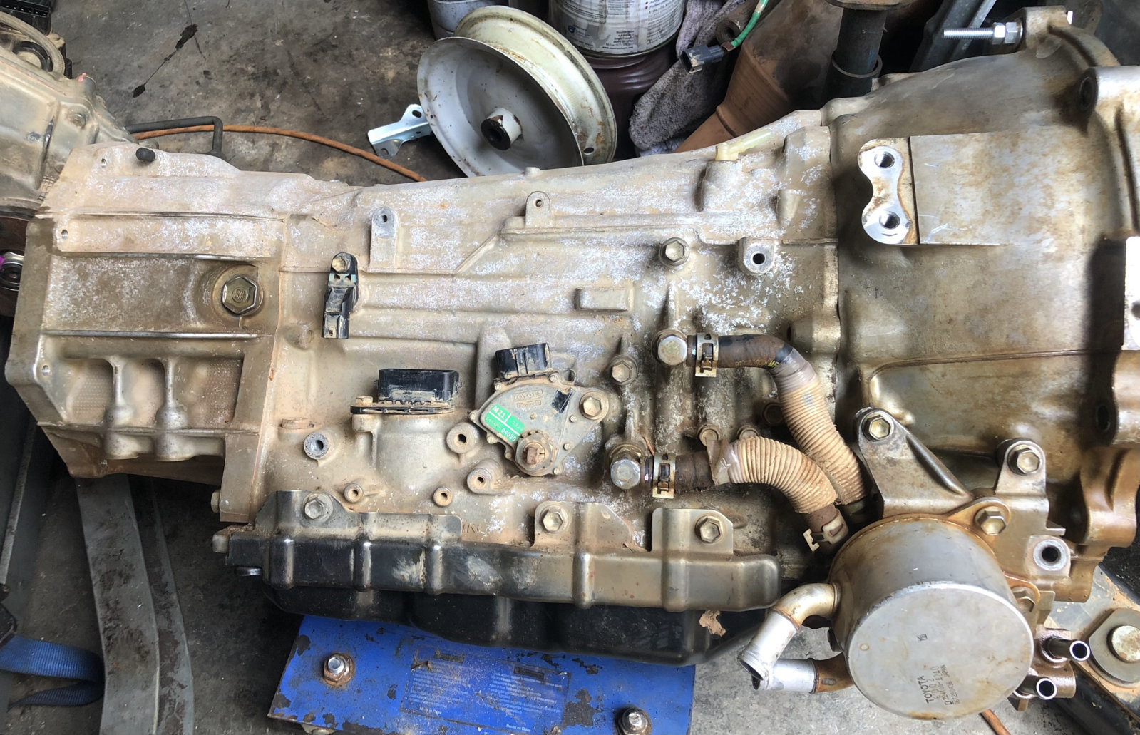

    The torque converter slides right out smoothly on this one. On the old one it's hard to slide in and out, so something must be going on with the oil pump or something not nice.
    I plan to try to see if my Autel scanner has a relearn function for this unit. The interchange supposedly said it will fit and work. I sure hope so. Anything else I should watch out for?

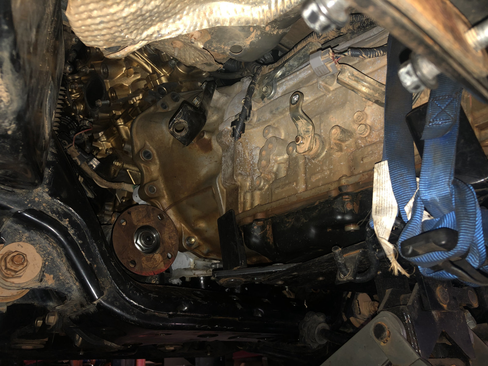

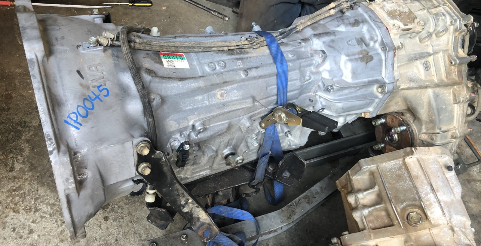

    got transfer case swapped, rollin' her back under the truck and boltin' her up :)
    Here's what is looked like while we were pulling it out:
    Here's the old one:
