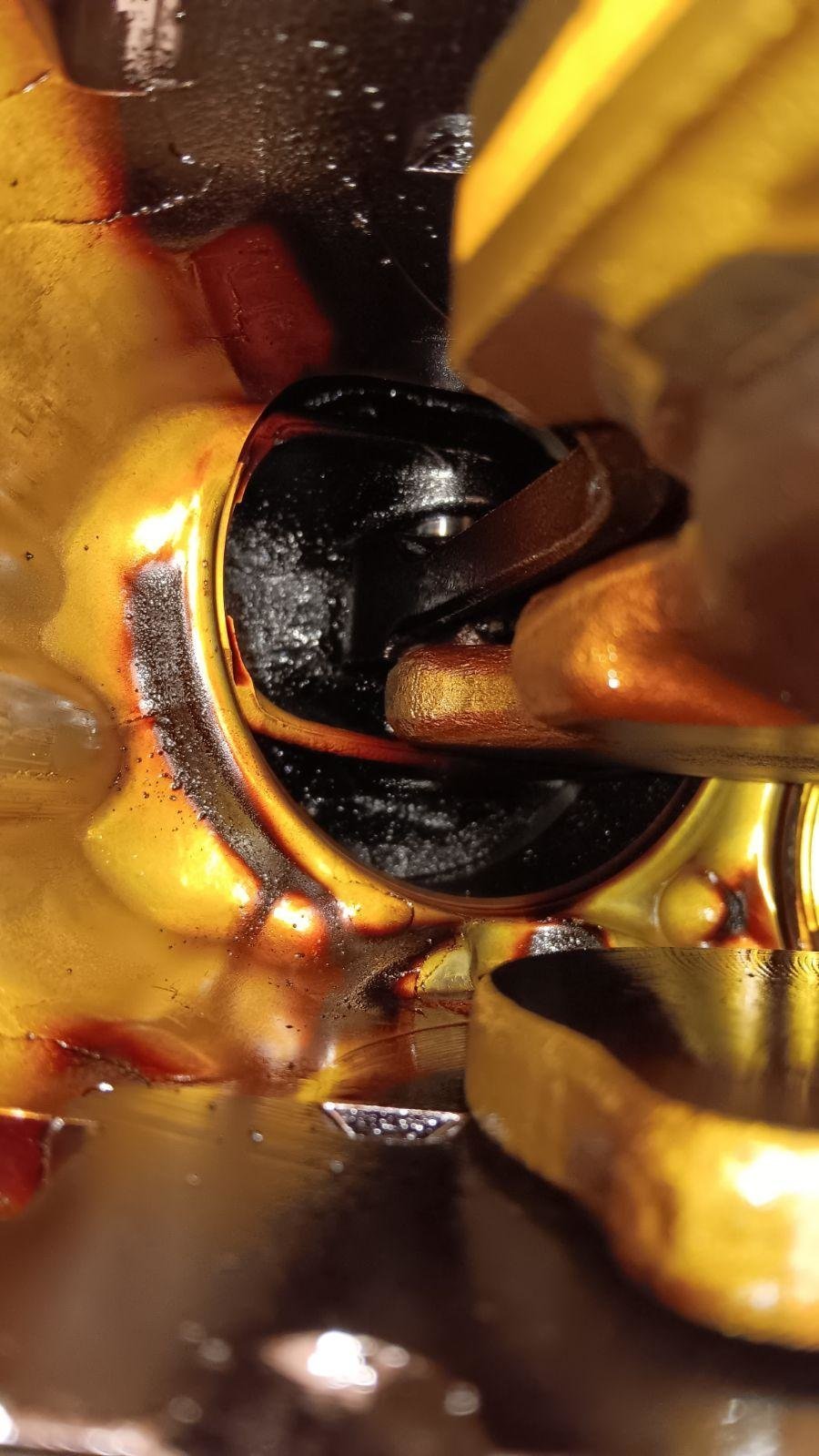

    This thread has been very informative. Definitely sticking with 5k OCI after seeing those internal photos...

    2023 Tacoma SR
    The top left looks like some serious cracking however I can't tell where/orientation of this photo.

  9. Jan 4, 2024 at 1:04 PM
    #89
    Vlady
    Vlady Well-Known Member
    Dec 20, 2017
    #238986
    4,546
    Issy, WA
    2017 White SR5 DCSB V6 4x4
    Those are casting marks
    Barsoom, stu8319, winkel and 6 others like this.

    Everyone is focused on the oil but this jumped out at me.
    Over rev? That engine needs to be turning at 4000-4500 rpm to be in its power band. It won't hurt a thing for rpms to be that high when towing. In fact if you're trying to stay in high gears and do it at 3000-3500 rpm you will overstress and overheat the engine. That oil looks to me like it has gotten way too hot rather than staying in the engine too long.
  18. Jan 4, 2024 at 3:26 PM
    #98
    TnShooter
    TnShooter The TacomaWorld Stray
    Sep 2, 2010
    #42625
    21,135
    Deogee
    07' TRD Off-Road, Auto
    STOCK
    The pictures show an Automatic Transmission.
    If the logic of the Auto allows the truck to lug that bad, something is “wrong”.
    While it does look like things got “hot” to some degree.
    I don’t think it was due to lugging. The transmission should have given out before the engine if it was a towing issue.
