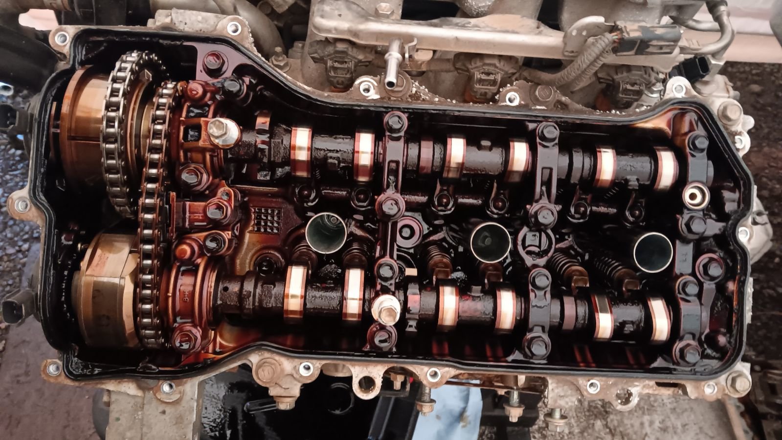

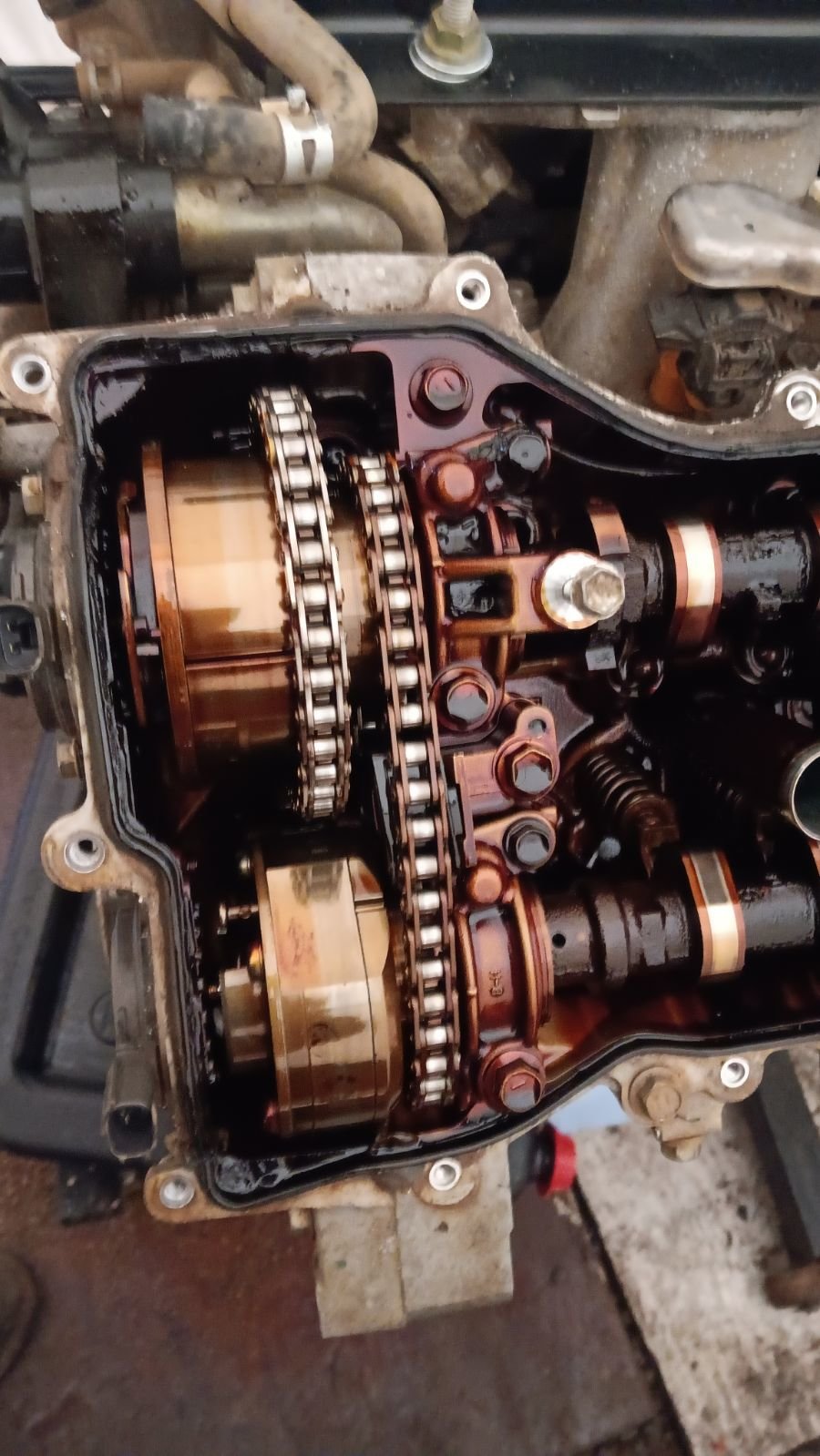

    top end. Cam lobes look fine, don't see any galling or some such. Some black deposits on the right end of the cams.
    zoomed in on cam chain area.
    Still have a question mark about a ~50K donor motor, wouldn't have any idea what it's history would have been, maybe the guy who wrecked the donor hammered it daily?
    Does anyone have a high mileage 3.5 Taco motor, how long should they last?
    Also wonder about parts availability from Toyota.

    Maybe.
    In reality though, how many 3rd gen Tacoma owners really dog their truck?
    1 in 500? 1 in 1,000? It can't be many, the vehicle just doesn't fit the profile.

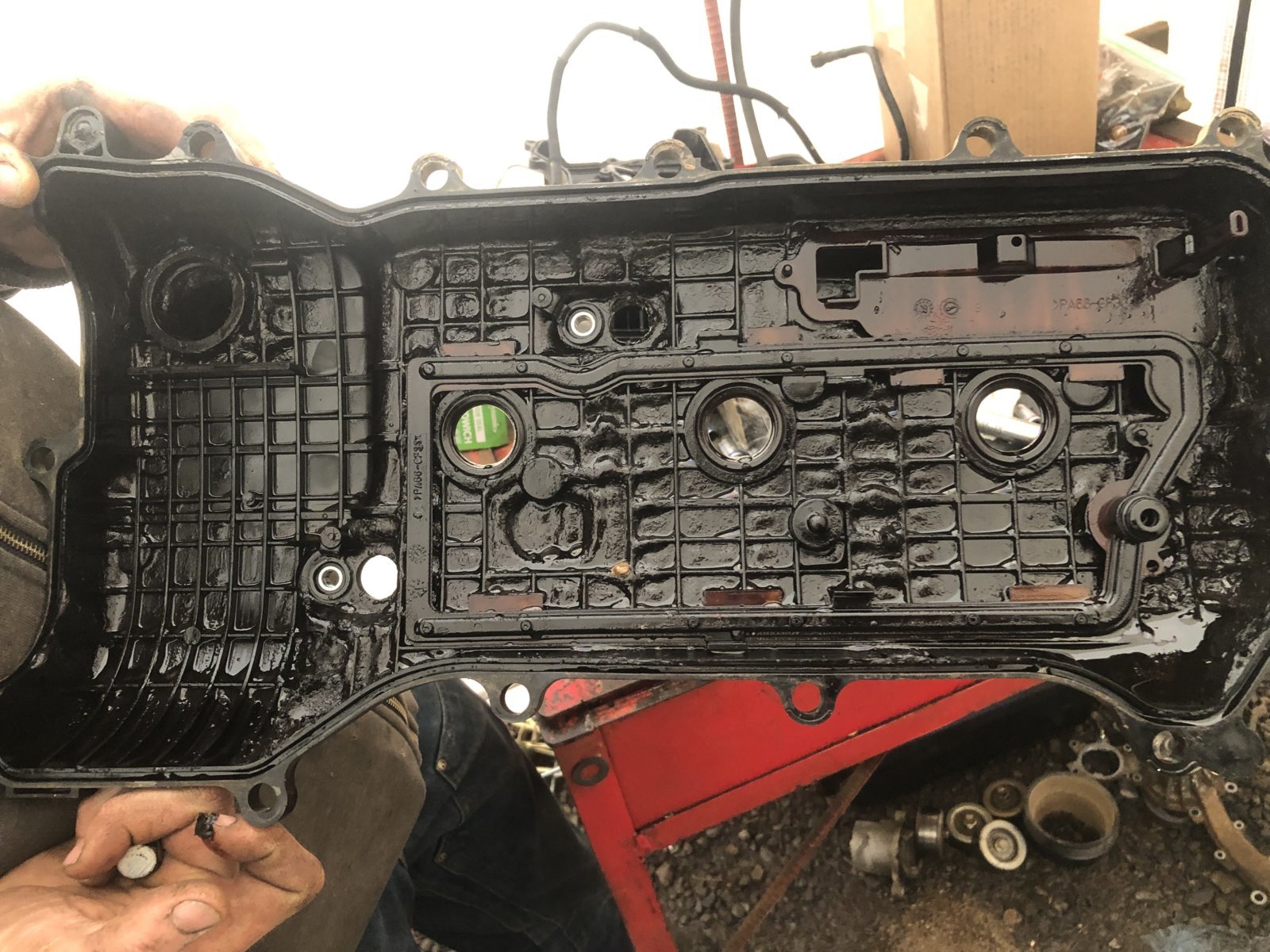

    Okay, here is the valve cover, there's some sludge under there:

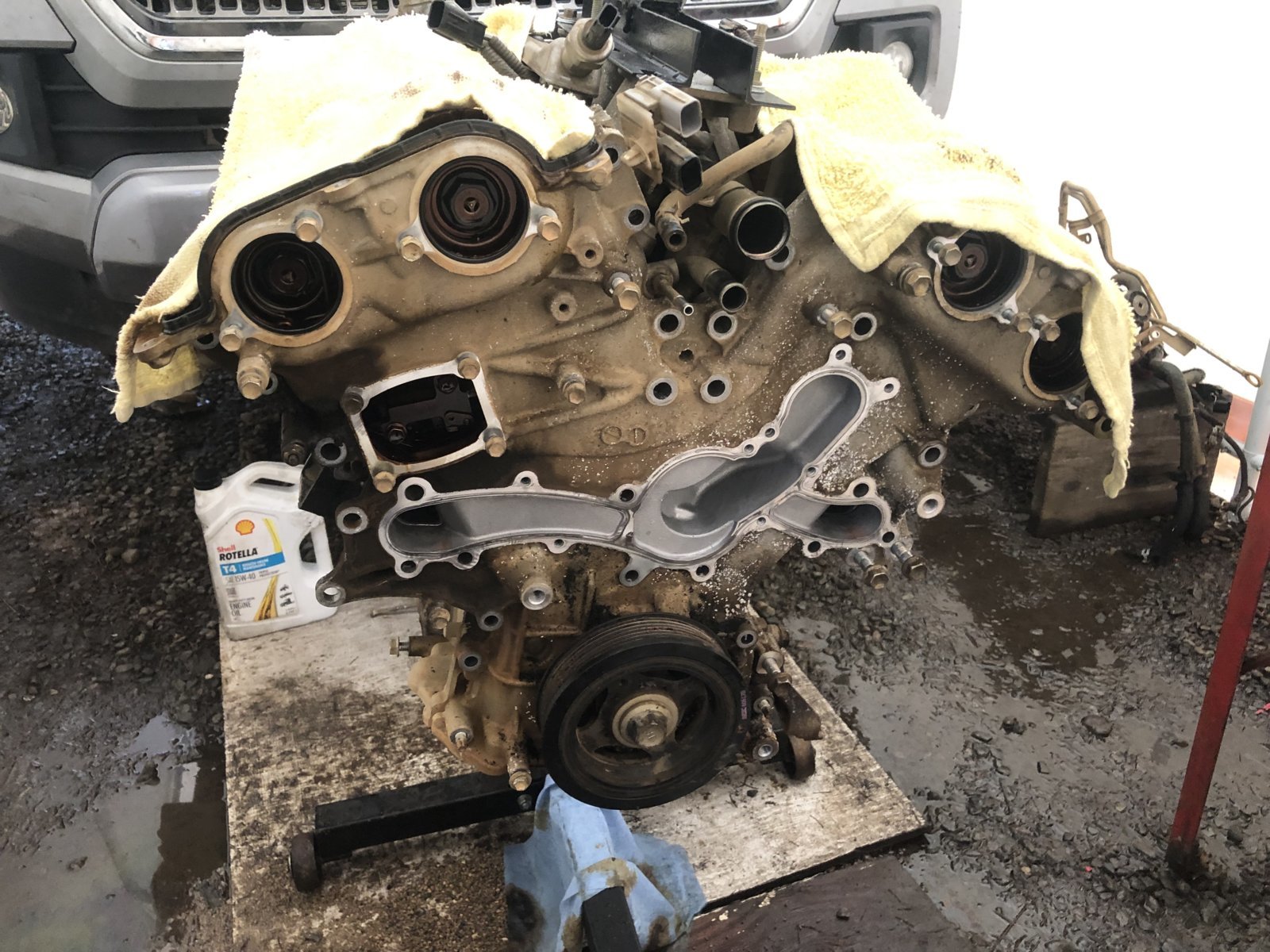

    Here's the timing chain cover, we're trying to pull off the harmonic balancer, and it's reeeeeeeally stuck on there, had to build a tool using a piece of angle bolted where the ring gear is to hold it from spinning.
    Soon we'll be able to take a look at the oil pump and then pull the crank. I see the engines you can get with 50K miles are about $5-7K! Yikes.
    A mechanic friend suggested I pull the heads since a rod knocking would apply extra pressure and heat potentially to that cylinder, we'll see how it goes. I think basically at that point it's kind of a total rebuild, but thus far I haven't seen anything that suggested bad wear, we'll see when it comes apart further.

    Thanks for posting these pics. As far as the valve covers are concerned, the drapes don't match the carpets here with respect to the synthetic oil change intervals you specified in the posts. It's not as bad as I would expect, but it should be cleaner if they really poured in a quality full-synthetic oil every 5,000 miles unless you were beating it under continuous severe use. (ie: Cop car or taxi) But something is wrong: the facts you documented as far as oil changes (note: I believe you! :thumbsup:) aren't in synch with the pics.
    It would be interesting to see a picture of the PCV, as for me the condition of that simple part is a window into the actual beating heart of the engine. It lives a miserable life. It never looks perfect, but if it's "not bad" it tells you everything about the oil change intervals, even at 115,000 miles like mine when I changed it: documented 5,000 oil and filter changes (and types: about 50/50 synthetic and conventional with OEM filters. YMMV

    I don't think the 5k oil change interval was used on the truck in question here.

    I've seen insides on 10 oci, nowhere near this.

    Ask one of the dealer techs or lube guys specifically for some of their bulk oil then do an oil analysis on it. Curious what they're actually using. So far it appears the cause of failure is inadequate oil quality
