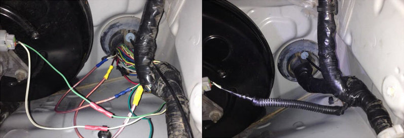

    How many wires were cut?
    That nest I posted above, the squirrel cut about 6 or 7 wires. I just soldered in wire to connect the matching colors, heat shrinked it, and re-loomed it.
    The left pic was just my ghetto-fab job so I could get to work. On the right is after I got home and fixed it.
