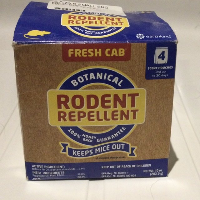

    You will also want to check your cabin filter, mice like to crawl in through the fresh air vent and build nests on top of it. There are a couple posts on a mod to keep them out.
    I’ve had good success keeping mice and rats out of my cars by keeping one or two of these pouches wedged next to the battery
    DirtTaco[QUOTED][OP] likes this.
