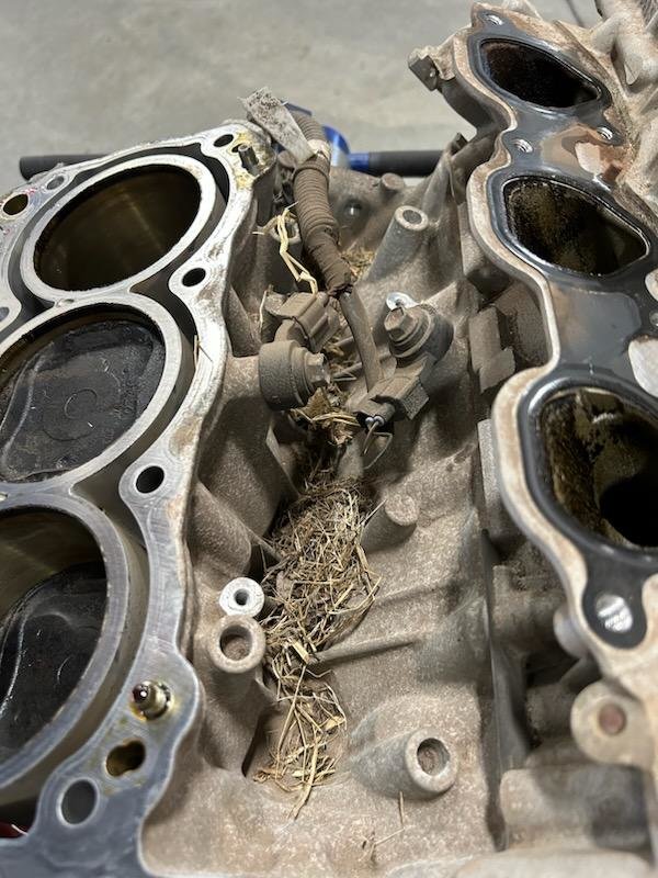

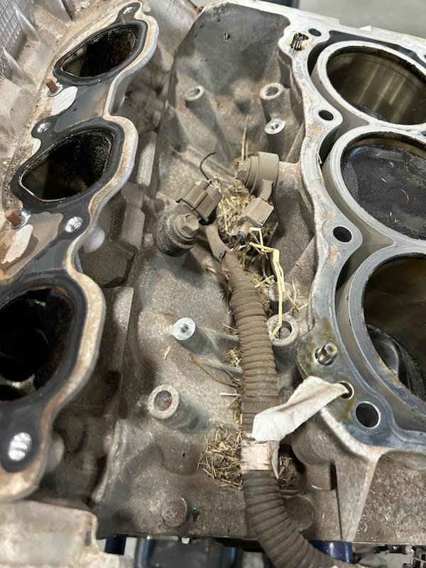

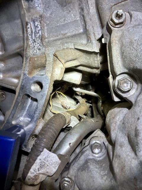

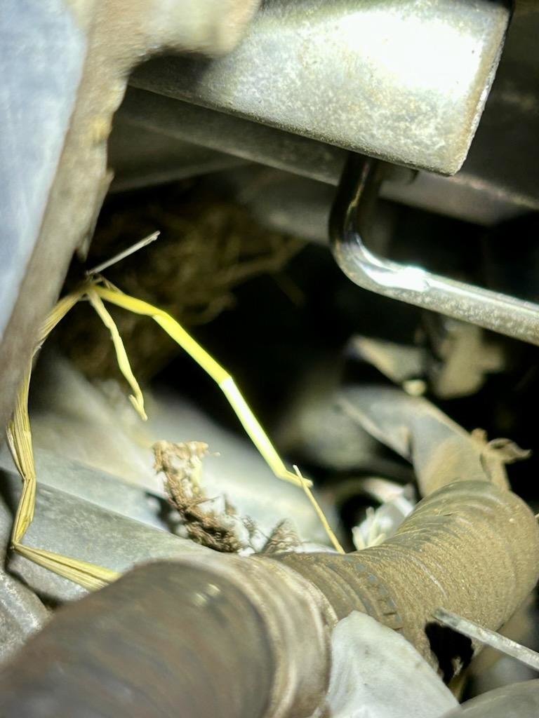

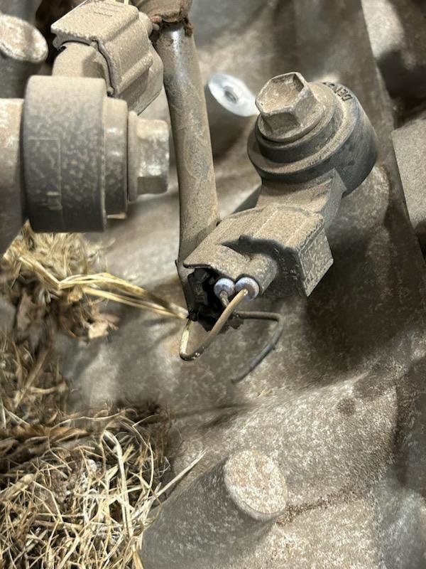

    I got the knock sensor code after my truck was parked in the mountains for ~2 weeks. I was horrified to find a packrat had nested in near the engine. I was even more horrified to learn of the 20+ hours labor to replace the wiring harness, as is necessary to access on 2nd gen Tacomas. Heads had to be removed, engine taken out, etc. to access it. Lucky that comprehensive insurance covered it, but was a hassle to deal with and my truck was in the shop for three weeks.
    I do not want to experience this again. How to keep rodents out of the engine area? What strategies are people using?

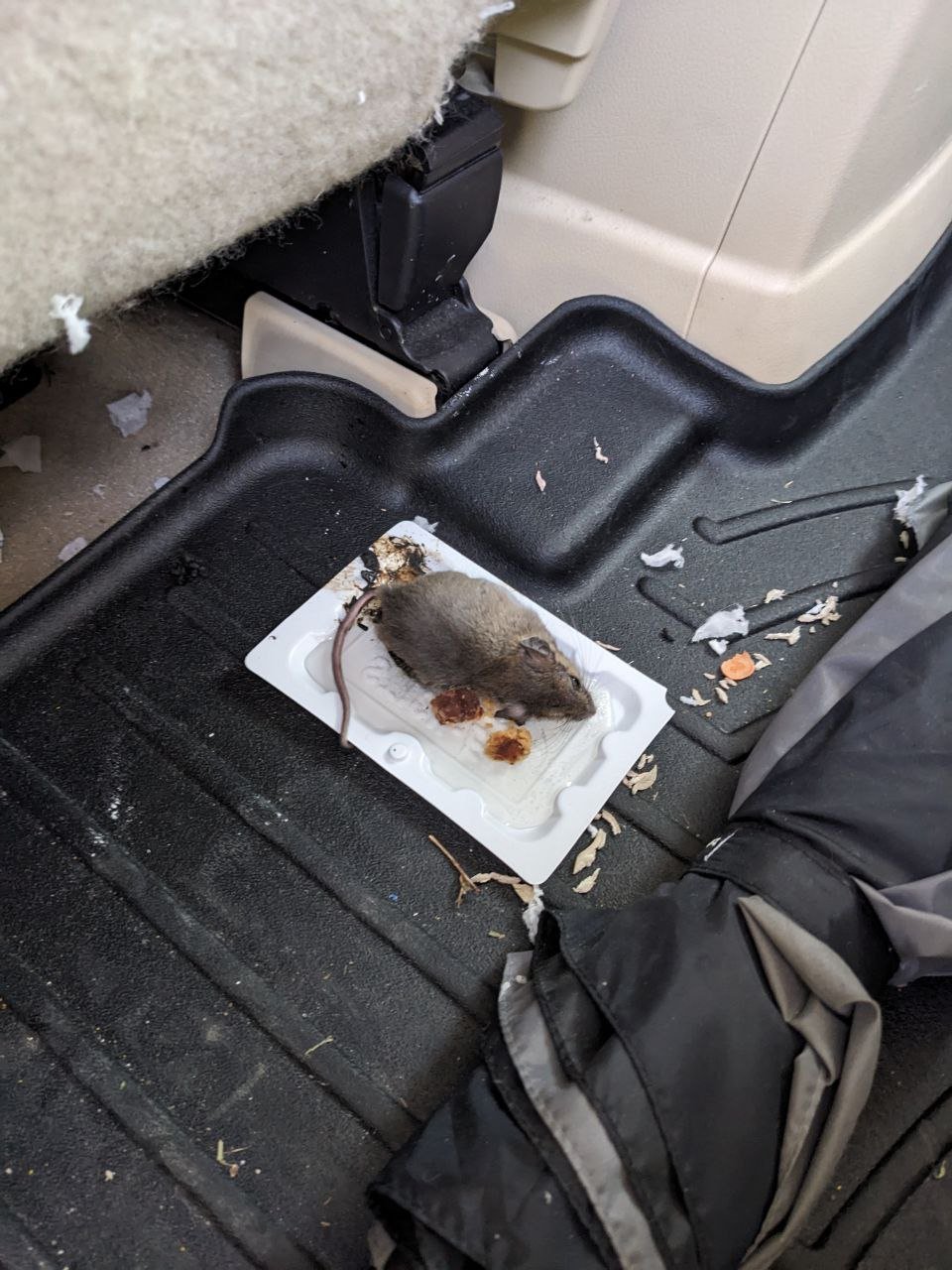

  10. Sep 19, 2023 at 12:58 PM
    deanosaurus
    deanosaurus Caveman
    Jul 23, 2018
    #260241
    2,158
    Northeast Region
    09 TRD OR AC

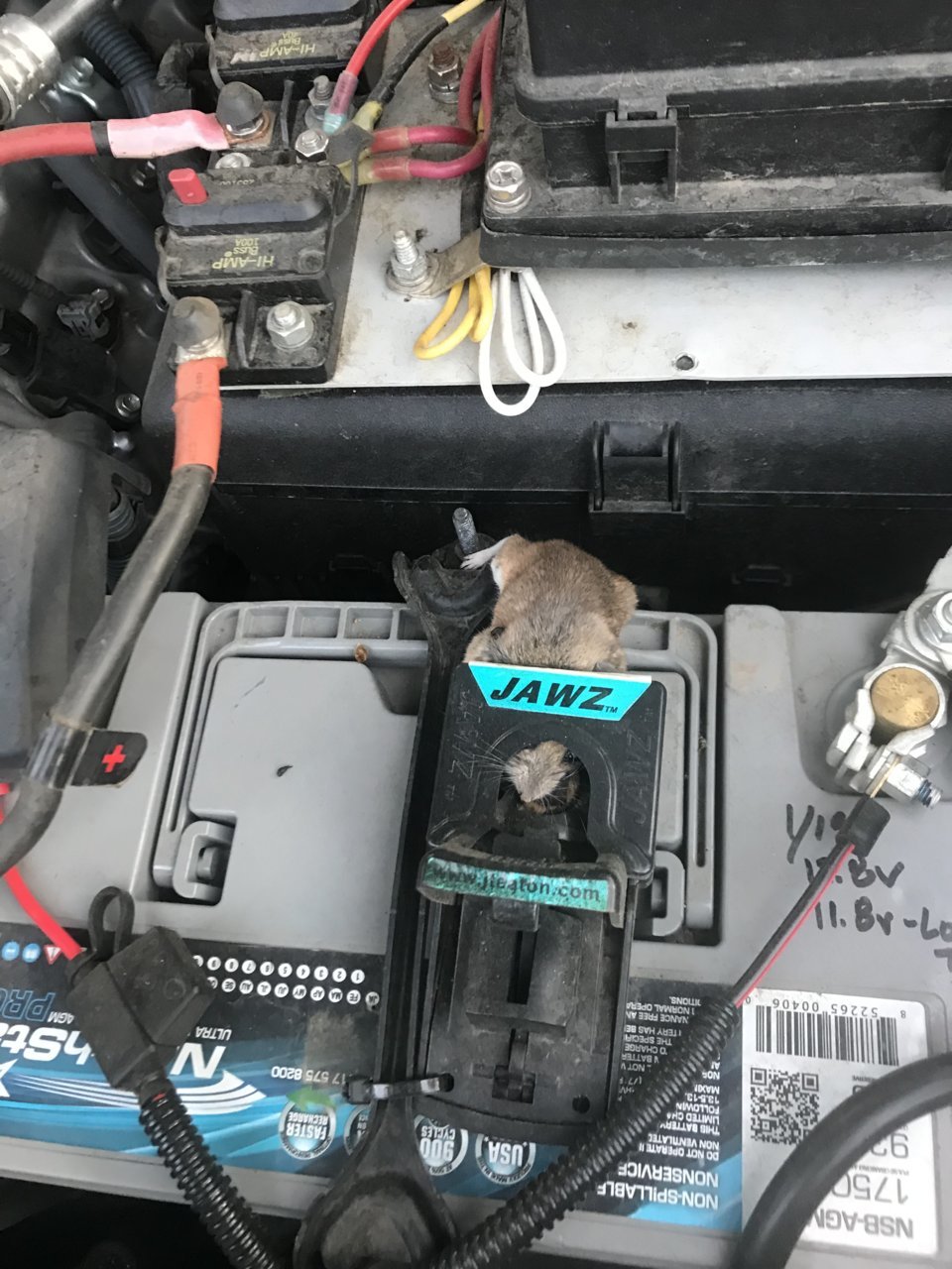

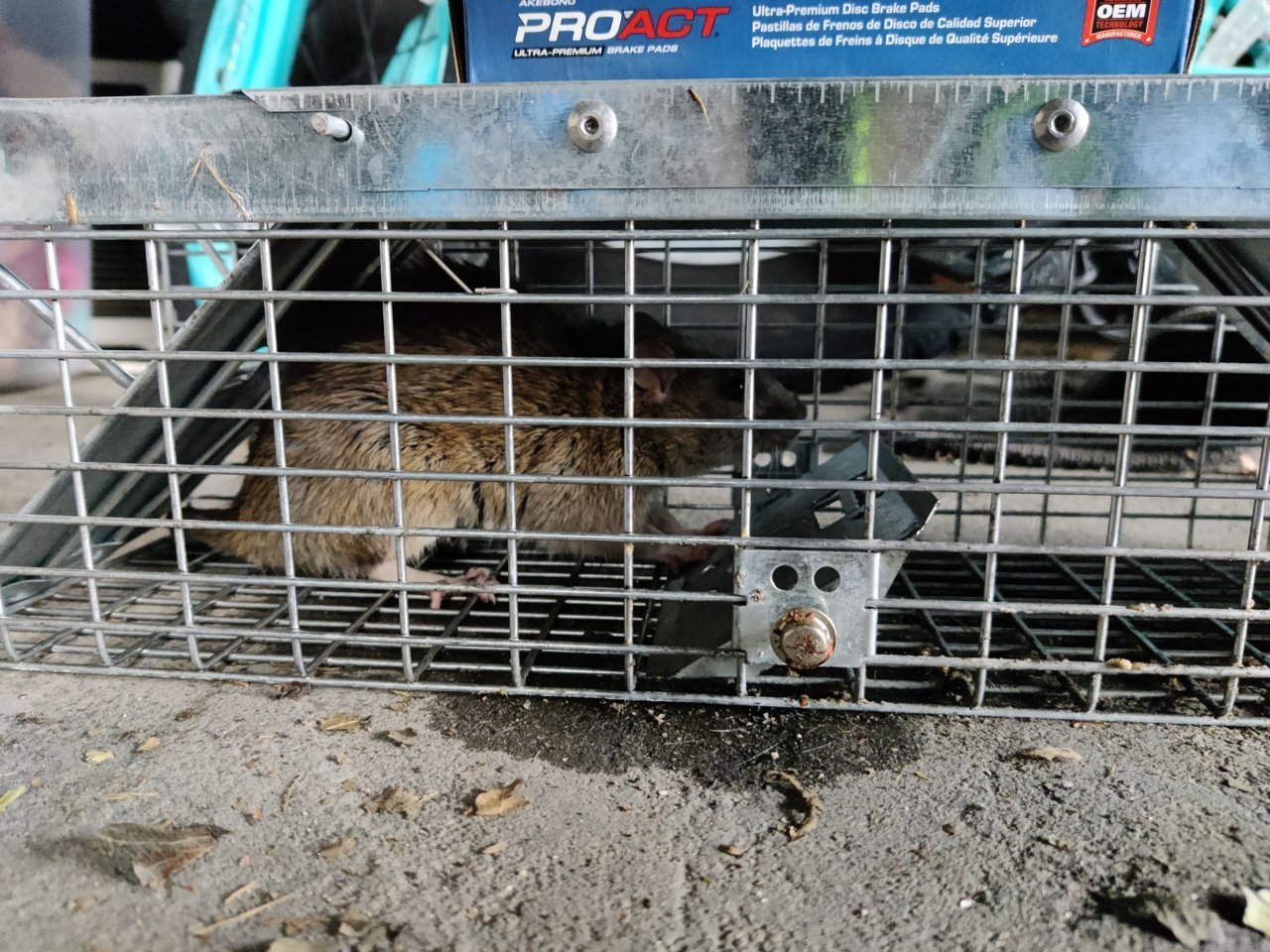

    I was successful with peanut butter and a cage type trap. I had to catch him twice though because I think he flipped the cage over the first time and escaped. Second time I put something heavy on top. He was living in my garage and with the cold weather, I was worried he eventually make his way into my warm engine bay.
