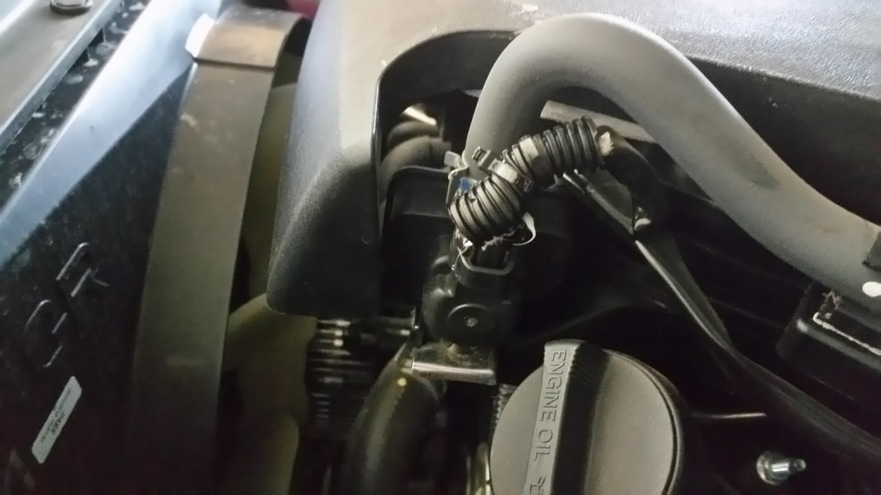

    OK, been through this living in the mtns, going to Mexico etc.
    Often they eat through the wiring-usually where individual wires are exposed leaving the cable cover, before entering a seal on a plug.
    Sometimes after starting to chew an exposed wire, they may go into the cable.
    To Repair chewed wire: Don't use cheesy crimp connectors-they corrode internally and cause more grief later.
    Open the cable wrap carefully to expose a bit more wire if needed.
    Slide on some marine shrink tube- 2 layers best- a thinner and thicker, solder a new wire section in, slide shrink tube over it and heat the shrink tube.
    If you aren't comfortable soldering, find someone who is. A small 50 W iron is enough for most small wires.
    I went through this on first Gen. a ling time ago. A pic from 3rd gen: 20180128_170328.jpg
    First, I sealed the exposed wires at cable ends in a blob of silicone- or RTV, which stabilizes them re vibration.
    It also doesn't seem to get eaten by animals.
    Next I put a piece of corrugated cable wrap over the cable, exposed wires-now covered in silicone, and the plug on cable end.
    A zip tie or 2 goes over the cable wrap.
    A new development by Honda, is a tape to resist rodents, looks good if it resists heat in engine compartments:
    https://www.ebay.com/i/201898955520?chn=ps
    Pack rats, and ground squirrels are some of the worst problem around here.
    On the 3rd Gens, there are a hell of a lot of these connections ! Esp underneath, at transfer case, diff, everywhere.
    It will take a while, to find and wrap them all.
    However, as my mechanic buddy says, on electronic vehicles, If this happens you be walkin. Many of us go where it would be a loooong walk.
    I have used moth balls in a mesh sack hung from different places to repel rodents, but they are pretty obnoxious and must not get near any fresh air intakes.
    Some sprinkle them on the ground when parking at trailheads. Others bring a roll of chicken wire to make a fence around the truck.
    The Cayenne sounds better. Maybe you could mix it into a spray bottle and spray onto wiring VERY CAREFULLY wearing goggles- it's the equivalent of bear spray!
    Since doing the silicone and cable cover wrap of all exposed wires on a 1st gen, and now a 3 rd gen, I've had no problems, parked outside.
    This is free advice, I take no responsibility. YMMV
