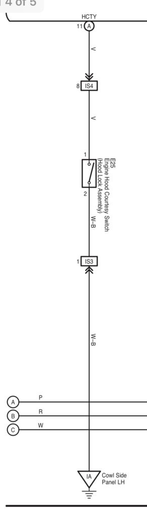

    The hood circuit can be disabled by grounding the hood alert wire. The mouse chewing the wire opened the circuit which is what tells the dash that the hood is open. Find that wire and ground it and you’ll bypass the hood open alarm. The violet wire.
