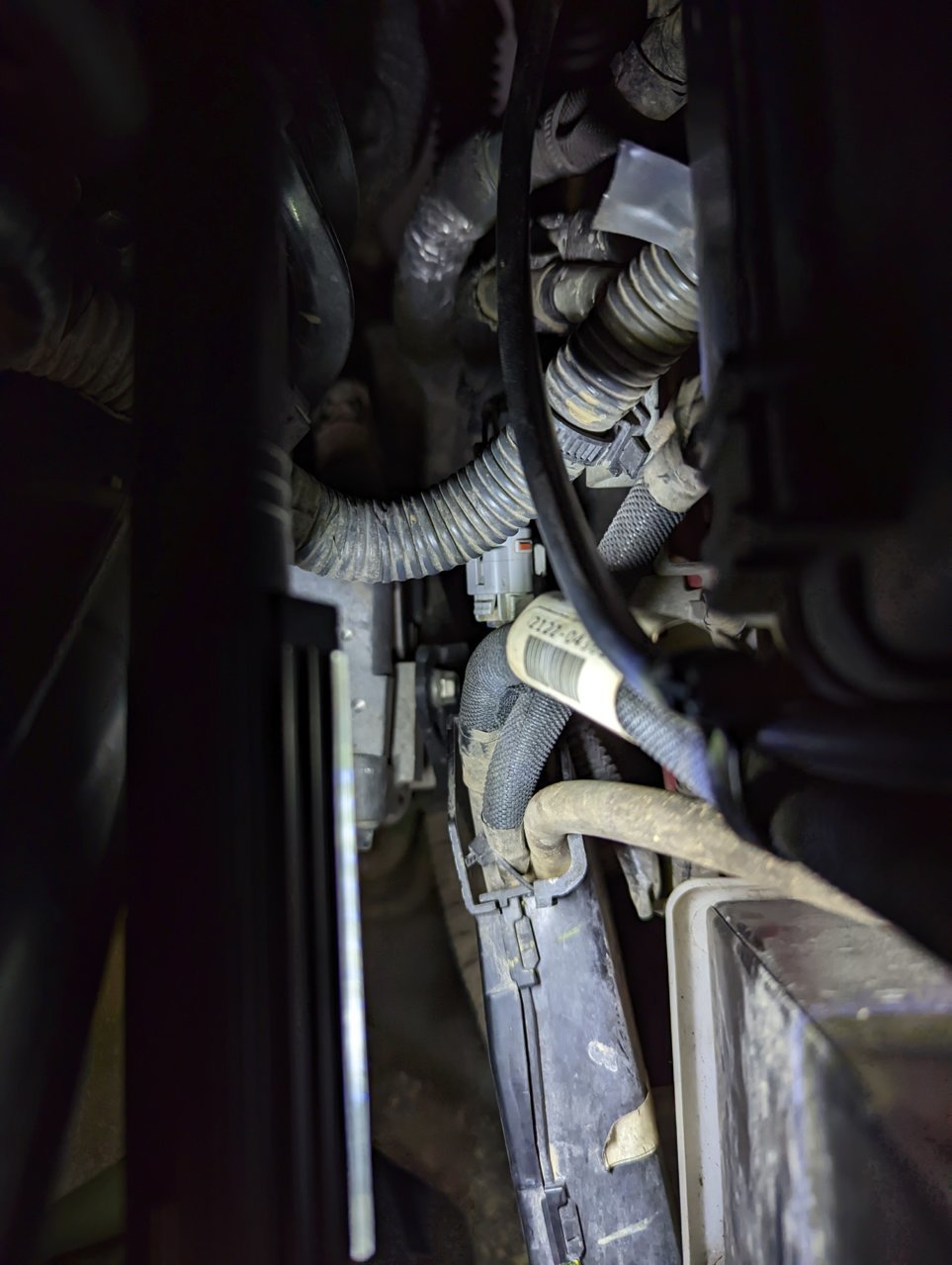

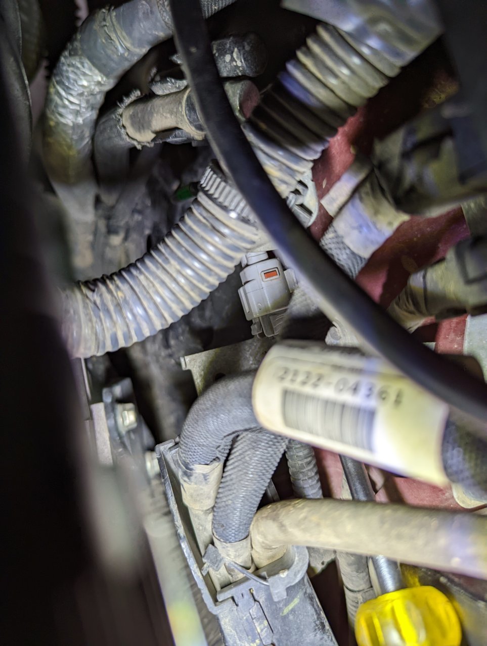

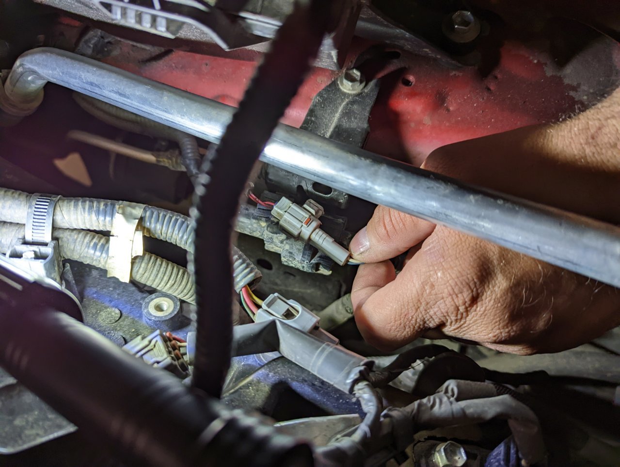

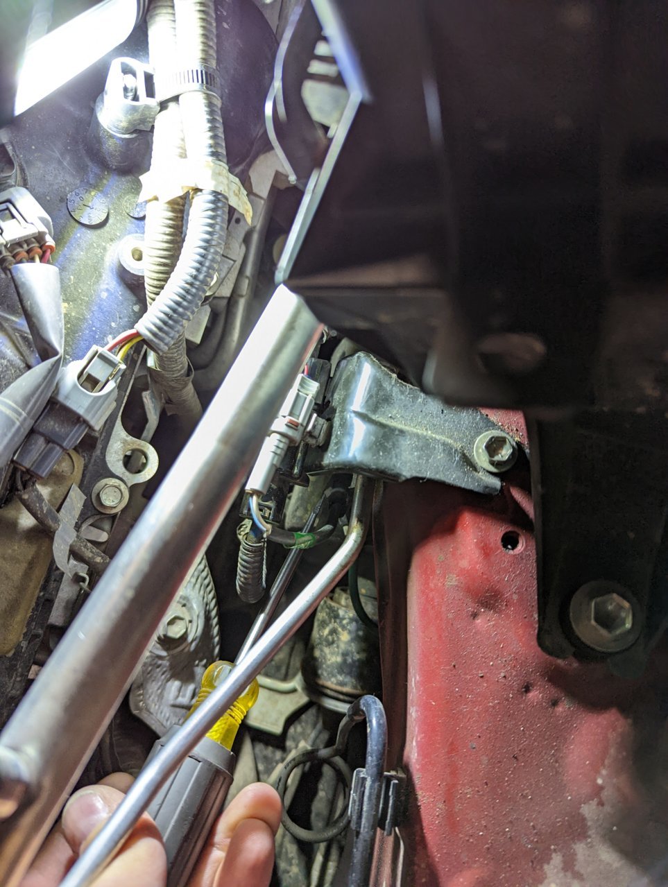

  14. Sep 11, 2022 at 8:50 AM
    #234
    tonered
    tonered [OP] bartheloni
    Sep 25, 2017
    #231055
    31,264
    tony
    Lynnwood, WA
    Pics of the ABS harness connector.
    Left Side:
    There is enough slack after just removing the connector from the support and slipping it down past the bracket.
    Right Side:
    Removing the connector from the bracket and removing the harness support from the coilover mount (10mm) is recommended. You'll have to feel for the screw.
    Abject4x4 likes this.
