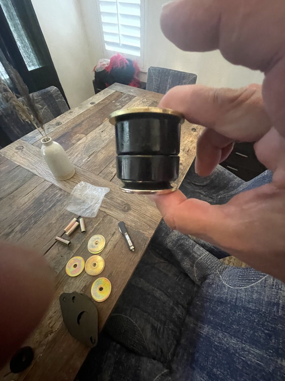

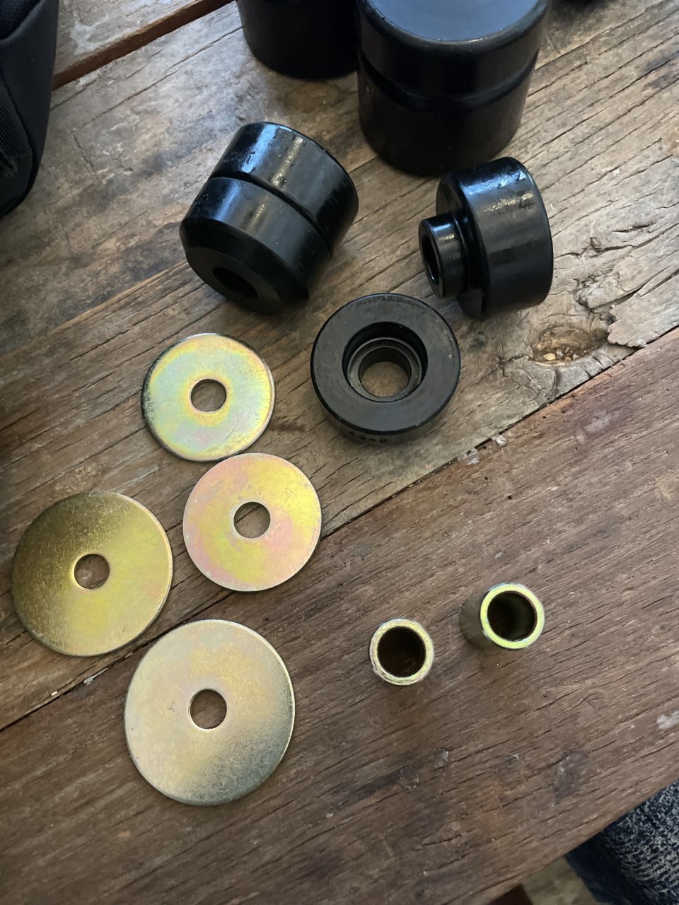

    Can't thank daveeasa enough for giving me his set from round 1 of the group buy, while he waits for me to replace them with the ones I'm snagging in round 2. Also, thanks to tonered for shipping them out to me quickly!
    I'm About to do the front bushings, but I noticed for the small front bushings there are 2 different size washers. Which goes on top of the bushingC517C64A-F95F-49BB-8A45-BBAB9C64810F.jpg 50CA580C-FD25-437F-9494-E9E8EF4E6759.jpg 914A176C-1611-4A27-8D1E-9007D4D7BE71.jpg 923F7366-C524-4D48-A0CB-63E710376473.jpg

    From the video on Energy's website (linked in the 1st post) it looks like for the front bushings, the larger of the two sizes goes on top, just like in my last photo above

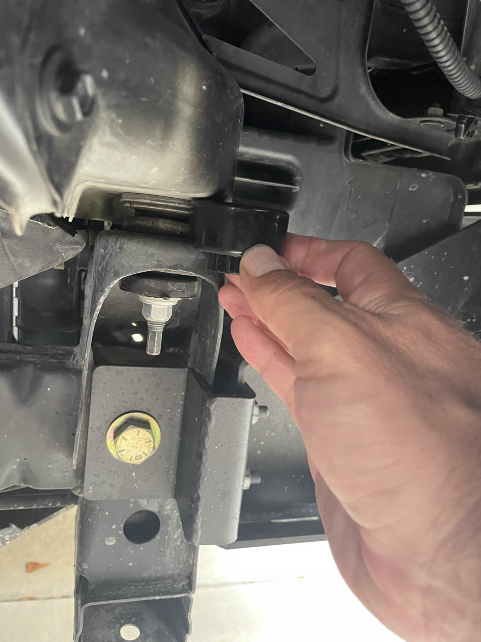

    Sort of stuck on my install.
    My sliders are interfering with my ability to jack up the body from the pinch welds and they are a major pain to remove. Any ideas on an alternate location?

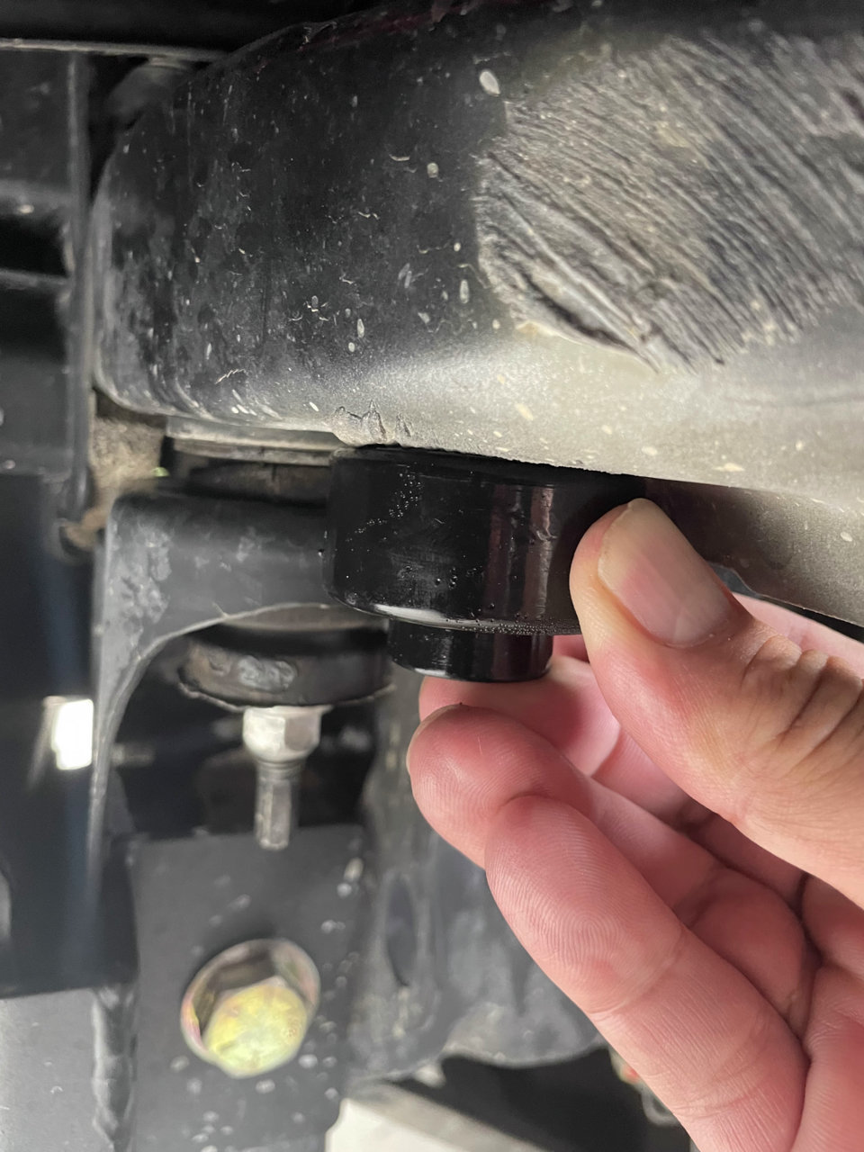

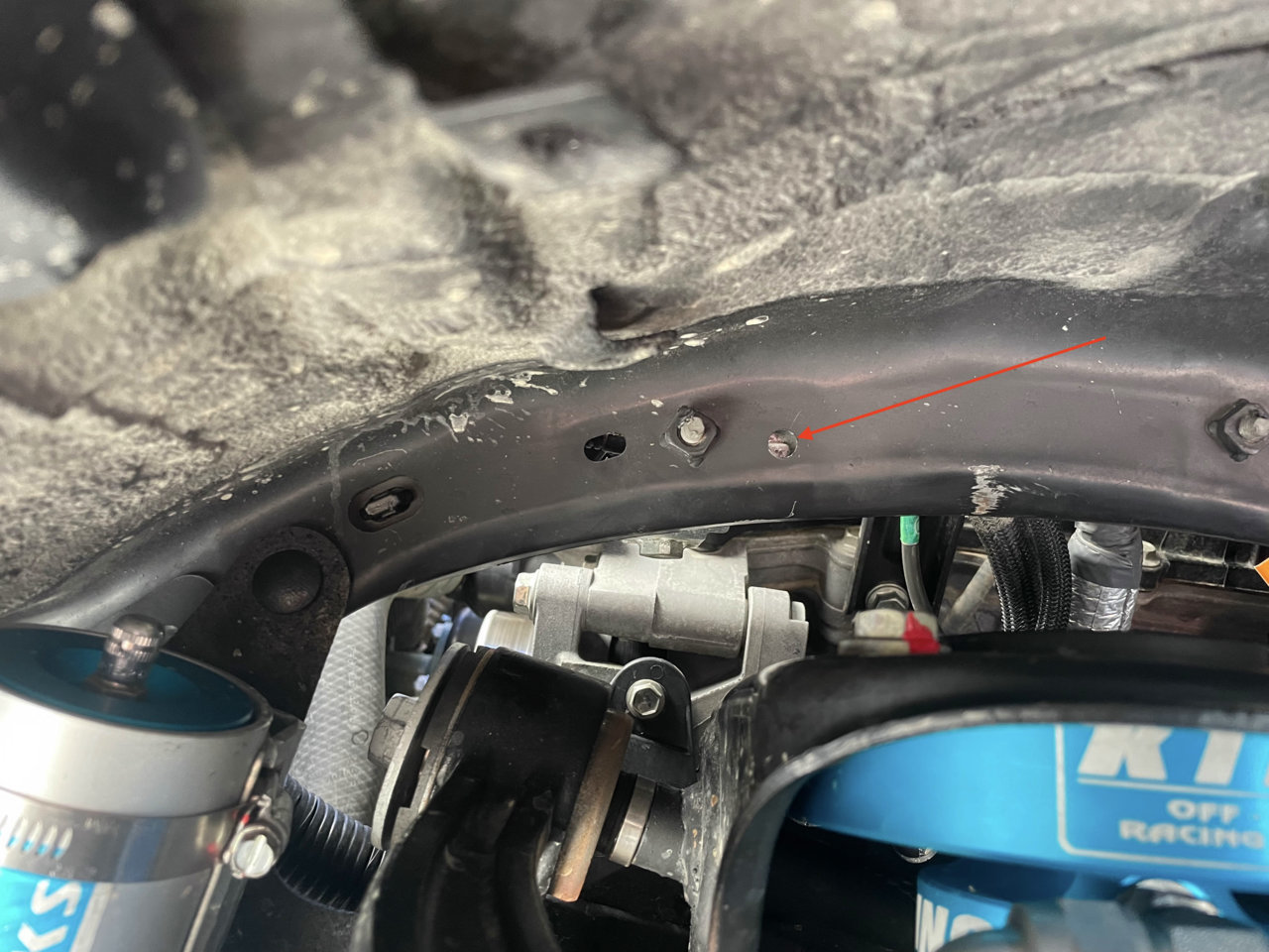

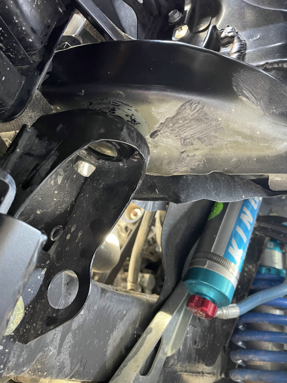

    Also having an issue with the front driver's side. The bolt hole on the mount is not lined up enough for me to assemble everything and get the bolt through

    You'll need to loosen them all a bit and slide the cab into alignment.

    Thanks! They're all loose, just not sure how I'm going to "slide the cab".

    That is half the problem with the stock mounts. They have a ton of slop allowed and make the alignment / partial replacement hard. You can just push on the door sills and the cab will shift around.

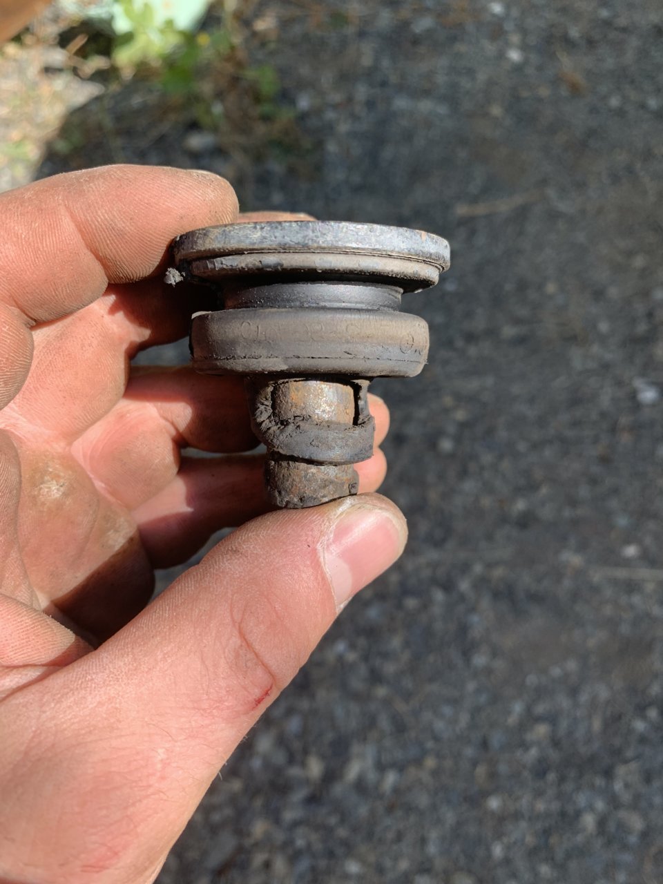

    Job completed last night! Looking forward to taking it for a spin today.
    Both front bushings were toast. I wheel my tacoma fairly regularly and put it through a lot. Not sure if mall crawlers are having the same problem, but the rubber used for the bushings is really low quality. Surprised, but not surprised. Feels good to know everything is rock solid now for a long time to come.
    My takeaways:

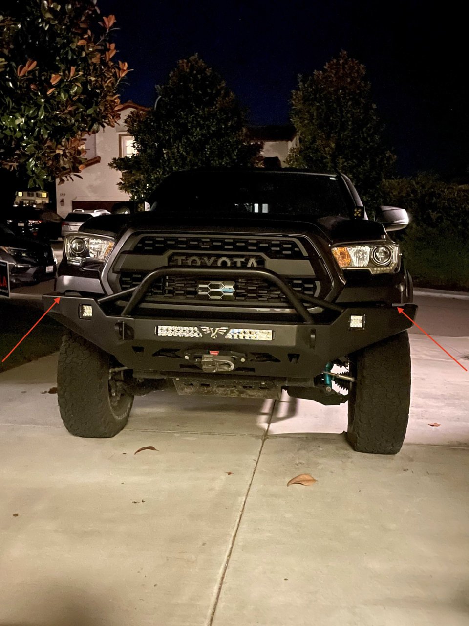

    1) When I had installed my Victory 4x4 bumper long ago, one of the things that bugged me was that although we cut the front perfectly, the drivers side front corner sat super close to the bumper while the passenger side had enough room under it to fit a flat hand under. I never knew exactly why, until I did this job. The front driver side bushing was less smashed down to less than half the height of the Energy replacements, and significantly flatter than the left side.
    Driver side (Energy top bushing in my hand)
    Passenger side
    Photo from back in 2021 when I installed the bumper. Always bothered me that the "bumper was not even" (wasn't the bumper after all, it was the crappy OEM bushings)
    Photo from last night after installing the Energy bushings. Almost completely level with the bumper:

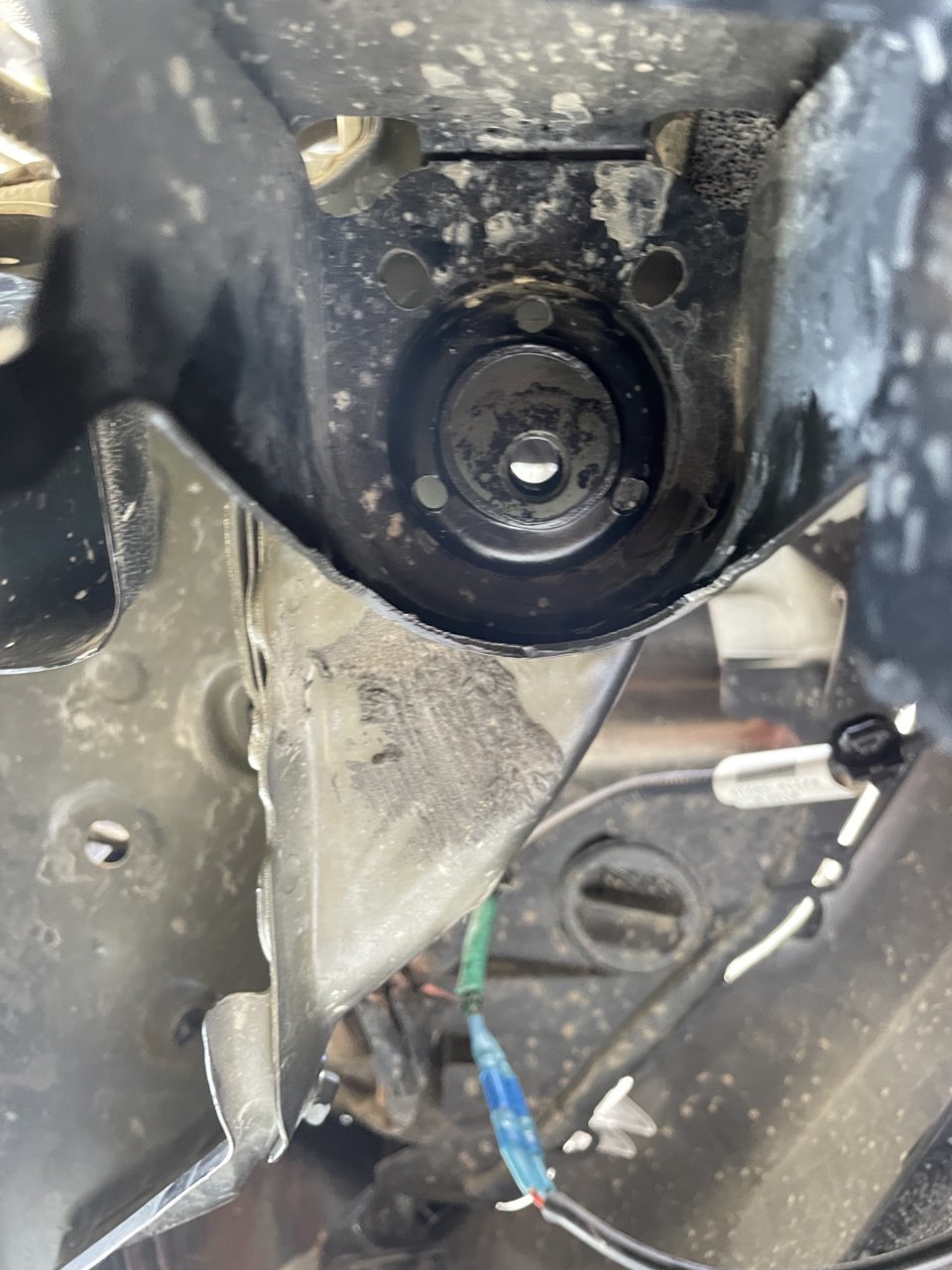

    2) Got stuck when I started out to do just the front ones. The bolt hole for the first one I tried was misaligned and I could not get the bolt through the assembly with the sleeve installed. After advice from you guys, once the body was floating (jack stands holding up pinch welds on both sides) it was easily aligned with a buddy pushing on the cab while I fed the bolt through.
    While I had the body up, I knocked out the entire job instead of just doing the fronts. Was pretty easy and I would recommend doing them all at once.

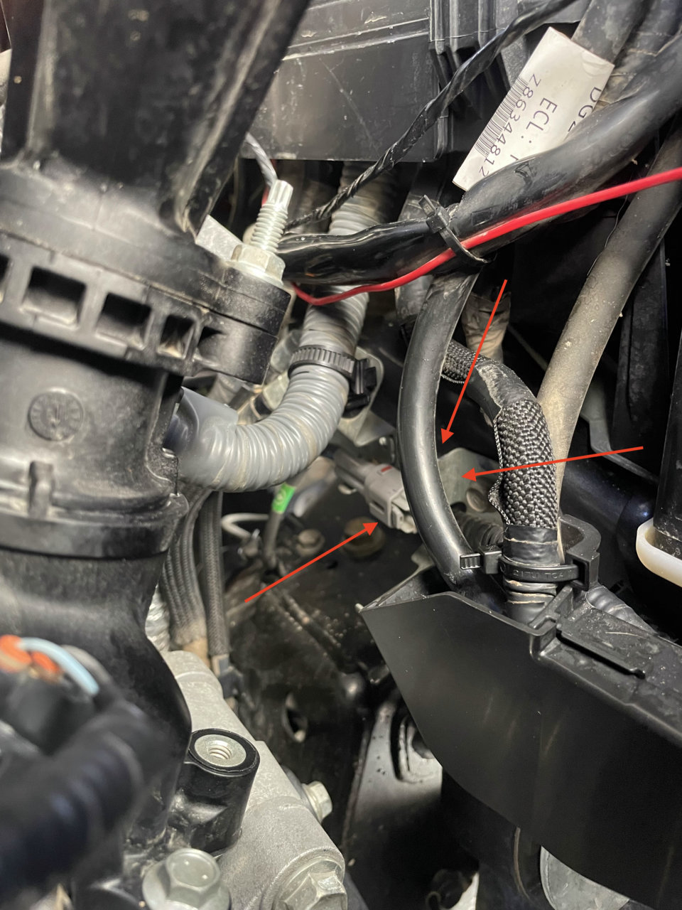

    3) Drivers-side ABS sensor: On the passenger side it was easy to access the back of the mounting plate to squeeze the clips and remove. On the driver side, the mounting plate that the ABS connector is on offers easy access to depress the top clip, but the metal mounting has sections of metal plate that block access to the bottom clip! It also blocks access to the bottom clip from the front, and everything in the engine bay blocks access to the bottom clip from the back as well.
    After beating my head against the wall on this one, I discovered that there is an access hole in the wheel well JUST for depressing the bottom clip. Not sure if this was already discussed somewhere in this thread, but I didn't see it and knowing this would have saved me a bunch of time on this simple part of the job!
    You can actually see the bottom of the clip through the hole in the second image below:
    3) My sliders prevented jacking up from the pinch welds, so I had to use 2 x 4 chunks on the jack, and find a reinforced area under the body about a foot toward the center of the truck to lift , then the jack stands were able to fit between the slider and pinch welds to lower the body onto.
