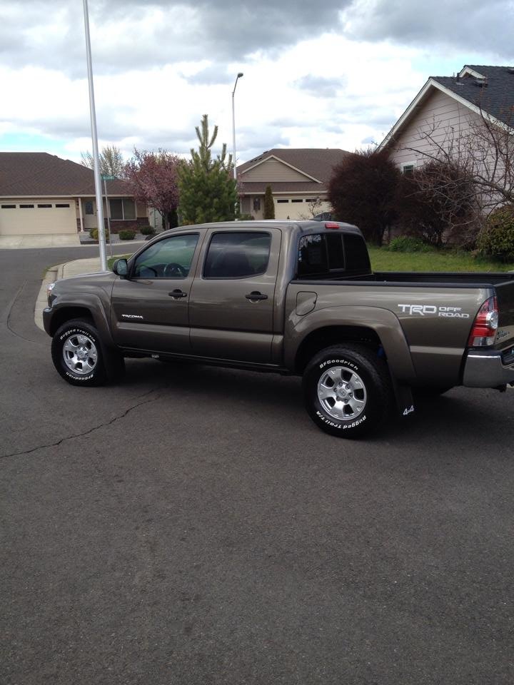

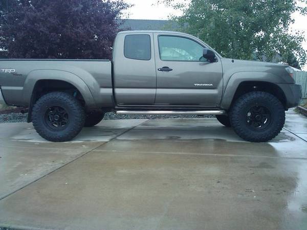

    The day I got her. (3/23/14)
    My previous Tacoma, '09 AC TRD OR 4x4.

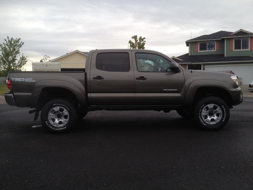

    So I finished installing my lift and Camburg UCA's today with help from a couple buddies. I also chopped my front mud flaps 6 inches. I didn't install the extended rear brake lines due to not having a 10mm flare wrench and not having any clear tubing to bleed the brakes. I'll be installing them at a later date.
    Before the lift:
    After the lift:

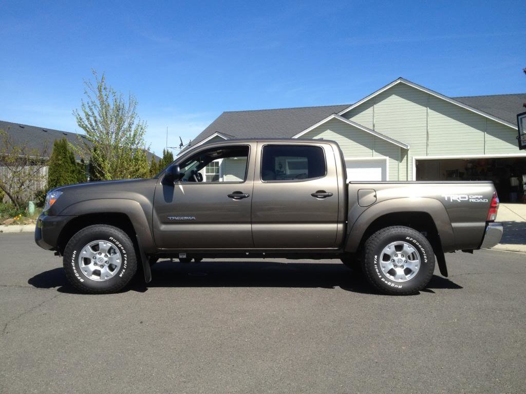

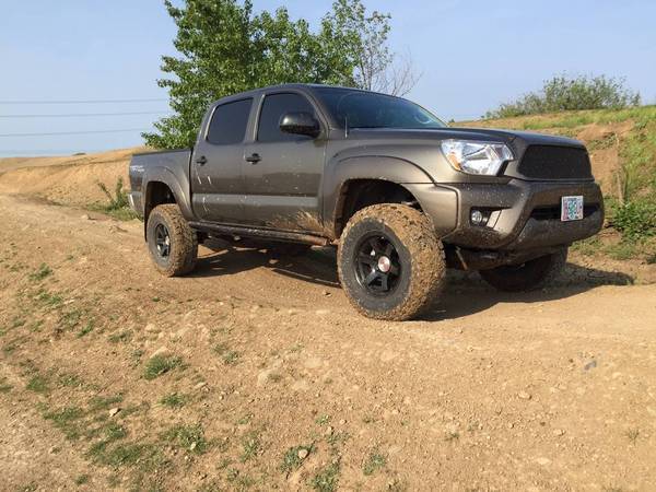

    With the new tires... 265/75/16 Cooper ST MAXX

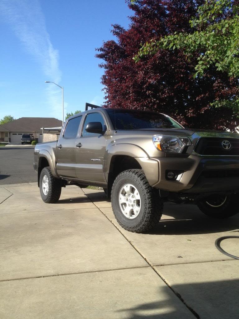

    Got the truck aligned today and got the extended rear brake lines on it too. It drives so nice compared to my '09 with the spacer lift and M/T's.

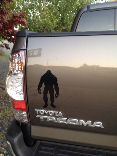

    Squatch sticker mod!
