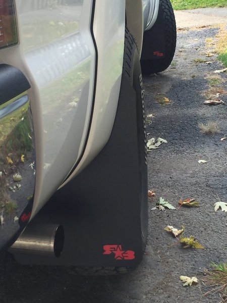

    I can see this with the short length ones. Even with running 265/75's they are too short and the tires will fling stuff right past the flap. When I switch to 255's it will be even worse. Guess I'll be ordering the longer ones in the future

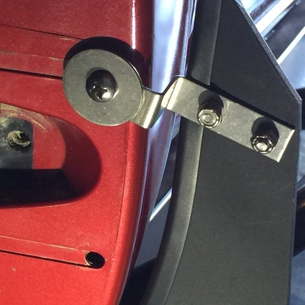

    ^^^^ THIS. I figured out there were three different length screws for the front after I'd put the left one on. Had to remove that one and reinstall. Plus I had two extra of the shorter screw.
    Contrary to the directions, which state you should use two shorter length for the two outer most holes, I recommend using the short (1.25") with the 10mm spacer, the medium (1.5") with the 15mm spacer. That leaves you with the long (1.75") screw for the 20mm spacer on the innermost hole. For ease of access I removed the wheels to install them.

    ^^This. I did exactly what you did. Took me longer to figure out than the actual install, lol!

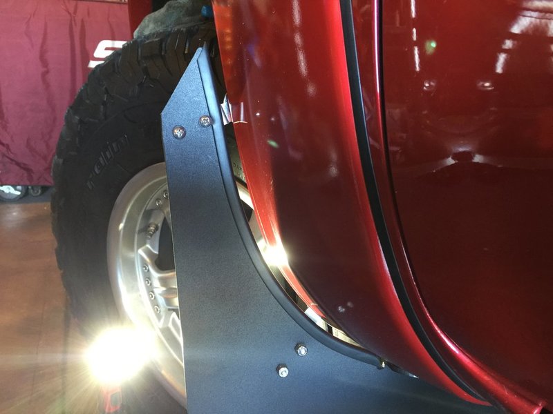

    UM? HUGE gap

    Gap is to wide... Maybe drill a new hole to close the gap.

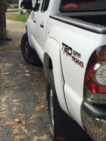

    I did the same with the fronts- I used mid length screws on the outermost holes. I love the way they look! I have less than 3000 miles and those OEM flaps have already started to do a number on the fender flares.image.jpg

    I used electrical tape to mask off the bottom corners so the decals would be the same all around- about 3/4" in and 3/4" up from the bottoms. Easy!
