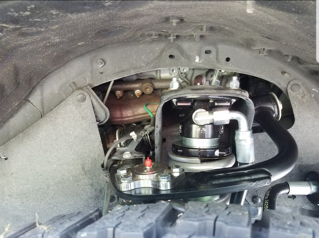

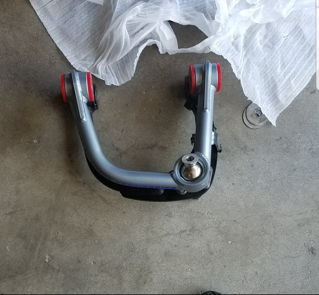

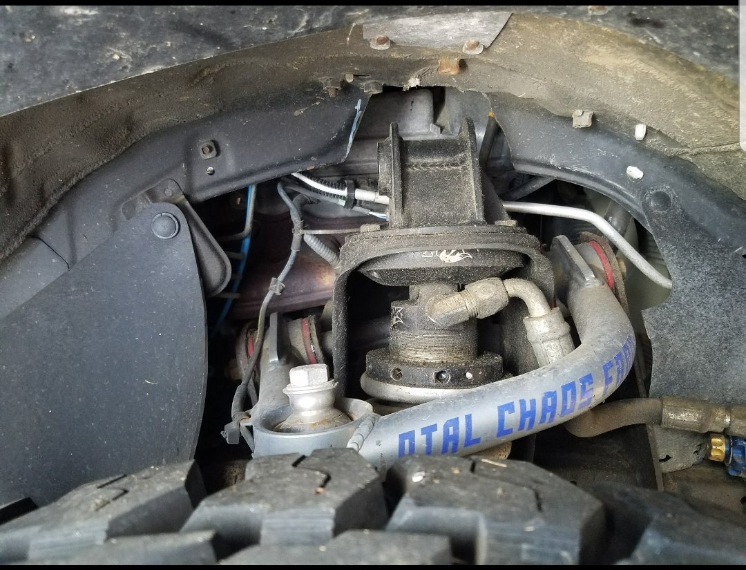

    They look cool but I've never heard of them before. Sorry, no experience with them. The only thing I do question is the the angle of the forward tube right off the uniball. It looks more straight than angled. I went with JBA upper control arms a couple years ago because I liked the idea of a Chevy ball join. The problem with them was the angle of the forward tube. I run 35s and they rubbed hard on them. Ended up buy Total Chaos. All good now. I have some pictures of what I'm talking about. The last picture was the TC uca on top of the JBA. Big difference. Screenshot_20180423-231411_Photos.jpg Screenshot_20180423-231432_Photos.jpg Screenshot_20180423-231515_Photos.jpg

    I see that, I have the same coilover, I don’t have 35s. I don’t want any rubbing.. thanks man
