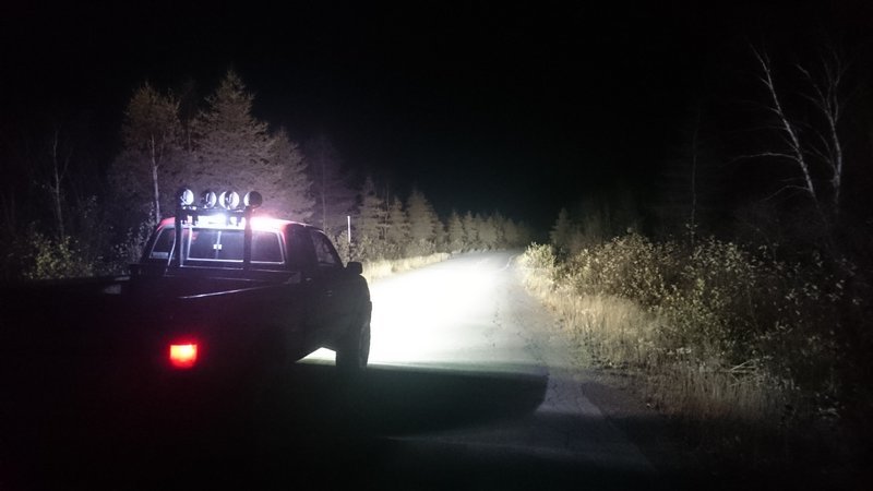

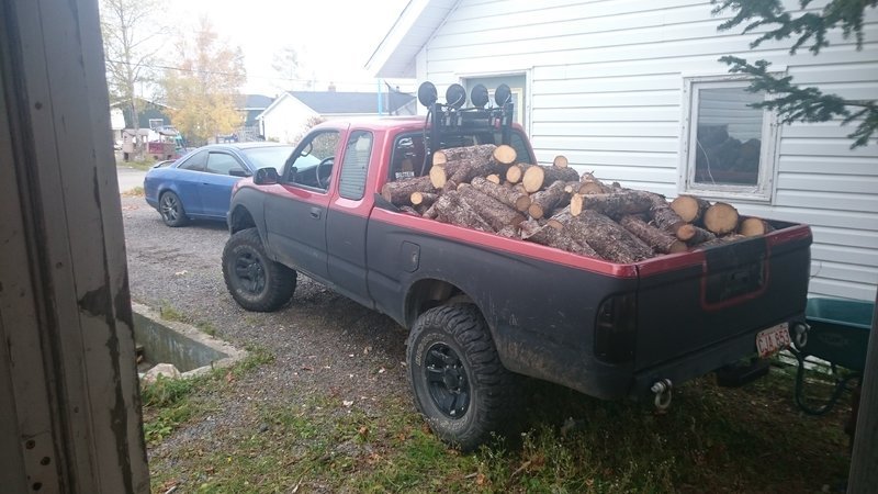

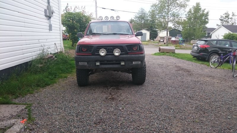

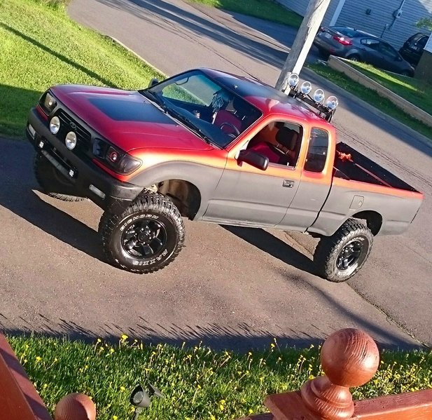

    SImple back rack design will suffice for lights and window protection. i whipped one up in about 3 hours and put some hid converted hella 500s up there.

    5ft wide total. 1ft long and 3.5" tall mounts. upper posts are 16 3/4" in and 21.5" tall. upper crossbar is 19.5" up and 22.5" wide.

    I tried getting pics but...
  19. Nov 11, 2016 at 1:16 PM
    #19
    eon_blue
    Mar 4, 2016
    #180213
    69,944
    Azusa, CA
    Custom fab work is indeed your specialty...
    However photography is not :devil:

    Actually that was the first thing i ever made and first time welding. done with a angle grinder and harbour freight welder. did whole thing with no welding hood and just closed my eyes ahahas. that means theres no excuse that it cant be done.
