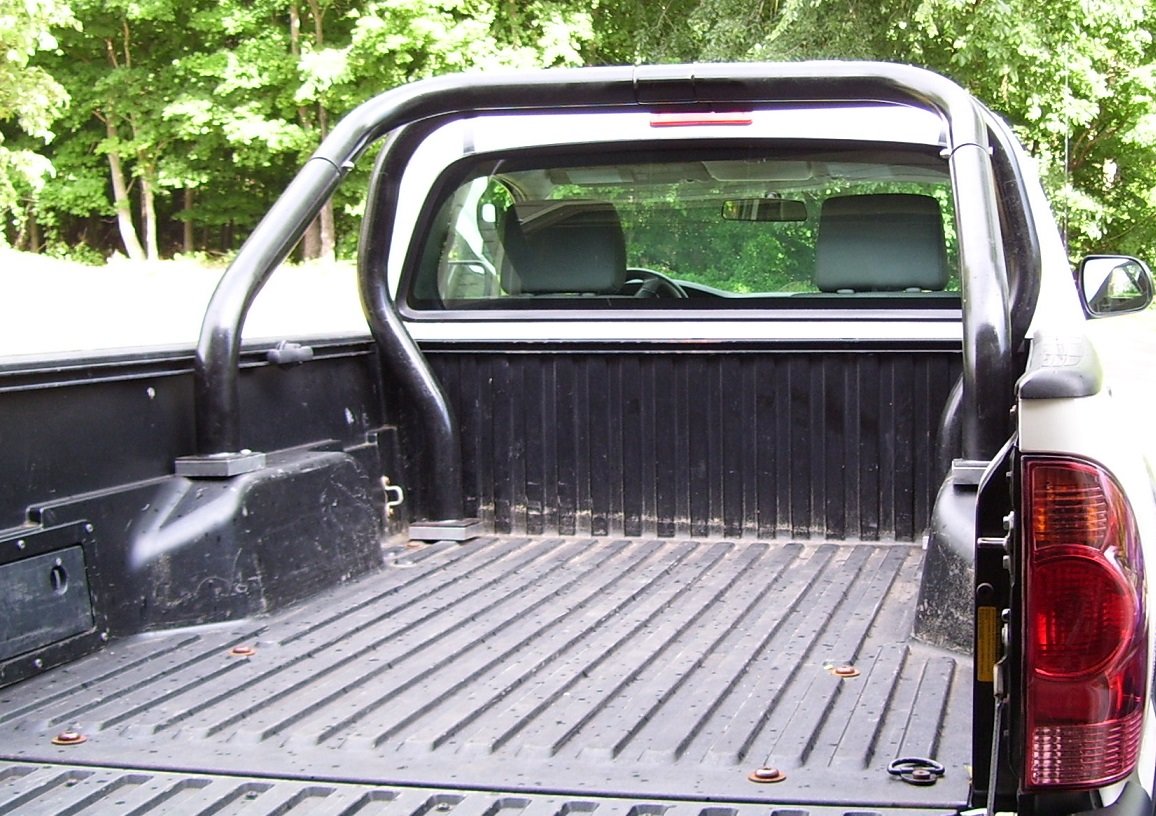

    Looking for Rollbar with side supports.. we want to mount a rope winch to pull our boat up into the bed.

    I don’t know of anything that would suit your needs. It sounds like you’ll want something that ties into the frame, meaning the front two bed mounting bolts. My recommendation, find a local fabricator to build you something specific to your needs. Then it’ll be plenty strong and work exactly as intended. With the right design, you could winch another truck from back there.

    I put a rollbar in my truck but it just bolts into the plastic bed so you would need to find a way to tie it into the frame to make it strong enough to winch in. How wide is the boat, it would need to fit in between the legs going to the wheelwells.
