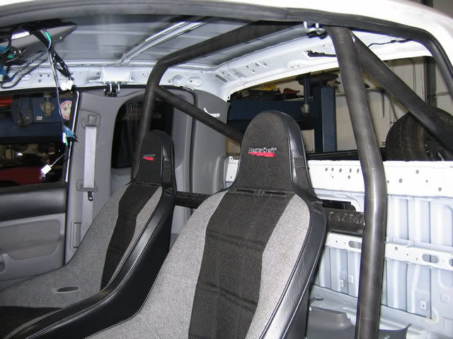

    Alright everybody, brace yourselves. :D This is what's up there without the headliner. Maybe the guy you spoke with was referring to the area above the rear glass?

    Well, you did not just make my day.
    I am going to send this to my dealer.
    There is no point in learning the hard way.
    I was planning a rim fire, a center fire and a shotgun.
    Loaded, this is some weight.
    Any ideas?

    Cage the whole cab. ;)
    You're probably looking at having some square tube welded sideways across the top of the cab. The areas above the door opening are strong enough mounting points for your needs and the square tube will give you something flat to attach your rack to.
    Beyond that it's a matter of appearance and how cleanly it could be made to work with the headliner. Definitely keep us posted when you make a decision. I'd love to see how this comes out!
