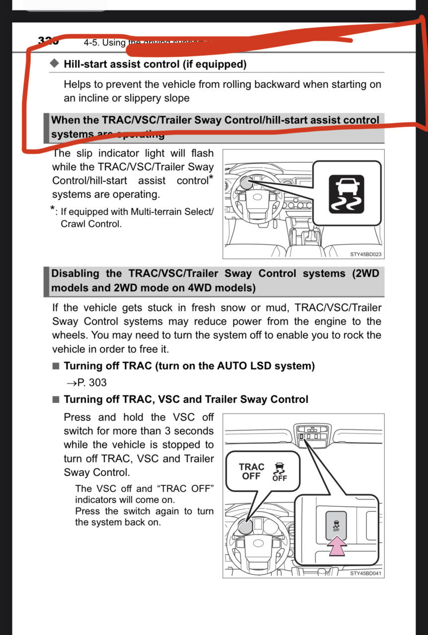

    Only helps you to get started on a hill or incline. To give you a few seconds from taking your foot off the brake and on to the throttle to keep you from rolling back, it takes some getting use to but I agree using the parking brake is a lot easier.IMG_0035.jpg IMG_0034.jpg
