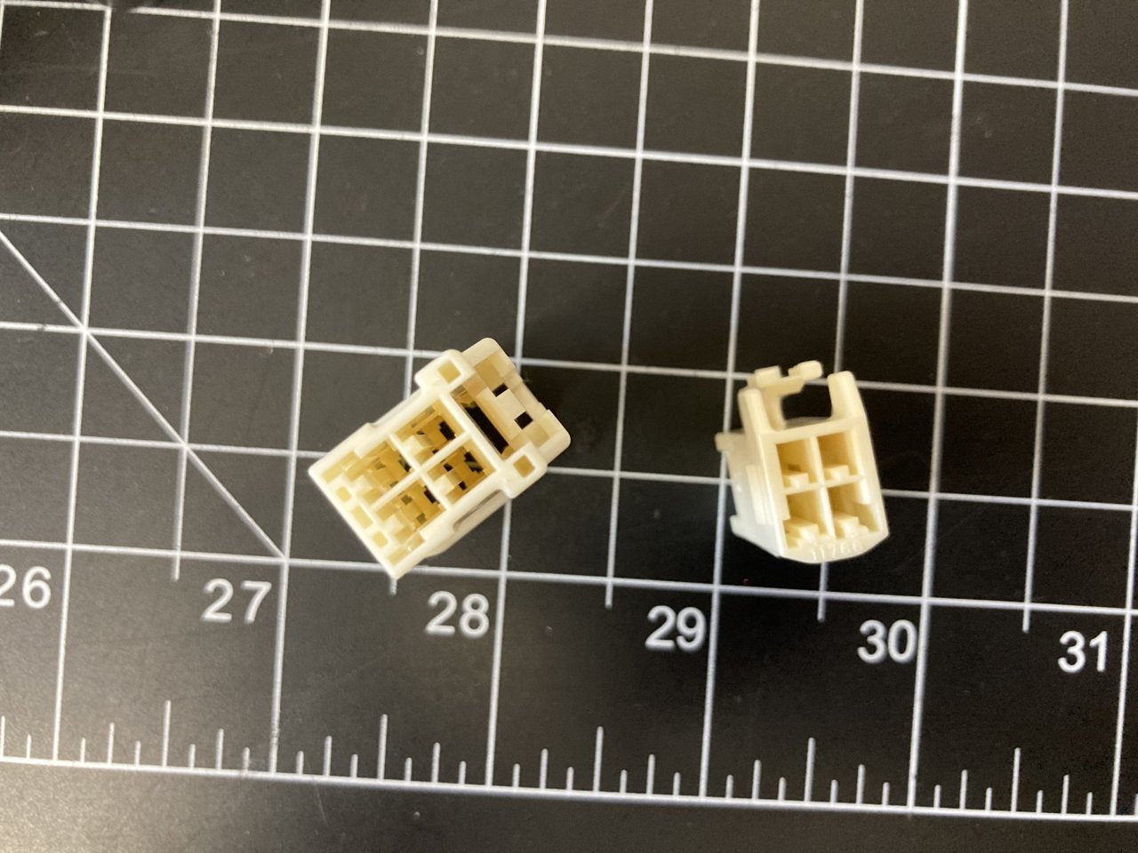

    Corsa has the 6ers as they are super standard and also (I’m hoping) may work for a fog w parking lights stubby harness. The 4’s are a little slimmer I guess but harder to source and would cost more.
    The nice thing about the 6 is you can use the rear speaker pinout as your standard which ensures you never have to remember where anything goes.
    for wire, buying white, white w black stripe, grey and grey w black stripe for a short section gets annoying. Because 4R can do short but only does striped in GXL, not in TXL while prowire I think has a 100 fit minimum though they have good prices. So you could just use whatever color you want if you hold to a pinout standard.

    These are the 4’s I have. I believe they are sumitomo from hi-1000

    Oooh that would work perfect. All I’m going to do is run the right and left channels into it. Color coded like factory. Wrap the connector in foam and lay it under the center console. Then when I add the amp I can remove the jumper harness and directly wire the amp to this plug.
