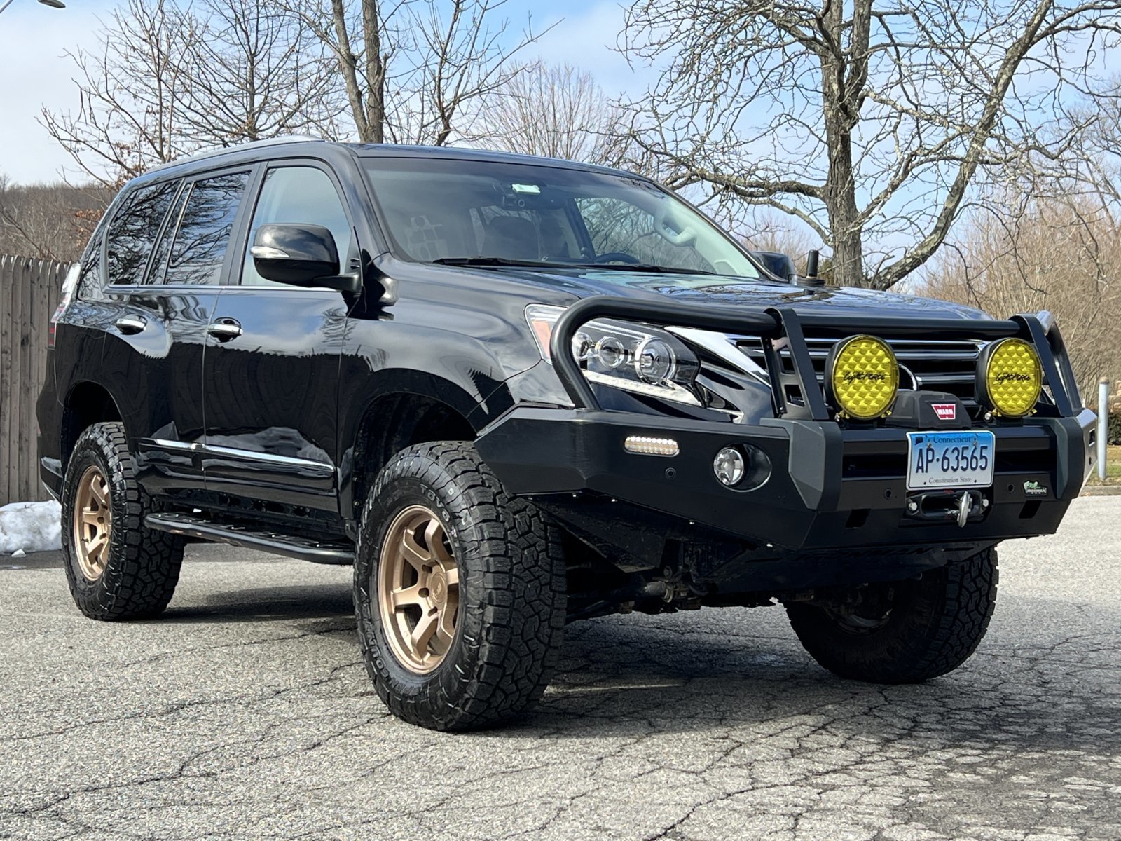

    Updates!
    A few months back BFGoodrich sent me a set of 34x10.5R17 KO2s to test. I've been running Toyo Open Country A/T IIIs in 285/70/17 for the last 2 years, and the two tires are direct competitors. As I posted in the skinny tires thread, the E-rated Toyos weigh in at a reported 55# with the new D-load rating BFGs being 54# each. I'm also testing a set of American Racing AR172 Bajas courtesy of Real Truck. The 17x8" size makes more sense for the narrower Toyos than does the 17x8.5" Motegis that were mounted on the Toyos. The new Bajas weigh 25.31# to the Motegis at 24.54# each, so the overall wheel/tire setup went from 79.54 lbs/corner to 79.31 lbs/corner-- a negligible difference.
    Yes, you can fit 5 tires and 5 boxed wheels in the GX460:
    The goal in swapping out the Toyos for the BFGs was to get a little more height and a little less rolling resistance. Dimensions come into play here: he BFGs are quoted at 33.5" tall by 10.5" wide, and the Toyos are reportedly 32.8" tall x 11.5" wide. It's not a huge difference, but it's noticeable when the two are placed next to each other:
    I enjoyed the Toyo/Motegi setup but might like the BFG/American Racing setup even more. It's a much more classic look. I dig it. Here's a few comparison pictures of the GX before/after:
    I've wanted to try the KO2s for a while now and am especially curious how this size fares in comparison to the common 285/70/17s. Initial impressions are strong after about 400 miles. Here are some thoughts:
    • Less rolling resistance with the narrower KO2s (and coasting is subsequently easier)
    • The GX is maybe 5% less excited to drop down a gear on long highway climbs, but more time and testing is needed to verify this
    • Equally quiet around town
    • KO2s are new and subsequently slightly quieter at highway speed, though they do have slightly more vibration at highway speed
    • Ride quality of the BFGs is better, thanks to slightly more sidewall and lighter load rating
    • BFGs have worse wheel lip protection; outside of the bead is more subject to rock rash
    • Off-road is hard to compare apples-to-apples, but the KO2s seem to be a little happier on dry rocks (again likely thanks to the greater ability for the tire to deflect/flex), water/mud performance is a wash, jury is out on wet/loose climbs, and KO2s are a bit better to run trails with as they are a little more direct but are also slightly more "floaty" (for lack of a better word)

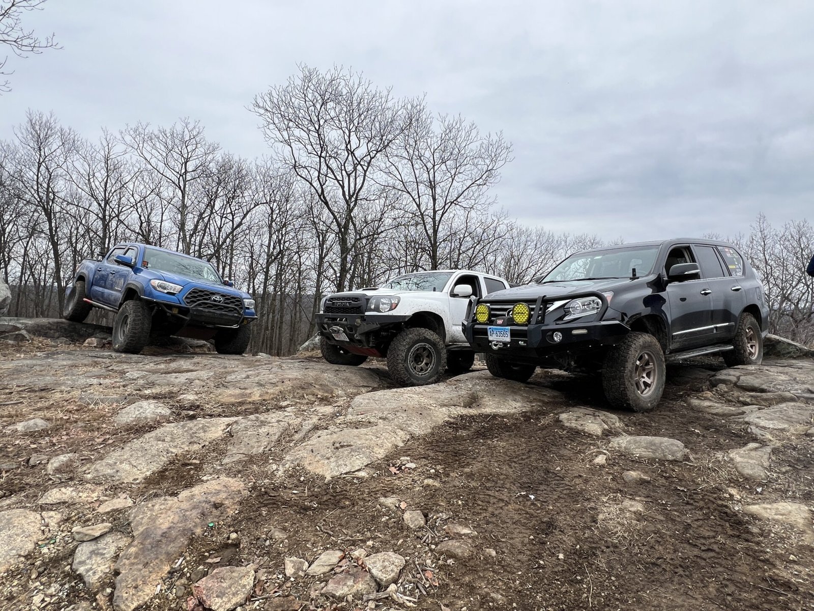

    Speaking of off-road, part of those 400 miles were wheeling with some of the Northeast TW guys who are great to wheel with and great friends, too. The KO2s did very well on our little adventure. No grip issues whatsoever, and while it wasn't a particularly taxing or difficult day of wheeling, I am still pleased with the performance thus far. Gratuitous pictures from this past Sunday, some courtesy of the guys I was with:
    Quick closing report on the Toyo Open Country A/T IIIs after 2 years and ~8k miles: These are truly fantastic tires. Quiet, comfortable, confident in every single weather condition, and so on. Between my dad, my brother, and myself, we have put probably a half million miles on the A/T 2s, and the A/T IIIs are even better. They were fantastic on my GX, handled everything I threw at them, and held up incredibly. Given, I didn't put much mileage on them, but I drove them in every condition: Dry, rain, ice, sleet, snow, mud, rocks, sand, dirt, and so on. They never broke a sweat. Great, great tires, and I wouldn't hesitate to recommend them to anyone who is even considering them.
