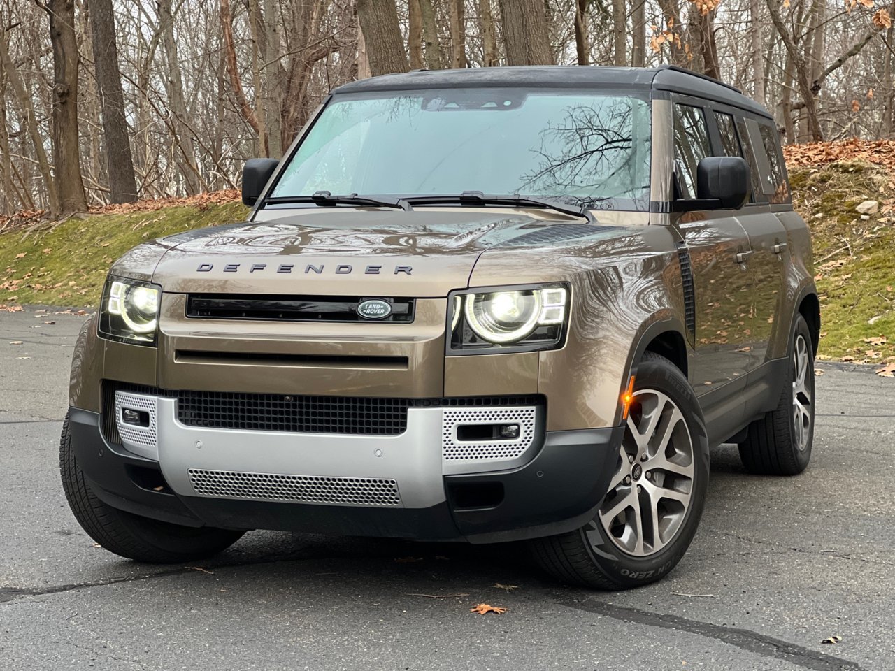

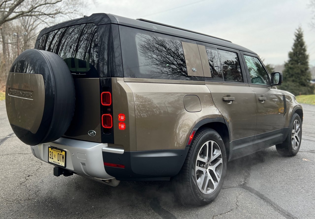

    I think we need more details on that Defender in the background :D

    The Land Rover in the background is a 2023 Defender 130 SE, a press vehicle I was loaned for a week for review purposes. Not particularly pretty, but it drives just like the 110, which is a good thing. I like these a lot, and if I won the lottery a V8 110 would be in my driveway (parked next to a 200 Series Heritage Edition, of course).

    That defender is the most trail limo looking thing I've seen to date hahaha.

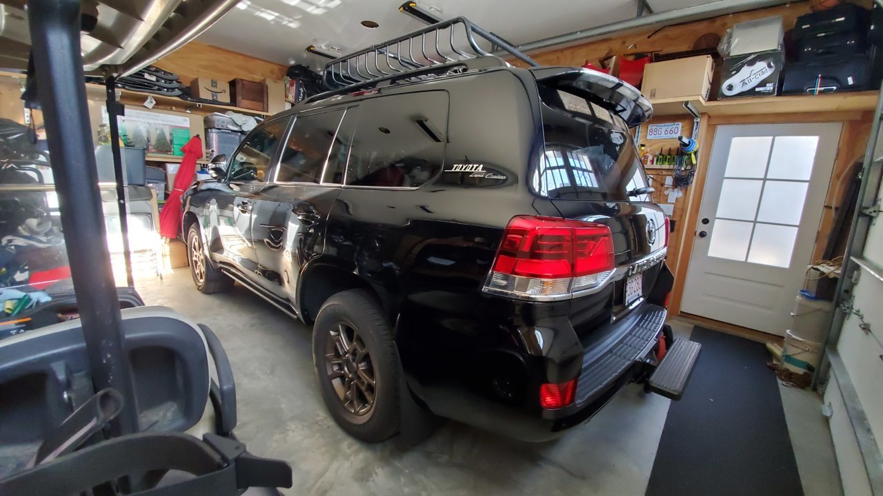

    Oh and speaking of Heritage series 200s...

    Oh yeah, short of a *real* fullsize rig like the Suburban that my podcast co-host adventures with, the 130 has a lot of length and not particularly in the right place haha
    Whose 200 HE??

    Client of ours, ill tell you more about him in person one of these days...but he's got one of these, a unimog, a heavily modified Tahoe he did a cannonball run in, an lfa, a rally'd out s4 avant... and I'm definitely forgetting a huge chunk of this list lol

    Holy hell, that's a fleet... LFA??? Man, the Heritage Edition is a special thing, but that V10 makes the best sound any engine has ever made. There's a chance I know who this person is based on a couple of their vehicles, we'll discuss at the next meetup or wheeling trip

    LC HE… hmm, cool car, will be a classic.
