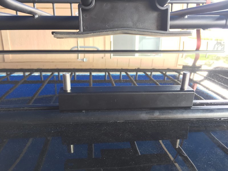

    I Wanted to share a MOD I did for the poor man and its pretty easy. Mounted a Yakima Megawarrior Basket with he extension on a shell with Yakima racks and no crossbars. Got this idea form fourfa on Expedition Portal. So much props for him for showing me this. Just wanted to share some pics and some info.
    I used 60' Yakima Rails for the shell.
    https://www.amazon.com/Yakima-Control-Tower-Tracks-60-Inch/dp/B0012SC1OM/ref=sr_1_sc_1?s=automotive&ie=UTF8&qid=1495836786&sr=1-1-spell&keywords=yakima+ctracks&th=1&psc=1
    I added a third set of brackets like fourfa said to do got them off Amazon.
    https://www.amazon.com/gp/product/B001T89MUQ/ref=oh_aui_detailpage_o00_s00?ie=UTF8&psc=1

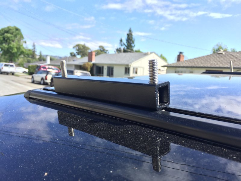

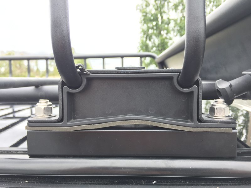

    Measuring is pretty Important. Measure the basket before installing rails. I used Carriage Bolt 3/8" X 2 Stainless Steel Bolts and hardware for the brackets. I drilled them out to 3/8 because they are smaller and wanted to beef them up. Might have to wiggle them down the track. They are all not alike so some slide right in and some you have to move along the track with a flat head and rubber mallet.
    I Build some 1/2" Brackets out of square aluminum and painted them black. Lifts it up just a little bit more for weight in the basket and sagging. I drilled the top hole 3/8 and the bottom hole of the aluminum bracket a little bigger so a small part of the base of the carriage bolt sits inside of it.
    Going to work on some security bolts son.
    Let me Know if you have any questions

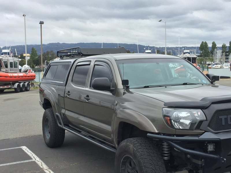

    Got a better pic!
