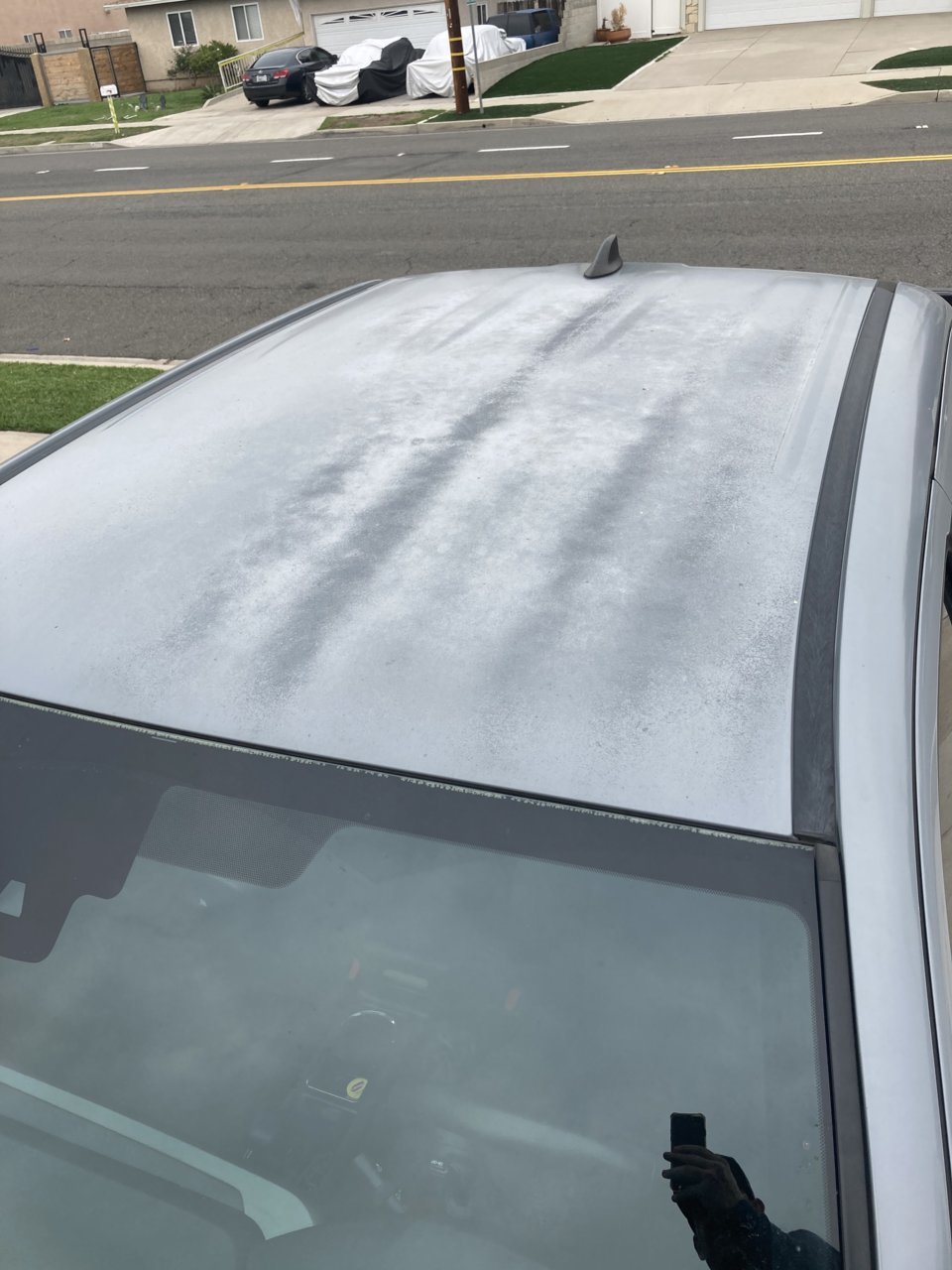

    Hi all. I have a 2018 grey concrete Tacoma and I just noticed the roof clear coat has completely deteriorated and the paint is completely dry, cracked and ruined. It’s been a couple months since I’ve washed it so who knows when this started. The rest of the paint on the body is fine. I’ve never used any weird chemicals. I took it to the dealer and they were stumped too. It has 44k miles so the paint is beyond warranty but the service manager took pics and is contacting Toyota to get it resolved no cost. Has anyone else heard of this so I can have some input in case they deny my claim? Thanks!

    :eek: Wow...not seen anything close to that level of deterioration on something as new as an '18. Good luck

    Seen some issues for other color (mainly white) but that was more chipping / flaking. Haven't seen too much for cement

    Holy crap! If you hadn't posted the year I would've said the truck is much older. I don't have any input, but wow. Did you purchase the truck used or new?

    Damn, looks like concrete!

    They probably skipped the sealant step when it was prepped by the dealer. They come with a big tube of product that is to be applied to the paint by the dealer.

    There is another thread on here with the same issue. They had a blue one though I think.
    But toyota told them to pound sand.
    You have a few options, you can take it to a body shop and have it sanded and new clear applied (if the color is ok) or you can put a vinyl wrap on the roof to protect it whats left.

    Wow, this disinformation in this thread. Wax or sealant is not going to prevent clearcoat failure. At most it will slightly delay it.

    I test drove a MGM 2018 Sport DCLB right before I bought my new Taco on July 31. I was generally pretty pleased with the condition but just happened to stand on the door sill to look at the top and was met with an identical situation. The paint was absolutely fried. That caused me to further scrutinize the entire finish to find the hood had been repainted. By whom I don't know but I drove it back to the dealer and beat feet.
    Toyota has to know about this.

    No, that would not work. The clear coat has physically failed. Respray is the only fix here.

    Thanks so much for the replies everyone, especially the reply with the link to the other thread with the same issue. The dealer initially told him to kick rocks but eventually Toyota agreed to fix it. That’s great precedence for me. Again, thank you!

    So sorry OP! No wax would have prevented that. Hope Toyota can resolve this for you!
