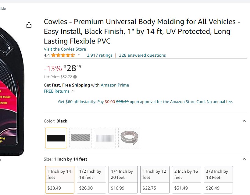

    Old thread but do you remember which width you purchased? 1 inch?
    My truck is in the shop right now and I need to order these

    1” looks like according to my order
