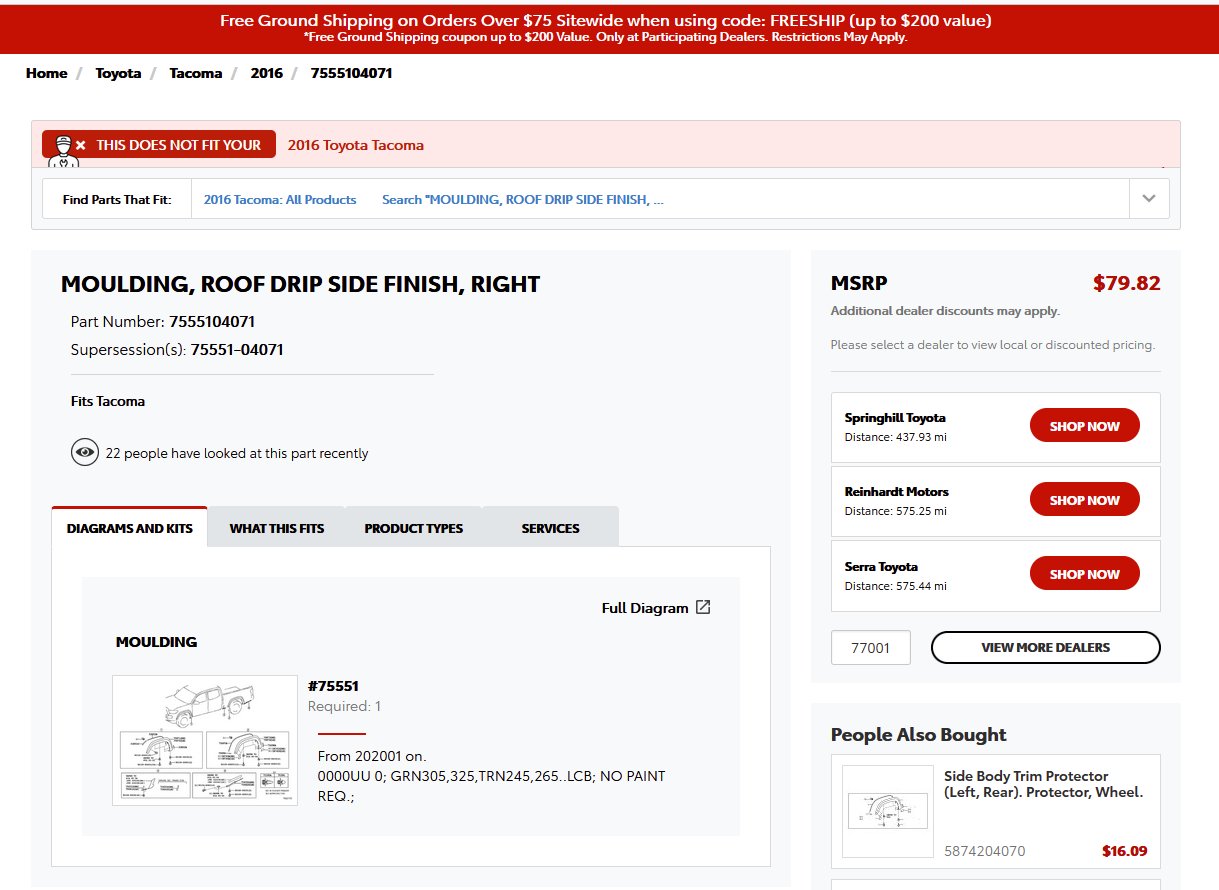

    I installed a roof top light bar bracket that mounts onto the roof top holes and in order for the bracket to fit, I had to cut some of the moldings.
    After putting it on the vehicle, it has become more of a hassle, so I need to purchase a new set of roof drip moldings for both the right and left side of the vehicle.
    I need to purchase them soon, because I worry about the rain and the holes being compromised up top as there isn't a really good seal at the moment.
    I'm having trouble finding the part number for both the right and left side and place to buy it. Can anyone lead me into the right direction?
    https://parts.toyota.com/p/toyota_2...-SIDE-FINISH---RIGHT/94382704/7555104071.html
    I thought this was it but it says it doesn't fit.

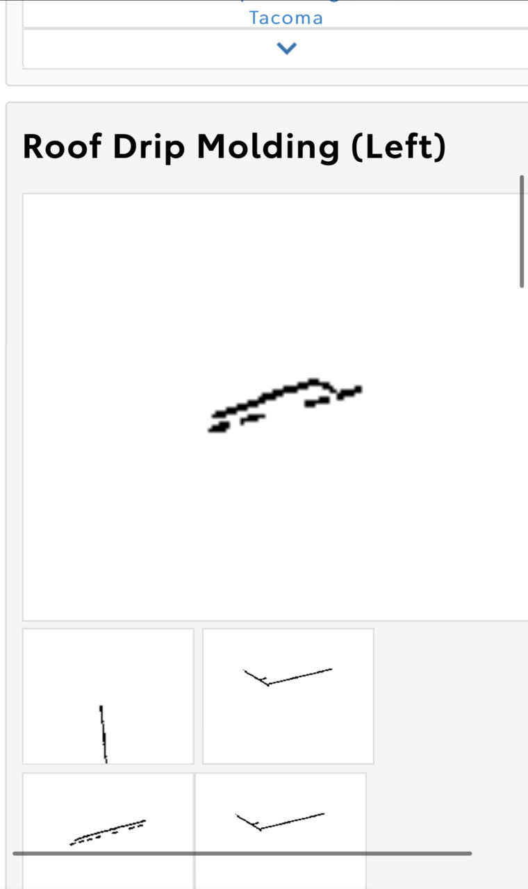

    Does anyone have an answer for this? Need to replace my roof strips after removing my Prinsu. No other options have worked well enough to stay put so I’m going to buy OEM stuff.
    I called my local Toyota dealership to order the strips and talked to several different people in the parts department who were extremely confused and at least one of them was so high he couldn’t comprehend what I was asking.
    The website simply shows a picture of something that may have been done on an etch a sketch so I can’t tell if it’s the right part. 361E93C7-5495-46A4-A826-1F1B7B7513AD.jpg

    I still haven’t been able to find an answer but maybe this will help someone out in the future. I gave these a try:
    https://www.automotiveauthorityllc....toyota-tacoma-black-roof-top-trim-molding-kit
    Very good product but you will need your own adhesive. It comes lined with 3M strips but they don’t work at all because the molding comes curled up in a bag so the strips just curl up as soon as you try to attach them to the roof.
    I used silicon and some dumbbells (yeah, really) to attach them and keep them weighted down until the adhesive dried.

    Is your Taco an Access Cab or Double Cab?

    I have a double cab.

    You need a 75551-04081 and 75552-04081. The oes you got are for an Access Cab.

    Awesome thank you! If these come off the truck or fail I’ll use those part numbers.
