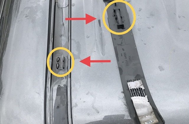

    My 2018 drivers side just came off durring the dry cycle of a touchless car wash. I was lucky it was still on the ground when I rushed back. The car wash is going to replace it for me because it did get scuffed in a few spots. I will be adding some 3m tape or etc in the middle. It's a piss poor design with no clips in the middle of 3m along the whole length.

    There are pinch clips on the front and rear of the body to grab a center ridge on the strip. If you take a set of pliers, channel-locks, or vise-grips and minimally squeeze the front one, it should resolve the issue. The clips pinch that ridge to hold in place.
