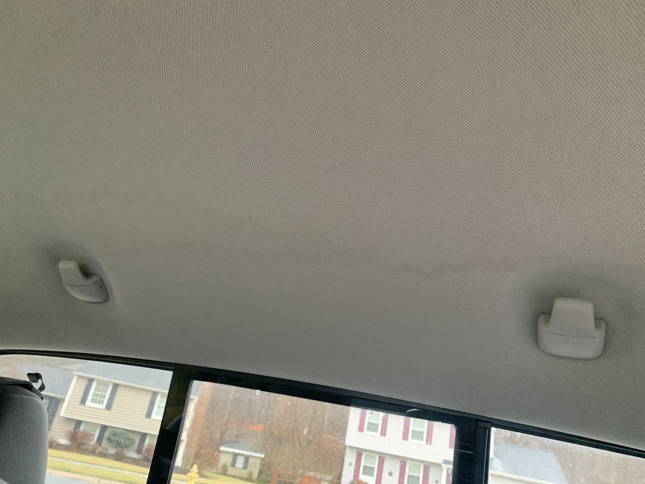

    Just noticed my 2016 sr5 double cab has a leak apparently. Does not feel wet but when putting baby in the back seat I noticed the stain. Seeing the fall pattern is from window to window any thoughts?
    I was thinking the shark fin antenna might be letting water in? I don’t have a roof rack but those seals up top might be leaking?

    Oh wow thanks for the info. I wonder if they will replace the ceiling fabric since it’s all stained up now.

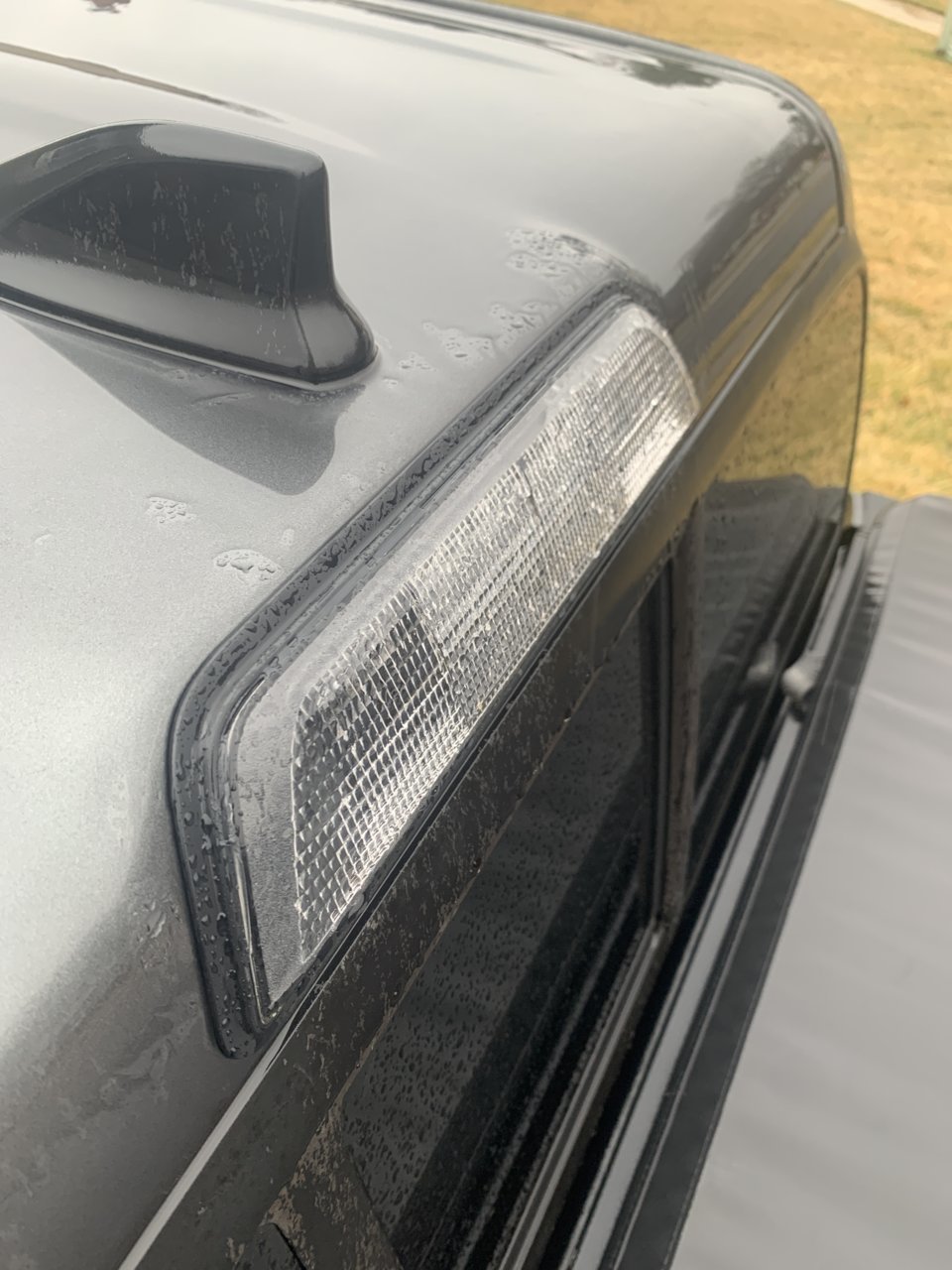

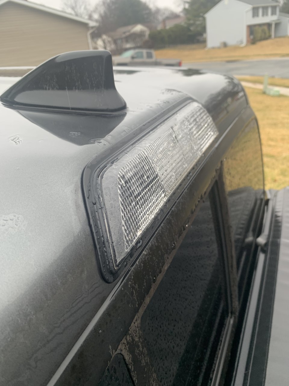

    Can you snag a picture of your 3rd brake light? We can tell you whether they truly did or not based off looks; but sounds like they did, and created a problem in the process unfortunately. Just contact your dealer back as soon as you can.

    Yup that’s what mine looks like. Sorry op

    My truck had no leaks prior to having the Service Campaign done, if there are no leaks they just glue a Trim Ring around the old light.

    Here is what it looks like after they glued the trim ring on. If they have to replace the light it will be a big job as they have to drop the headliner.
