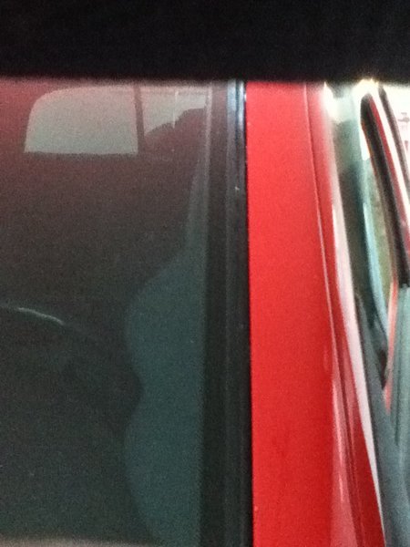

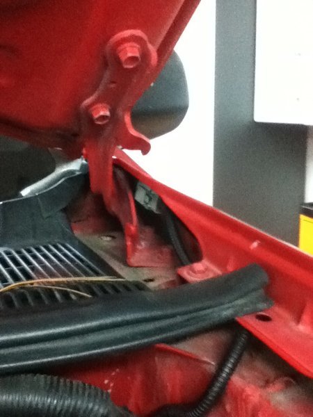

    I ended up using black windshield sealant. Put it in the channel then pressed the cable into it. Painters tape to hold it in place for a day while it set. Weather proof connector behind the hinge.

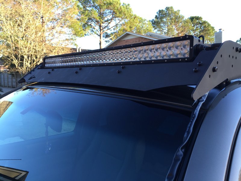

    Same here as some of the other guys, I surface mounted the wire to the windshield trim on the drivers side. No holes drilled! I used 3M automotive double stick tape to hold the wire down. It's been on for over a year without issue. (Tree branch hits and car washes included) the jacket on my harness wa a little lose and kinked when I first installed it. It straightened out and relaxed after a few hot sunny days.
